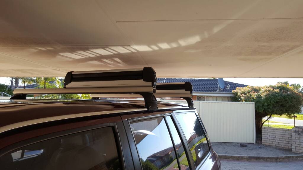

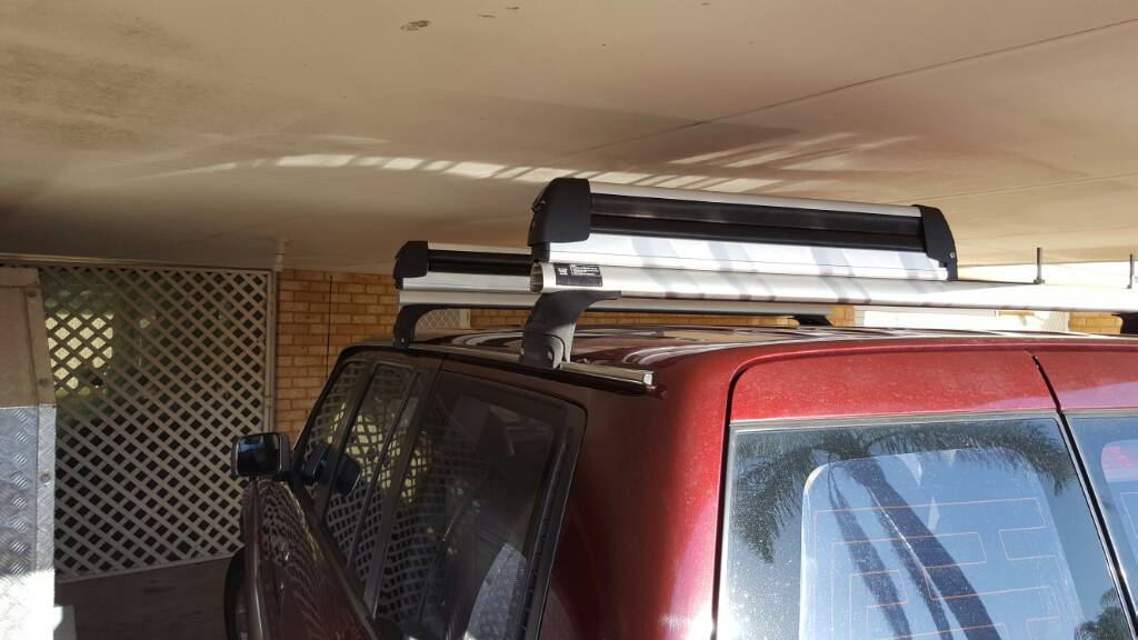

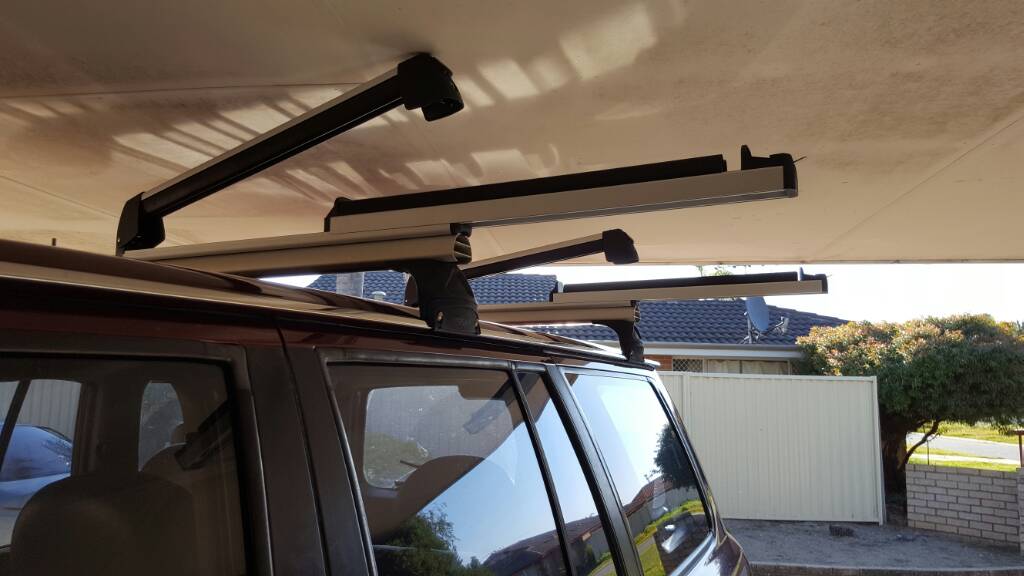

Got my new rod holders today. Fitted them up in about 20 mins all up to the factory roof bars.
Cost $99 off eBay which I thought was a real bargain.
I wanted something that could take around 6 rods when I go fishing with the kids and my Dad.
They slide out to help loading them up and lock back in place. Then key lockable if you have to do any stops along the way.
They are made pretty well and all the mounting hardware come with it for pretty much any bar you may have too.
