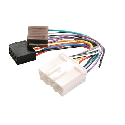

Justin, the harness looks pretty close from memory to the Aerpro harness I used. The antenna port is completely different though as I had to use again an Aerpro converter plug to convert from a Nissan 2 pin to a standard universal fitting in order to plug in the antenna

Lol, I forgot to mention too. To get better radio reception I have to touch the screen or plastic frame of the unit whilst I'm driving. Not bad if I'm in 5th gear but rather annoying. I think I will be pulling it out soon and seeing if I can make it any better myself.
Does your rig have the areal in the rear window??
Alot of the after market areal adaptors that go from the nissan 2 pin plug only use 1 pin. I got and after market adaptor that had used both pins but had 2 wires and i spliced them to 1, not hard just fiddly and my radio reception is pretty good and only get crackle when i turn my HID head lights on which is standard coz of the frequency the ballast emits!

This is the best pic i have, had to zoom in on it from another pic
Attachment 27328
I got that adaptor from autobahn
