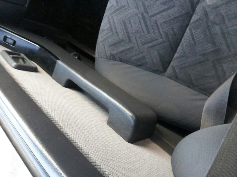

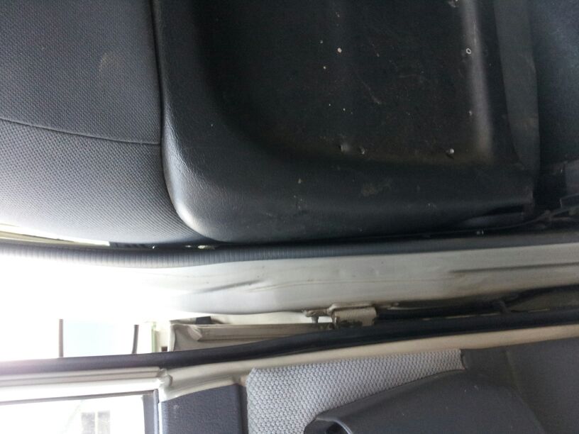

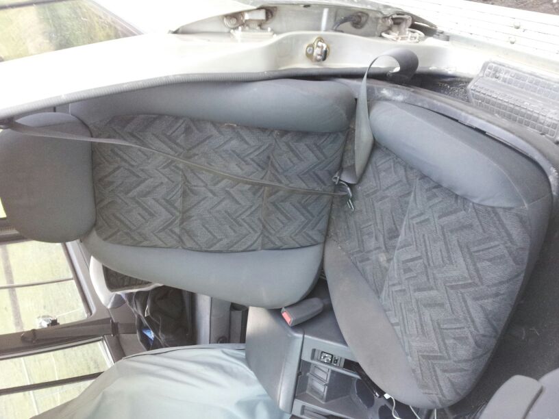

Put them in, then took them out. Bloke didn't realise that the whole drivers seat rails had snapped and collapsed. So got them for $20! Welded plates in to fix the rails and was ready to bolt in. Bolted the passenger side in first to test fit. No good! Sits far too close to the door. Seat belts don't retract and it's very uncomfortable, door pushes hard against your leg.

So patrol seats are back in and the commy seats are going in the Daihatsu

I made some brackets that go inbetween the rails and the seats and moved them over about 40 mm so much better. I.ll try and get a pic tomorrow and post up.
