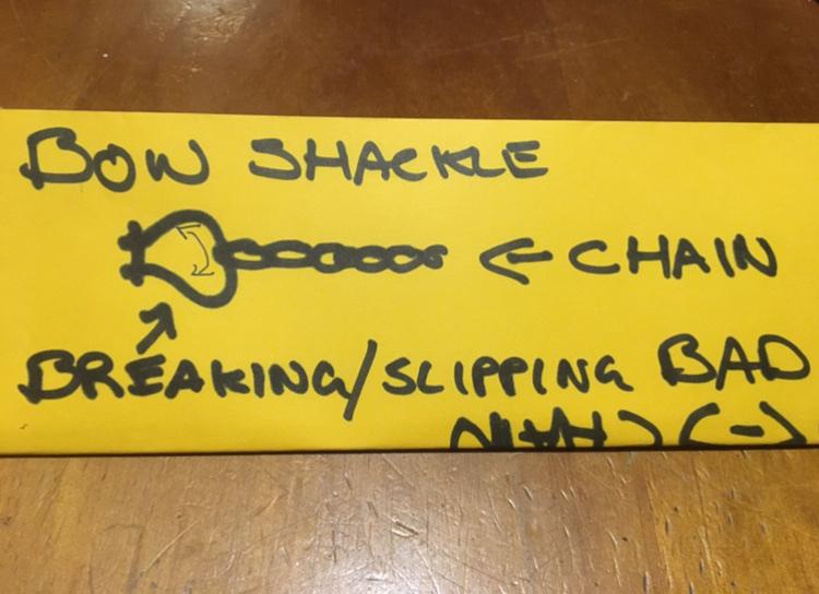

In regards ‘Shackles’ BZ Mate, the best I can nuffy describe it late here is that ‘chain’ looks like two letter ‘C’s conjoined to make an elongated flat edge oval.

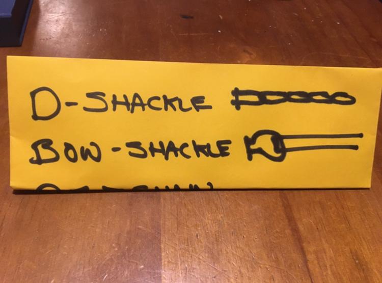

The best way to join chain is to Mimic it with a D shackle.
Bow Shackles I believe were designed for connections requiring wider/round sling/strap type rigging connections.
ET (Evil Twins [emoji120][emoji120] ) Safety Advice:
I have learnt the hard way with little trailer machines breaking ‘bow shackle’ chain connection points due to incorrect pressure alignment.
