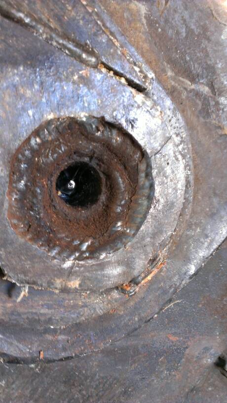

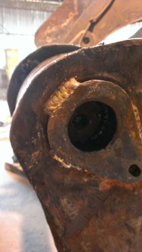

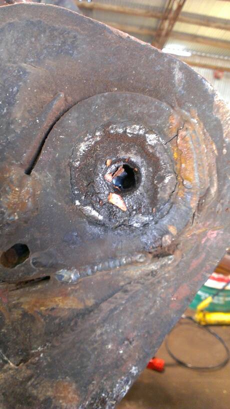

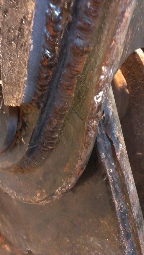

Ring ring, we've found some cracks.. won't take long... :rolleyes:
Righto...

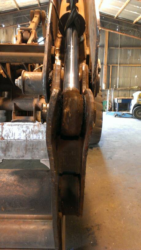

Did this machine tried to lift off something extra heavy or just results of metal fatigue?
Its a grab at a timber mill, so mix of way overloading the grab, rough as guts operators, and crap ground conditions.. ow and neglect...
Turns out the main pivot pin has completely split threw the the bottom, so I packed up and left at 6.. will be in Sunday night to finish it off now..
