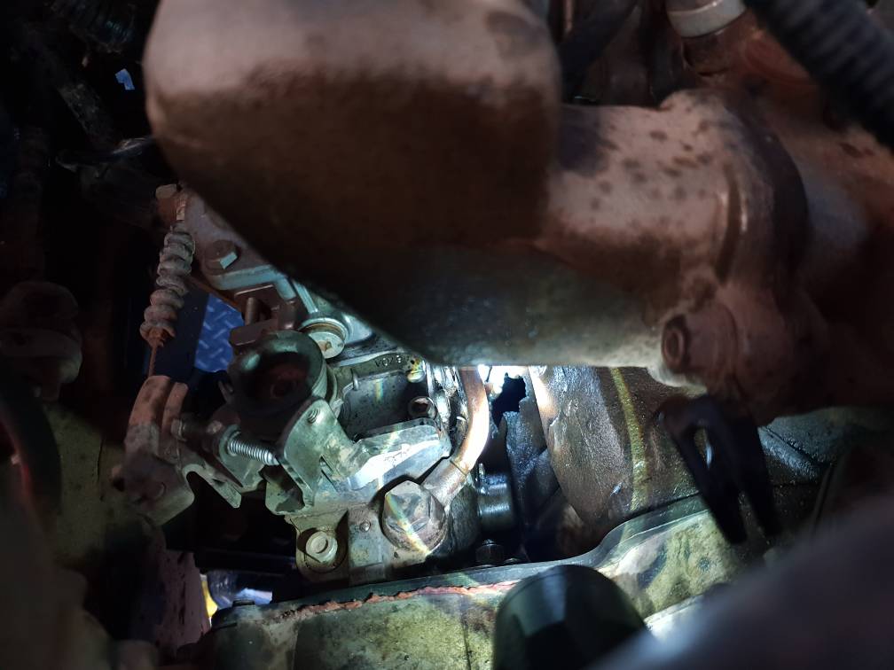

Here's a better pic.
http://www.nissanpatrol.com.au/forum...018/10/139.jpg

Anything different that you can recall leading up to this? Oil usage, coolant usage, hard starting, overheating etc.
Hmm. Could have been a possible gasket/head issue and has ingested some water causing a hydraulic situation.
Not much. Probably not even a tablespoon. What can happen is you can have a blown gasket or cracked head, while running this may not be a problem. Its when the vehicle is stopped and it can leak some coolant into the bore. Then when you start it next time it can bend the rod. There are many other variables and consideratios to take into account. But not returning coolant and having a pressurised system (coolant being pushed out of expansion tank.) Can be a sign of conbustion pressure entering the cooling system.

Unfortunately I think that rad leak may have been a good contribution.
As Matt mentioned it's not while running that's the issue..

Yep. The bent rod can cause the bore to wear unevenly and the bottom rings to pull down further than usual and eventually fail.
As I said there are many variables. You could have got 5km up the road or 5000km. It could have been the tiny amount but you had it parked up a while to do your diffs. So a slow leak could have been enough that once you started it you bent it a little. Once its bent it will keep bending. Throw some load on it and it bends fsr enough to grab the the bore and snap. Then just breaks shit.
