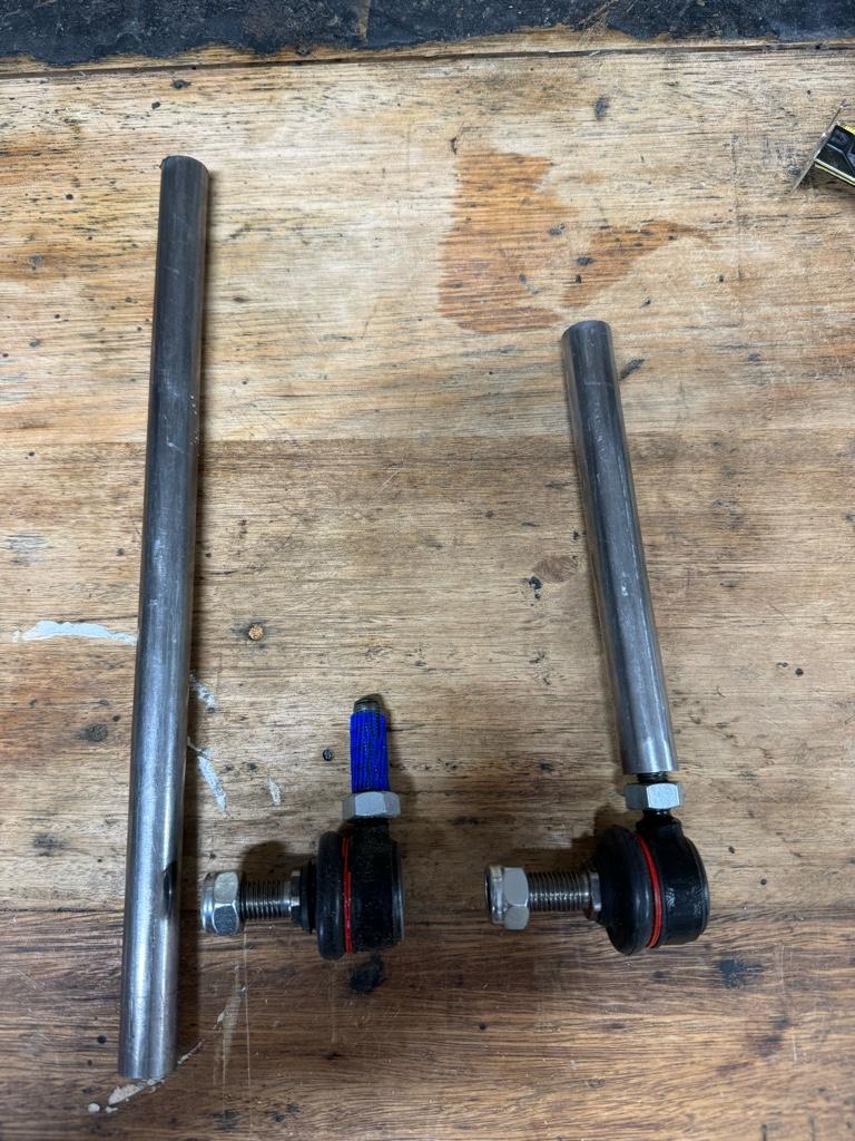

Got some heavy steel tubing, cut to the length I need, drilled and tapped one end to M10x1.25 to hold onto a mini tie rod.
I just need to figure out whether to use 8.8 grade threaded rod for the top end or go the next tensile strength up. 10.2 I think it is.
10.2 is obviously stronger but has less give than 8.8, so it could potentially snap if flexed too much, but that’s what the mounting rubbers are for, to allow the rod to pivot in the mounting hole.
I’ll do a test run on the fronts. Then do the rears next if these work out.

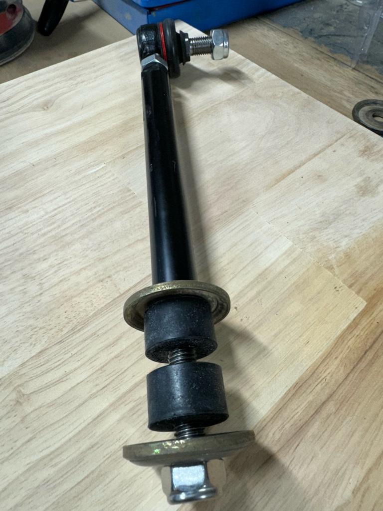

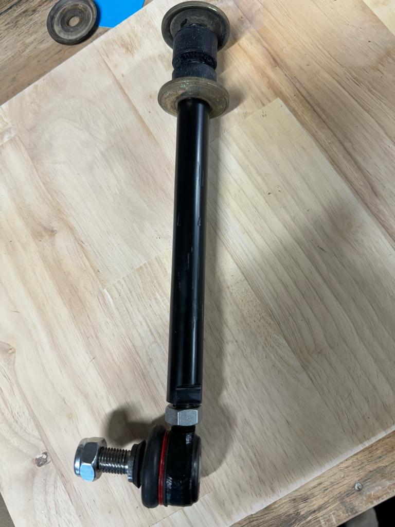

Finally got around to finishing one link. I used 10.9 m10x1.5 all thread in the top.

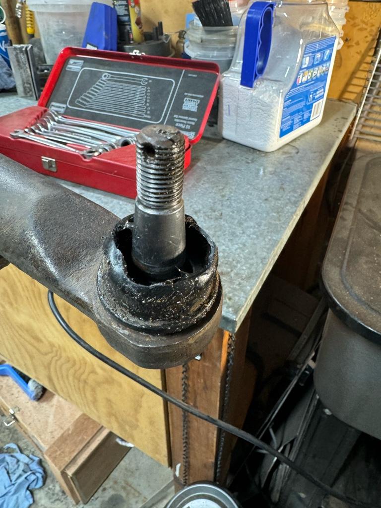

Tie rod and drag link end boots need to be replaced.

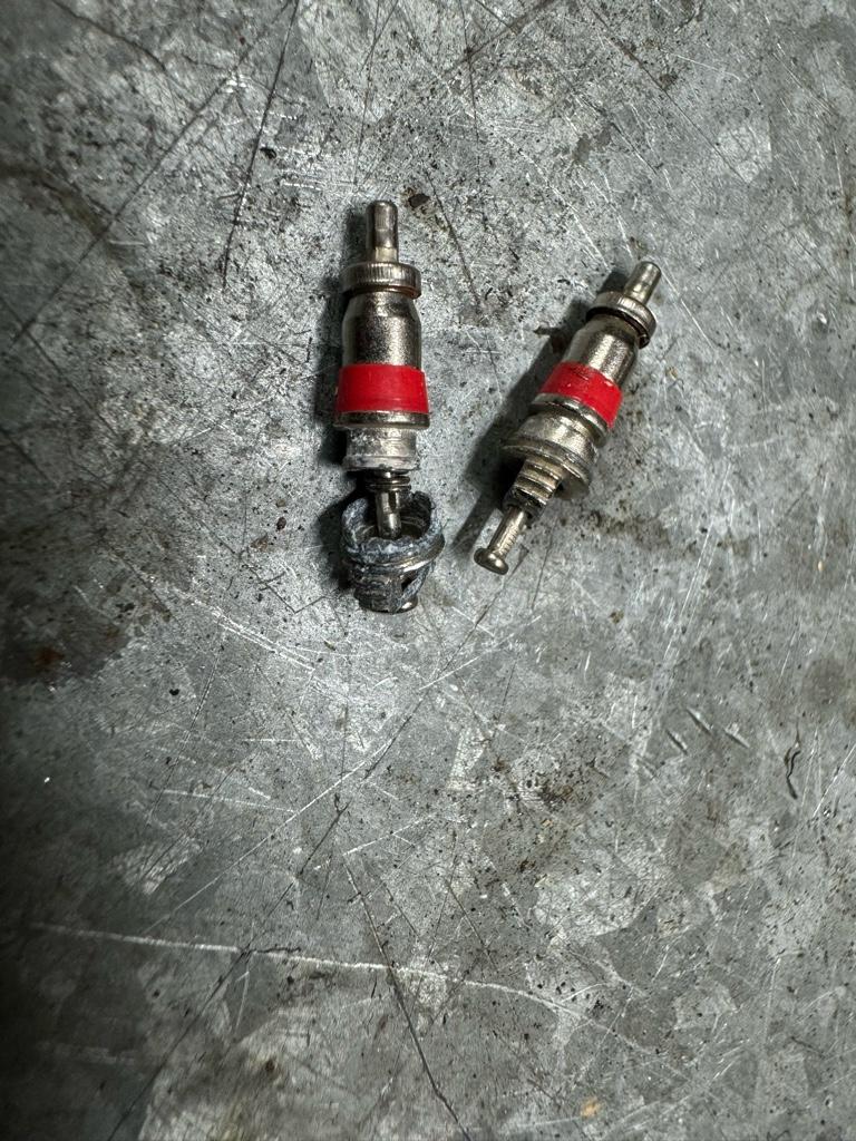

And I’ve had a small issue for a while where I couldn’t pump up the tyres. For some reason any air chuck I used would not pump air into them.
Long story short Darren last year suggested maybe wind out the valves a little. This worked. So every time I had to put air in the tyres I had to loosen the inserts a little.
So I was guessing the seal on the valve insert was worn out from using a tyre deflator many times over.
So I finally changed them out. One insert was actually broken.
http://www.nissanpatrol.com.au/forum...2023/12/30.jpg
So we’ll see if new inserts help.
