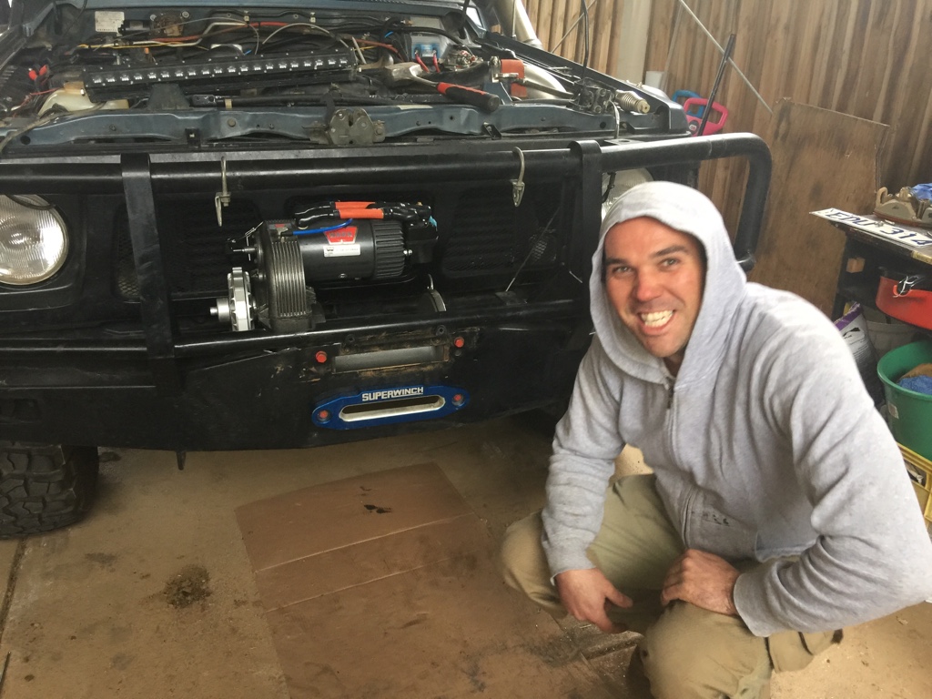

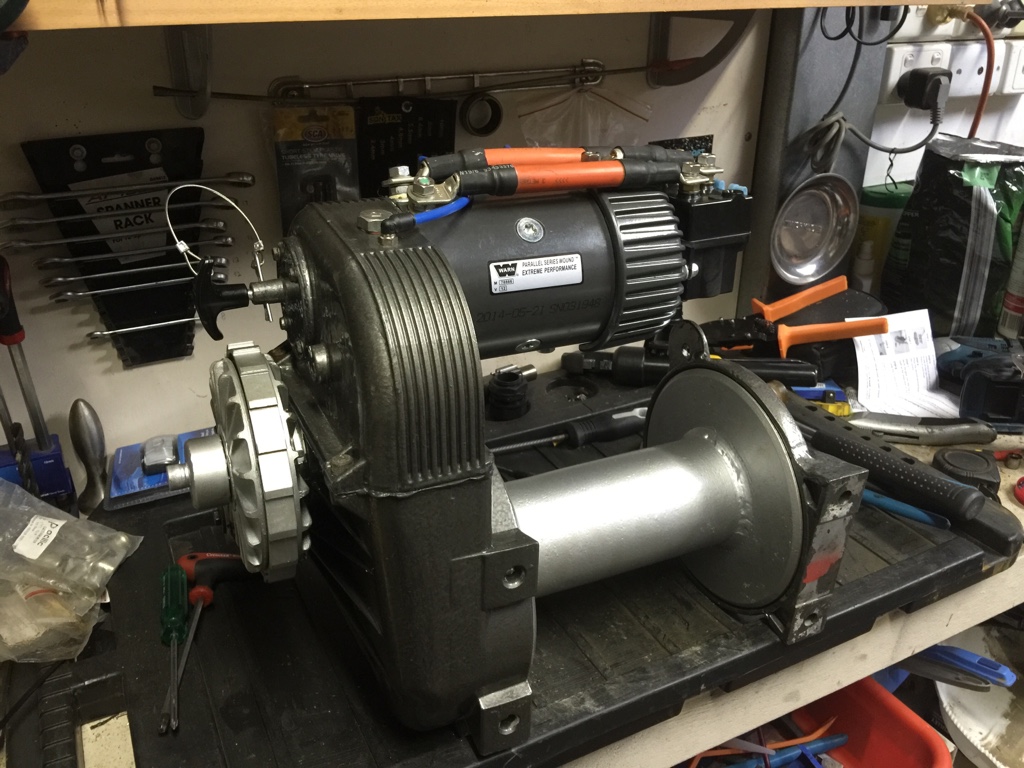

Ready to go
http://www.nissanpatrol.com.au/forum...2015/07/92.jpg
http://www.nissanpatrol.com.au/forum...2015/07/93.jpg
http://www.nissanpatrol.com.au/forum...2015/07/94.jpg

Take heaps of photos guys.. I know Darren will!

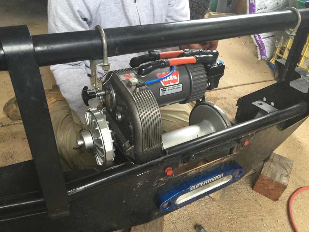

Big intercooler ;)
It fits
http://www.nissanpatrol.com.au/forum...2015/07/96.jpg
http://www.nissanpatrol.com.au/forum...2015/07/97.jpg

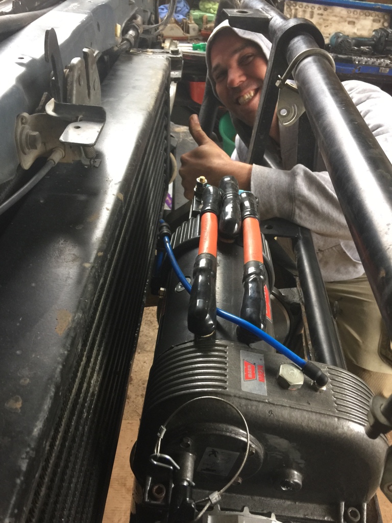

It clears the Intercooler. AB is very pleased!
http://www.nissanpatrol.com.au/forum...2015/07/98.jpg
Fark yeah boys, job well done!!!

Nice one. Hows the grill clearance, doesn't look too hacked at all. . .
There is something missing which is kind of important.
AB just left. All fitted up, grill came up a winner. Main cables crimped and fitted. Ran out of time to wire up the switching side. Sat down and drew up a diagram and ran through everything for an Isolation switch, in cab controllers and Grill mounted switches for use by the Navi. All through the isolation switch though. AB is stoked.
