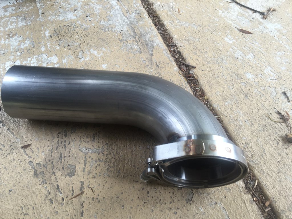

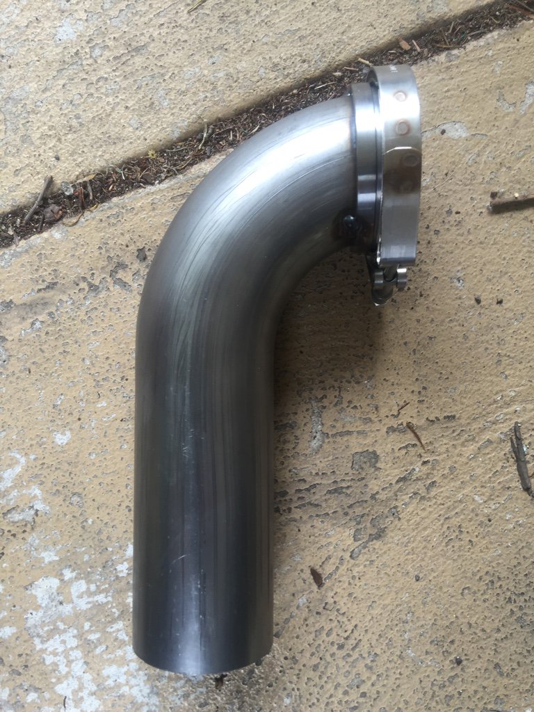

Is this the bit??
http://www.nissanpatrol.com.au/forum.../2016/12/1.gif
Is this the bit??

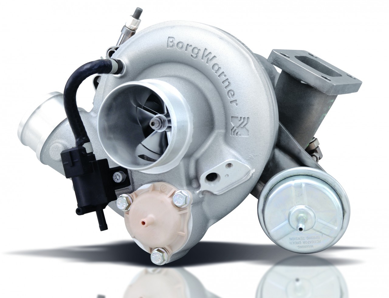

Umm seems a bit rough mate. I though you owned a grinder and a welder? I have a bigger version of this turbo than you and managed to get the dump to fit with no firewall beating. The 6758 is not a big turbo mate. The factory manifold sits the turbos a long way back. You would have had the same issue with a china 18g. The ufi come with a dump pipe but they are very tight and only juat clear the firewall.
