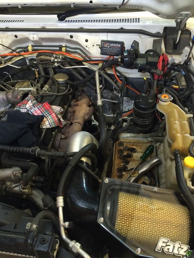

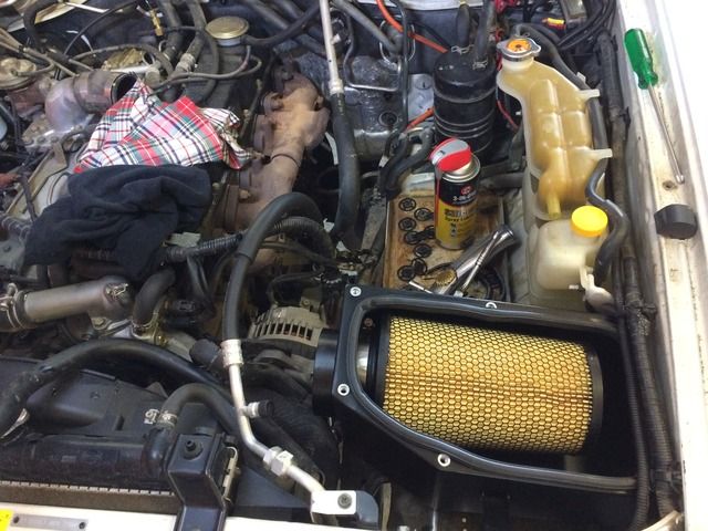

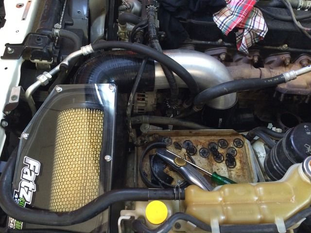

So in an act of true procrastination I installed my airbox and painted the panel on the back door that works the auto wheel carrier swing arm :o Also test fitted the pipework for the turbo, all good.

Is the outlet on that air box 4inch mate? I also assume it fits in nice where the oem filter is and the battery can stay where it is?
Yes mate, it's 4" in and out. I've had to move nothing to get it in there, the battery will slip into it's original spot no problems. Pipework essentially misses everything, well nothing that can't be fixed in 30 seconds or less.
