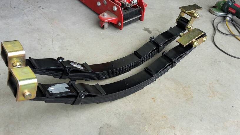

So I only removed the drawbar and springs..
The previous owner had the axle flipped and some dodge as hell spacers made up..
So I ran the 100x50x3 duragalv right threw, the welded the caravan sub frame to the top and the new springs under it..
I also put the new 50mm axle on top of the springs..
The springs are an out back eye to eye..
1.2T I went as I'm adding a a full size tool box to the front aswell as batteries etc inside..

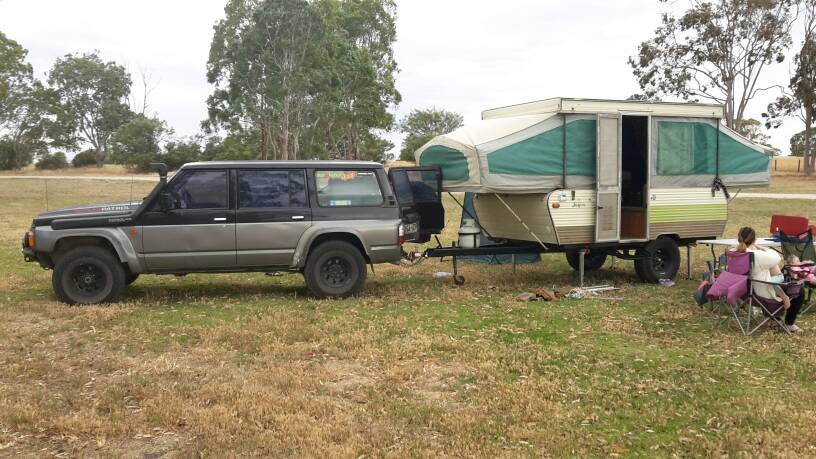

Genuine treg shamfer.. can hook up myself as the hitch just slides in
http://www.nissanpatrol.com.au/forum...2016/02/32.jpg
And the extra length is awesome
