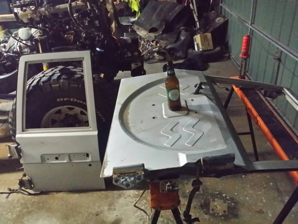

Barn doors are ready, drop those of today and grab the other 2 doors. .
Yay no more body work to prep, just need to get the guard done again i scratched. 😕
