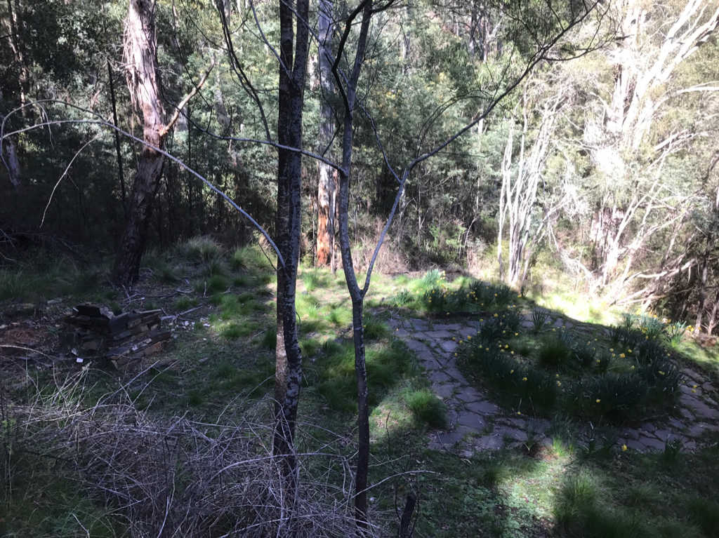

Would have loved to see this site 100 years ago. Nice paved area, might have had a home there I assume.
Andy, would have been some pleasant quiet times, even though some high adrenaline moments. Great bridge building.
Remember pocking around that general area yrs ago and came across some hop plants growing, must have been existing there for yrs and guess they were used for making yeast (hops and potatoes) to make beer.

Awesome AB love that pic of the bridge. Yeah pretty cool just poking about exploring by yourself, have always meant to spend a bit more time around Woods Point so much stuff hidden out there. .
Give us the coordinates AB and I'll put it on the list looks like a fantastic spot .

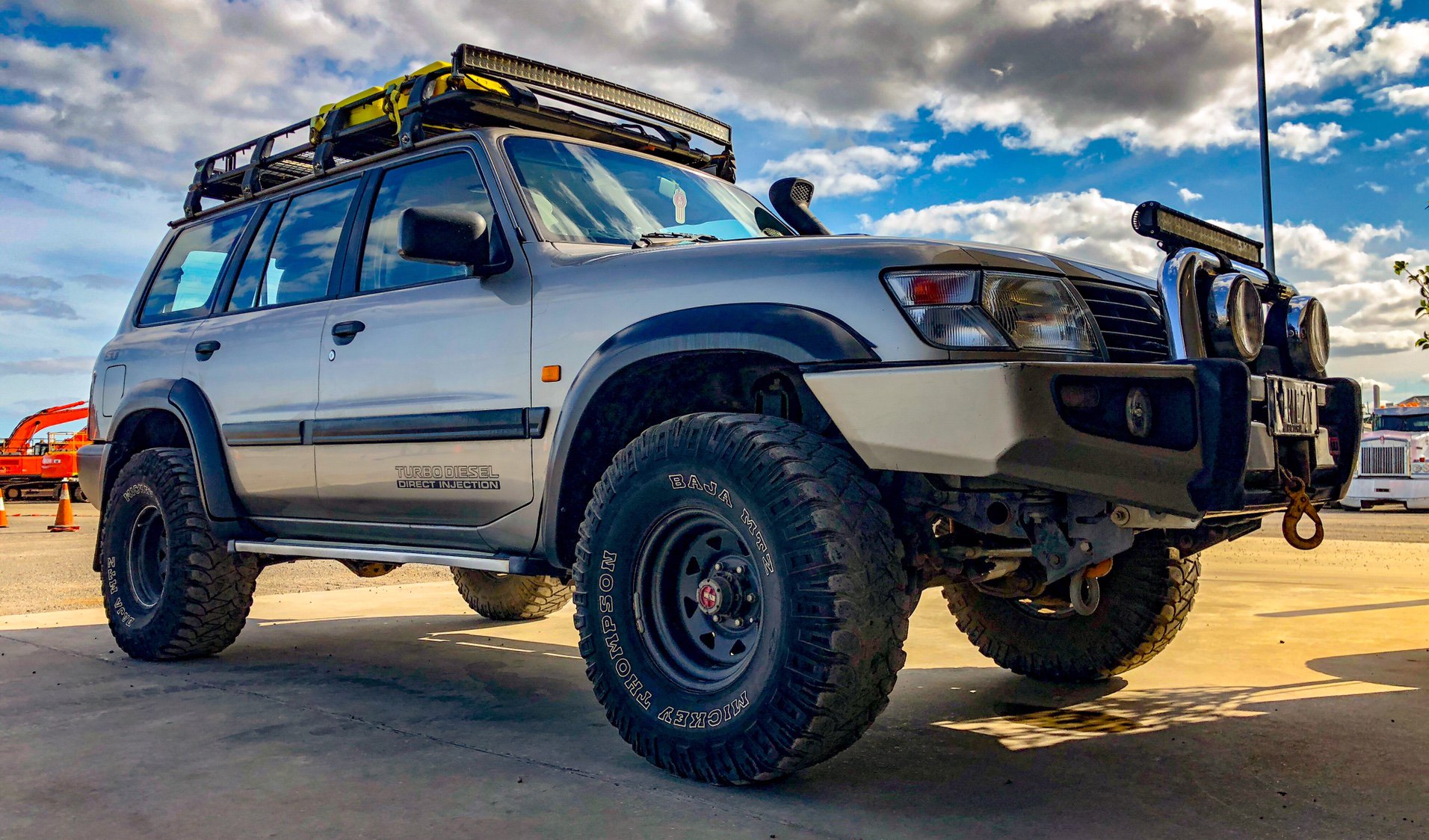

Finished the rear bar off this morning. Then removed the rad and viscous hub as the hub is leaking, again. Cooling is a never ending issue it seems lately. http://www.nissanpatrol.com.au/forum...018/10/264.jpg

Oooh very smart Markie looks awesome mate. [emoji4]
Looks really smart Mark
Magnifico ElMarko Gringo [emoji106][emoji106]
Time now to debark that beautiful powder coat in your HC brother!!
Great quality bar this is. Lined up absolutely perfect on Marks Patrol, give or take a few millimetres. I helped him fit it and saw and felt first hand the finish of it. The welds and the powder coat are class 1.
If you're in market for bar work , Millweld is the go people.

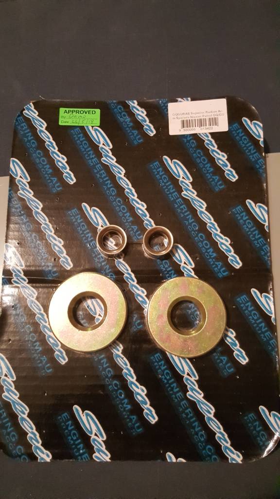

Also attempted to fit radius arm spacers , to push the front axle forward to clear the mud flaps.
Chassis on stands , jack under diff...
And then realised I don't have a deep enough 24mm ... ugh.
So I called it a day. Lol http://www.nissanpatrol.com.au/forum...018/10/540.jpghttp://www.nissanpatrol.com.au/forum...018/10/541.jpg
Reading this with interest Hodge especially the method as I am up to do my radius arm spacers, good luck.
Thanks @PeeBee.
I'm just winging it as I go mate. It's all new to me.
My plan was to jack the chassis up and stand it , to take weight off the axle.
Then , chock the front wheels back and front so it doesn't runaway on me once radius arm is unbolted.
Remove the sway bar links away from the radius arm and then unbolt the arm itself. Stick a jack under the axle to lift accordingly if need be to allow the 2 axle bolts to come out easier.
Then remove or push the radius arm forward enough out of the chassis mount to slide the new washer on and then slide it back into the chassis . @mudski gave me the heads up on a idea to put a ratchet straps around front of the car somewhere like bull bar brackets & the other end around the axle and then ratched the axle forward enough to align bolt holes etc ...
That's my grand plan anyway lol.

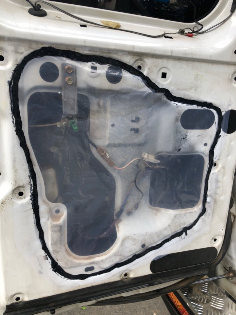

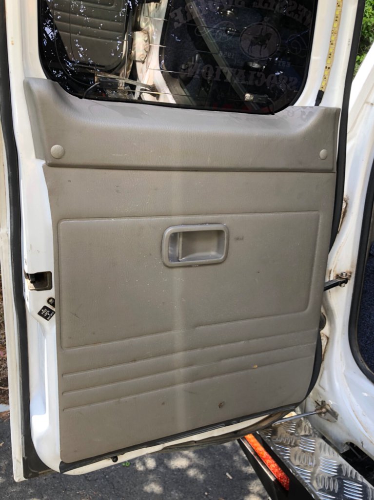

Wasn’t today but Sunday. I had to replace the reverse camera on the small barn door. So while I was at it I made up a new plastic seal thingo for the door, sikaflexed up any holes in the door to try and stop the exhaust leaking into the cab. Didn’t work though. I also removed the inner door handle. http://www.nissanpatrol.com.au/forum...018/10/611.jpghttp://www.nissanpatrol.com.au/forum...018/10/612.jpg
Now to find where this exhaust leak is... I have to drive with the air on recirculate all the time otherwise when I stop moving I get a nose full of exhaust fumes.

Does the GU have vents in the rear quarter panel/outer skin like the GQ? This is where I find a bit of dust entering my vehicle. Might be a spot where exhaust is recirculating?
I also notice your door seal is hanging down, maybe another entry point?

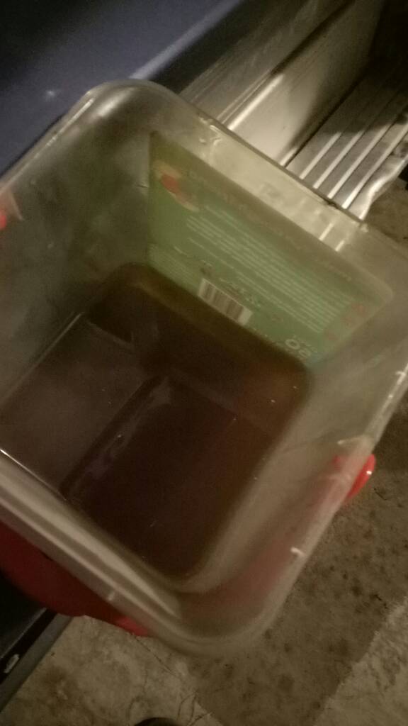

Diff oil change. Getting betterhttp://www.nissanpatrol.com.au/forum...018/10/628.jpg
