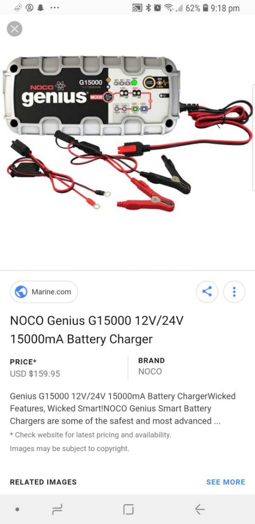

Hey mark. I bit the bullet 2 years ago and spent $$$ on a decent charger. 15amp smart charger. 12v/24v. Beast Charger.
Noco Genius 15000
http://www.nissanpatrol.com.au/forum...2018/07/11.jpg
Cheers ‘daz’, appreciated! Too many choices now, looks The Tops :-)
