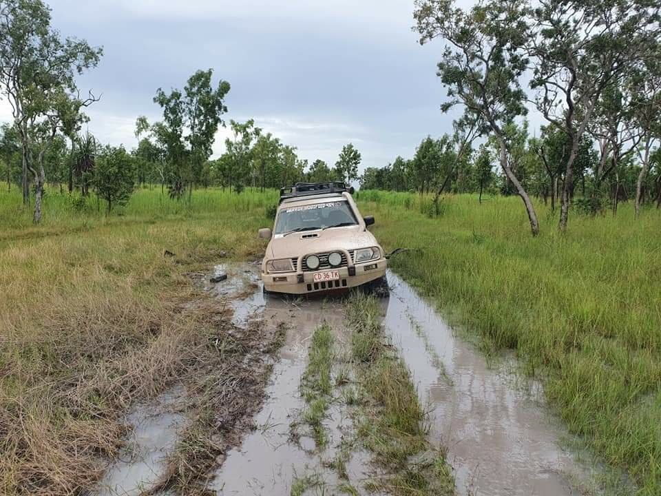

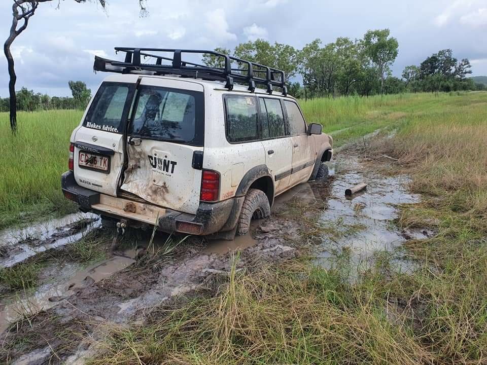

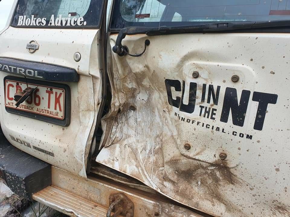

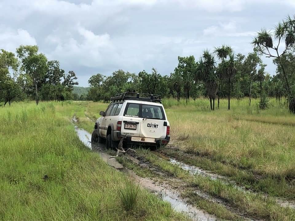

I recently received this photo from a friend.
Here's the aftermath of a broken snatch strap. No towball, no shackle, just the snatch strap. Look at the damage to the tail gate! Attachment 82305

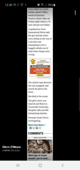

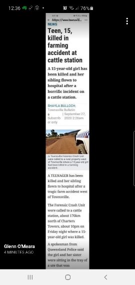

I figure this is a good a place as any to drop this.
All I could do was shake my head when I found it.
When you see it....
Attachment 82945

Crazy Stuff Mate!! It will take your head off.
If only pictures could truly convey sound waves shocking a bloke scared to the bone personally experienced myself in younger uneducated days.......never attempt mud bog Snatch recoveries IMHO [emoji51]
Slow & steady (no rush) winch your way out of the suction slick and yes this is still plausible for Sand, albeit wet quicky stuff only hopefully caused by beach outgoing creeks or low outgoing tides?
I think all recoveries carry an element of risk, that's why we take care to make sure nobody is in the firing line. We know a winch rope has just as much potential to do some serious damage.
I think you're probably right and if you have the option to winch out of mud it might be the better choice but a correctly used snatch would be just as viable and safe/carry similar risks.
I think the likelihood of this kind of damage to a windscreen would be very low. Using the strap as intended (straight pull) will see the bulk of its mass recoil directly towards its fixture points if it does break.
If anything I think that these pictures and experiences are a lesson teaching us to replace our snatch straps a bit more regularly?
I have seen more than a couple of Snatches break. it is fare average when they go. the first one i saw was back in the day and they were snatching a GQ out of a bog. The snatch broke and shattered the front grill of the bogged GQ and smashed a head light. I was very new to the scene and surprised at the damage.
I agree they have their place. the best lessons learned here though is to figure out where the line is. to determine when a Snatch simply should not be considered.. Respect the limit of the snatch. Dont just hit it harder.
i subscribe to this rule. "When in Doubt, Winch Out"
