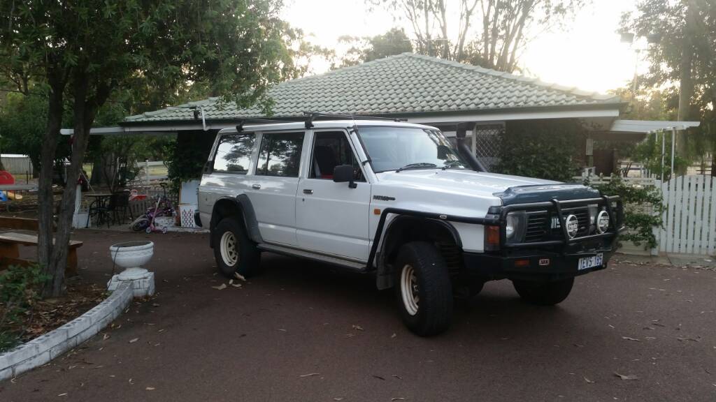

http://www.nissanpatrol.com.au/forum...2015/12/56.jpg
A shiny new patrol[emoji3]
well an old one but its new to me.
