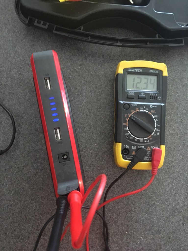

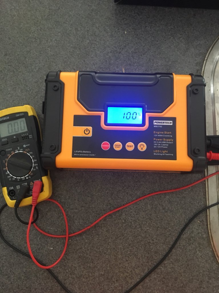

Do you reckon I should take mine back Craig mate? I thought 12.7ish meant fully charged on 12v batteries or are these little packs different somehow?
Thats too low, mate... for a LiFePo 90 to 100% S.O.C. no load voltage should be up in the 13's or even very low 14's.
Did you measure that voltage at the "jump start" terminals or at one of the other pairs?
The "jump" terminals are 'hot' off the battery pack but on a lot of the various packs those 'aux' and 'test' terminals will have circuitry on them and you may not be seeing the battery itself
Thanks mate, yeah I just stuck the multimeter straight into the units jump starter plug connection under the rubber flap.
Hmmm... OK... what sort/brand/part # pack did you buy?
I'm not convinced there is something wrong yet just curious
Mine has no output on the jump terminals unless I go to 'override' IE the pack can tell if there is a battery connected or not.
You could try putting it on Charge and see if the voltage changes then leave it a while and check volts again even tho it says 100% on the indication
Dunno... could be that some use 3 and some 4 maybe.
Mine definitely goes up around 14 when fully charged and for interest I just confirmed 13.6 at the terminals (last charged 2 months ago) with the lamp on as a load albeit a small one.
I also wouldn't have thought they would use the overcharge (4.2V) for the normal charging of the packs but maybe they do on some.
As mentioned, on mine I have to go to override which takes out the fault diagnosis and reverse protection circuits.

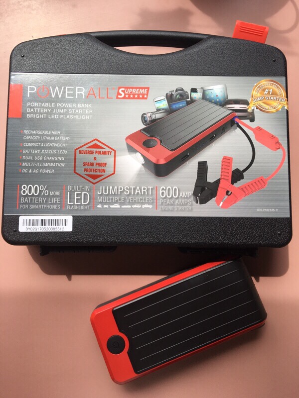

The model I bought for work (and one for myself) were around a couple of hunjy $ at the time and were the biggest I could get that were still legal for commercial air travel
...........http://www.nissanpatrol.com.au/forum...2017/11/15.jpg
That little box should contain some schottky diodes for protection against spikes and reverse connection, hopefully.
Powerall is supposedly one of the top brands in this market and because of that it is also one of the most copied/counterfeit.
Strangely for a Yank company their specs are very vague but, pfft, thats life these days.
If that one is a knockoff they went to great lengths to make it look genuine.
So lets assume it is genuine...then... you could maybe flick Powerall an email query or try and see if their online warranty rego will accept the device.

Mmmmmmm, checked it just now again and still reading 12.28 although strangely enough its on 80% now according to the lights. Plugged it in for another charge as ET suggested and started reading 12.35 instantly. Will see what it reads later. Does appear to be discharging itself :-(
That rise voltage is a temporary residual effect of the higher charging voltage. All batteries get that, and will drop to their charged voltage fairly quickly.
Yeah, let it sit on charge for a while.
Lithiums are a very different beast to Lead Acid.
For one thing they can't charge 'low' cells like a Lead Acid will IE once any Cell in series gets to max charge the charging flow virtually stops.
For that reason they have to have balancing circuits for the Cells.
Thats why some batteries of similar rating are more expensive and many manufacturers are selling versions they call "smart" as they have the circuits internal to the Battery.
Anyhooow... let the sucker sit there on charge for a while and see what you get.

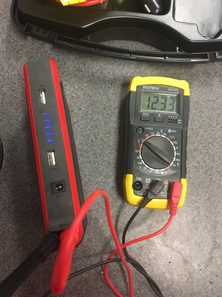

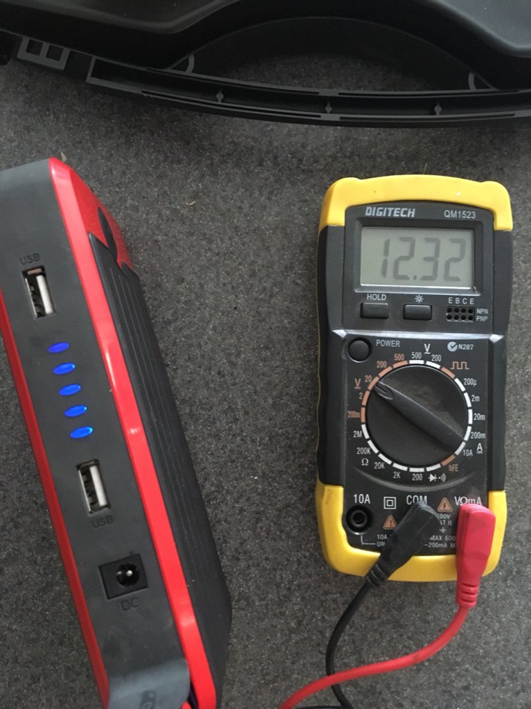

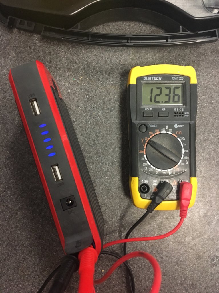

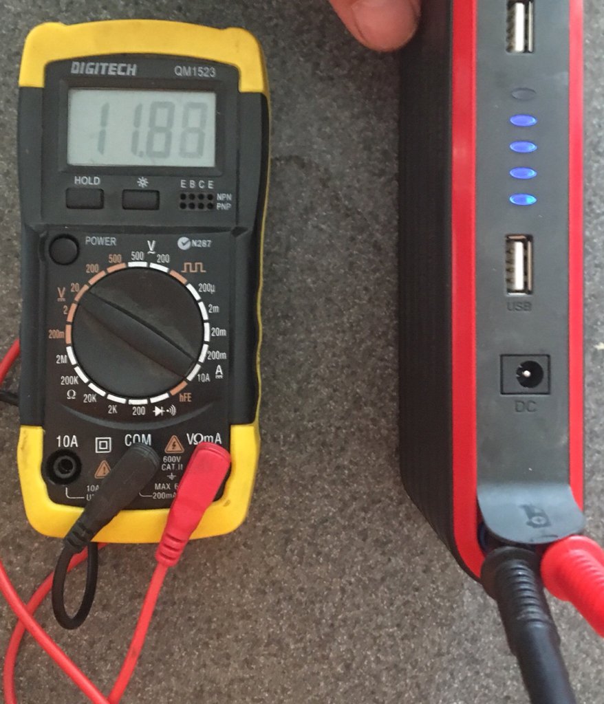

Dropped back into Repco a few weeks ago to discuss and they were to contact their supplier for standard specs info requested etc... No call back as yet but home tests kindly suggested above are over time showing issues I believe:
After 48hr charge:
(12hr later residual drop off test check)
http://www.nissanpatrol.com.au/forum...017/11/130.jpg

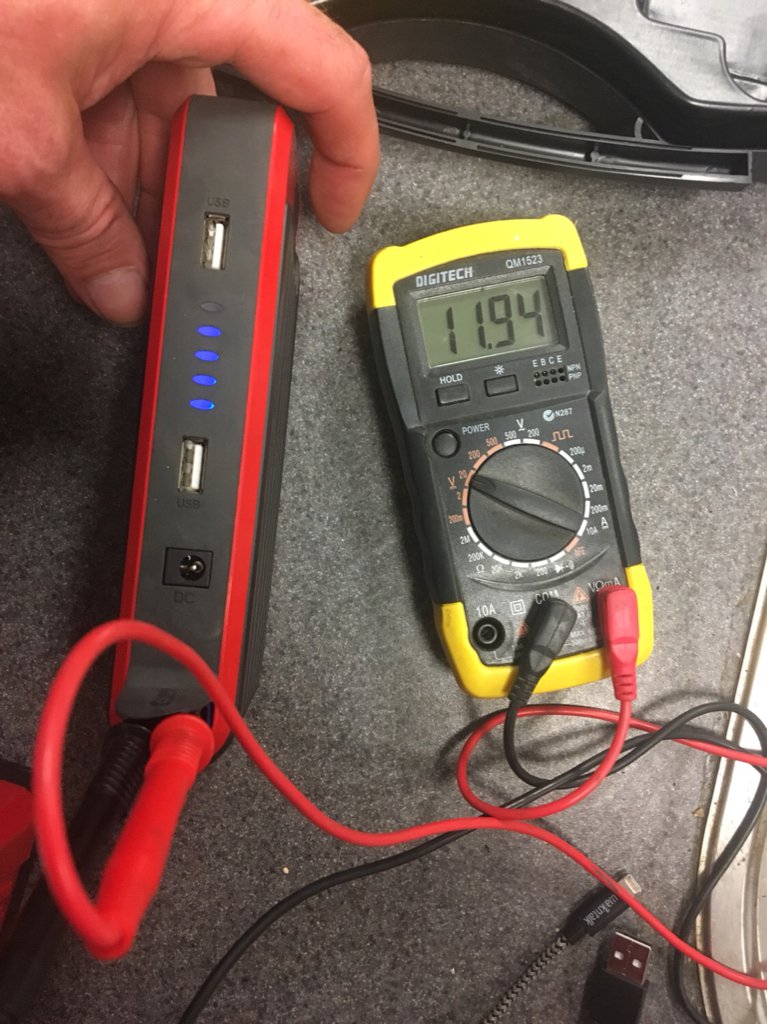

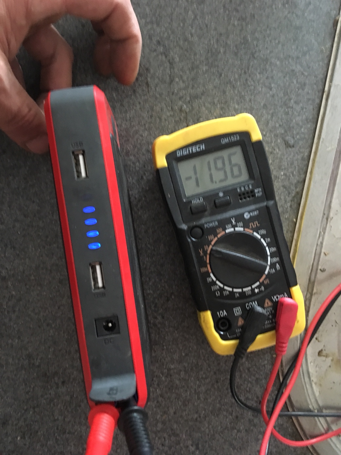

Following pics are as evenly taken as possible over the last few weeks:
http://www.nissanpatrol.com.au/forum...017/11/131.jpghttp://www.nissanpatrol.com.au/forum...017/11/132.jpghttp://www.nissanpatrol.com.au/forum...017/11/133.jpghttp://www.nissanpatrol.com.au/forum...017/11/134.jpg
I do now believe it’s warranted evidence for a store credit on oil, filters or the like.
Time to invest in your recommendation from the beginning on other helpful threads :-)

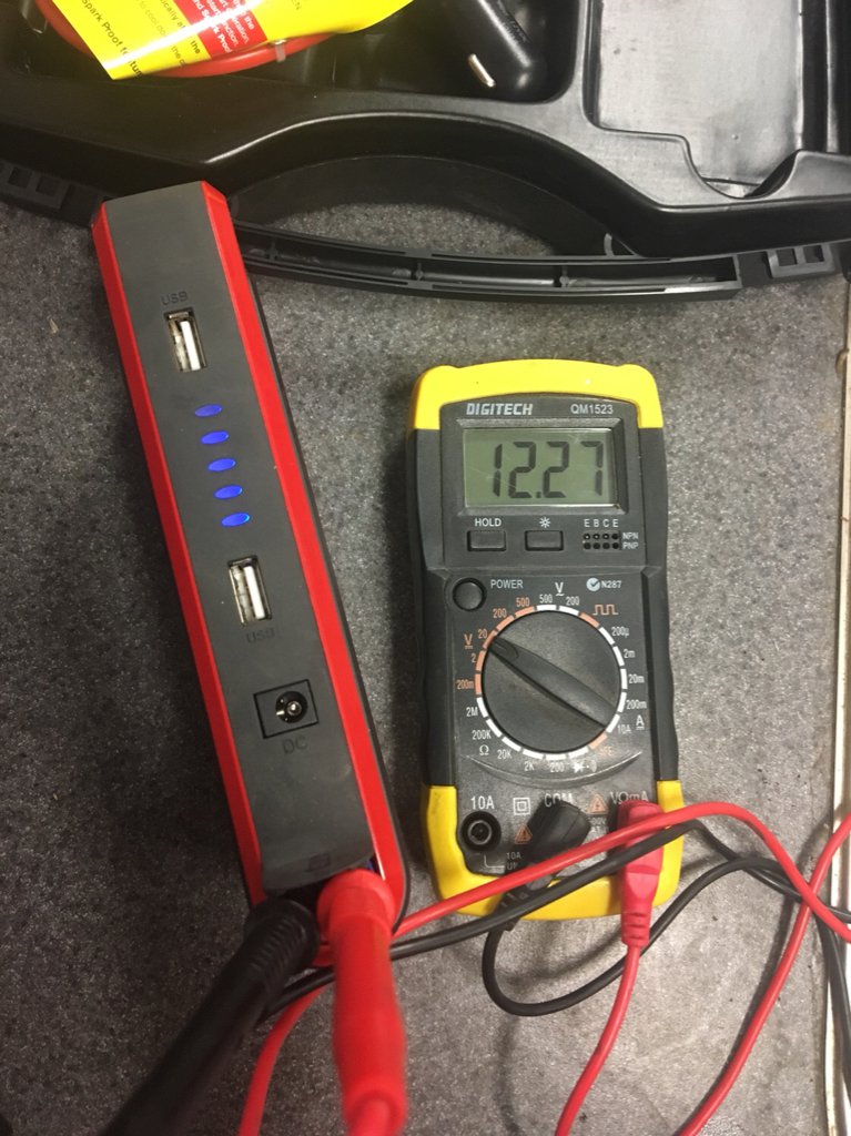

Final test:
Just used it for the last 30 minutes from 12.27V to put 50% charge needed back on my iphone :-(
http://www.nissanpatrol.com.au/forum...017/11/135.jpg
Lithium batteries should have higher volts than that
We have a 200 ah Lithium at Work and it still has 13.2 volts after 12 months on the shelf

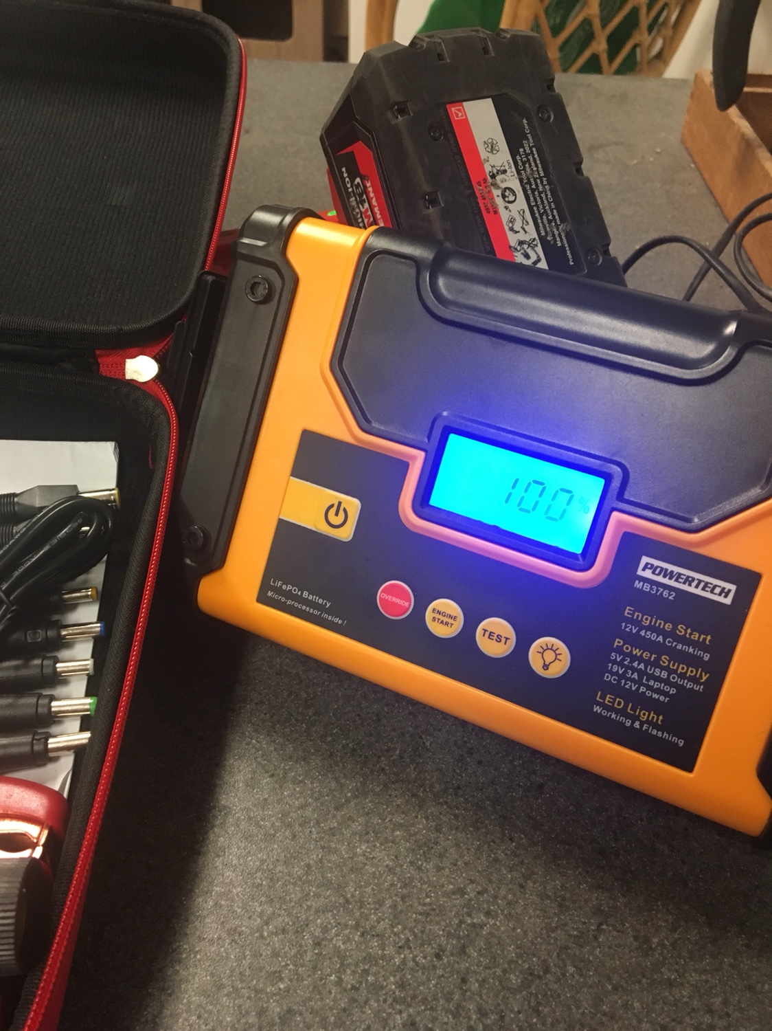

FYI MB here's mine. 4 months since last charge down to 3 bars on power bar, still ample volts.

Have just finally purchased one of ET’s kindly recommended ‘Powertech LifePo4’ models off Ebay. Did end up choosing the slightly larger 600A jobbie as I only need it for local work unlike ET I believe can sometimes need to air travel for projects with his 450A ripper still !
I checked my 800a unit last night after having it left uncharged from the AB Donk Party and it was sitting at 14.21V - have to be happy with that. I also have used it twice to jump start a V8 petrol engine and did it with ease - not charged afterwards either. Great unit the Wuldmar. I did have a small 'brick' style booster, about 50mm cube, ran off a 30V cell, but it was a gimmick - difficult to check charge or work out its state of charge and didn't have the grunt it claimed either.
