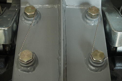

Any one know what locking wire is and what it's used for?
Its a thin wire (Stainless Steel is best) that's often used in aircraft to ensure that things cannot come undone. Typically a couple of small holes in the nut/bolt are wired to the next nut in such a way, that if one loosens, it would pull the other one tighter. Since they are torqued up in the first place, then it's difficult to pull the next one tighter - so one can't become loose. It tends to prevent the first loosening, and definitely prevents escalation.
It's been used on aircraft for years - simple and so so effective.
An example
http://www.nissanpatrol.com.au/forum...2012/11/31.jpg
This is a good solution for wheel nuts, I'm thinking of getting my nuts drilled :D
On the downside, it can really hurt when you don't bend over the locked wire and you stab it down behind your thumb nail
