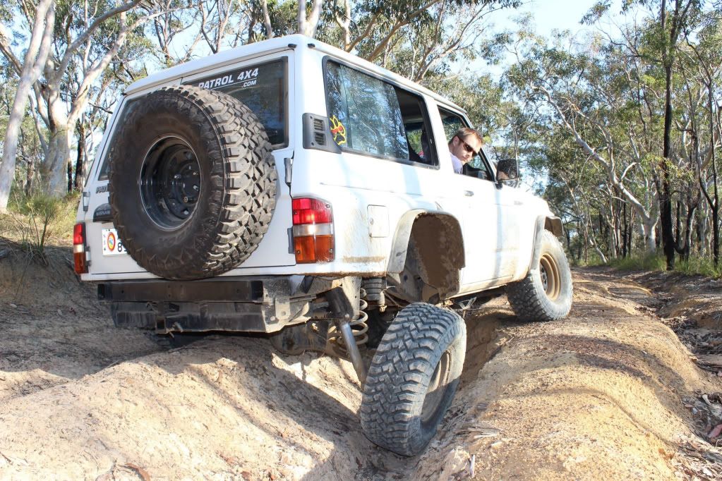

well i finally got it out on the tracks and almost put it on its roof

Great shots mate. Awesome looking shorty:)
haha doing a bit of tree hugging! lol
Sooo drooooollling over what you can do in the workshop. Your ride is a credit to you mate.
It's looking great mate -- love the shorty's!!
Nice use of the winch to keep things level as well!!! lol

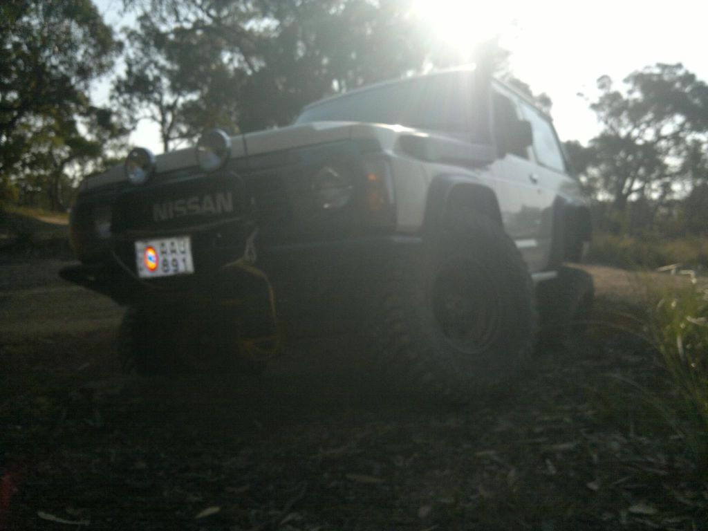

took it out with a mate who is a photographer and got some good shots here is the link to my photobucket account http://s1077.photobucket.com/albums/...t=IMG_3553.jpg
nice pics mate! thats a VERY tidy little patrol you have there!

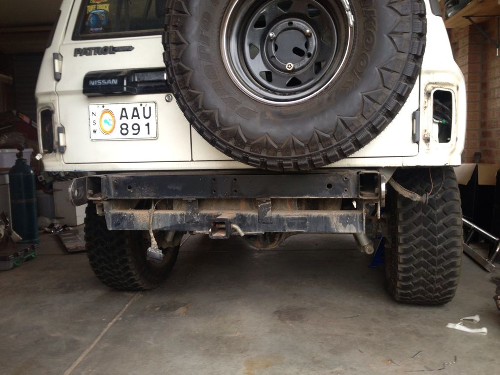

Haven't been on here for awhile so think its time for an update since last I've fitted extractors and built a 2.5inch exhaust fitted a front auto lokka temp gauge thermo fan started a set of rocksliders and just started doing a rear quarter chop so I can build a rear bar.http://i1077.photobucket.com/albums/...ps97c3e494.jpg

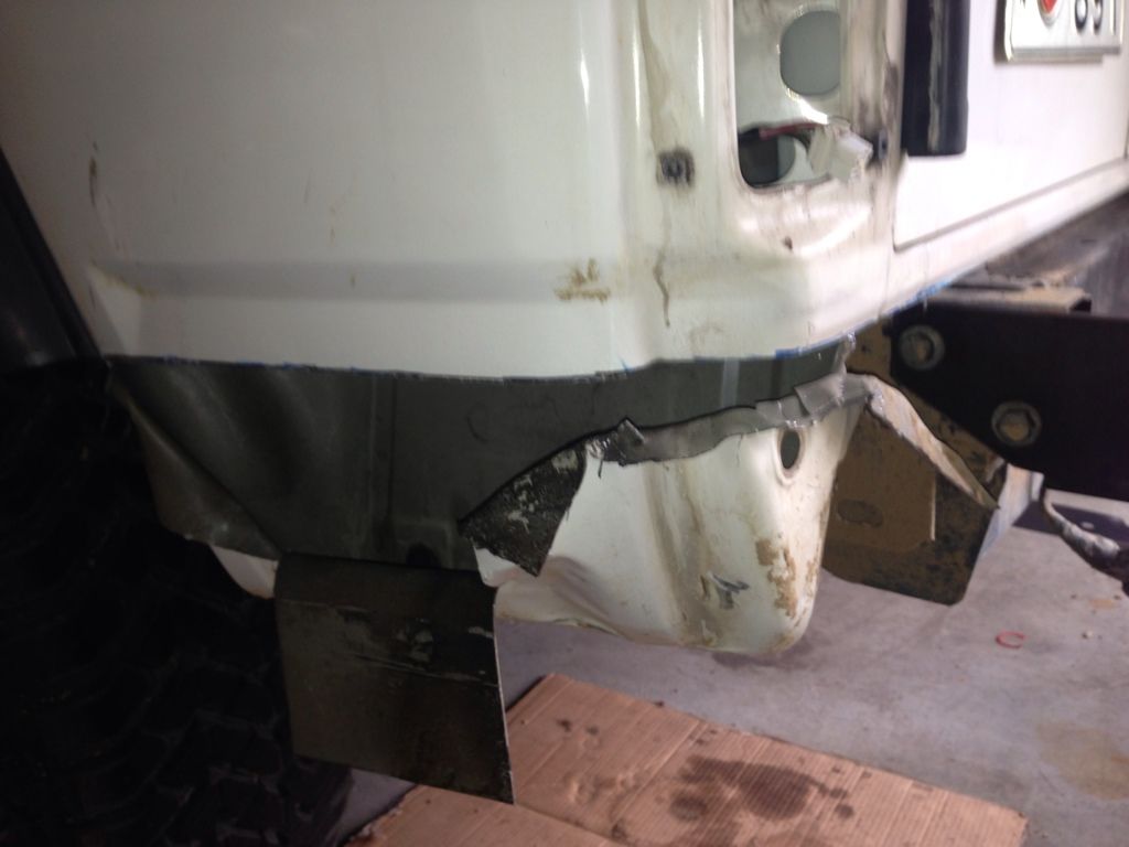

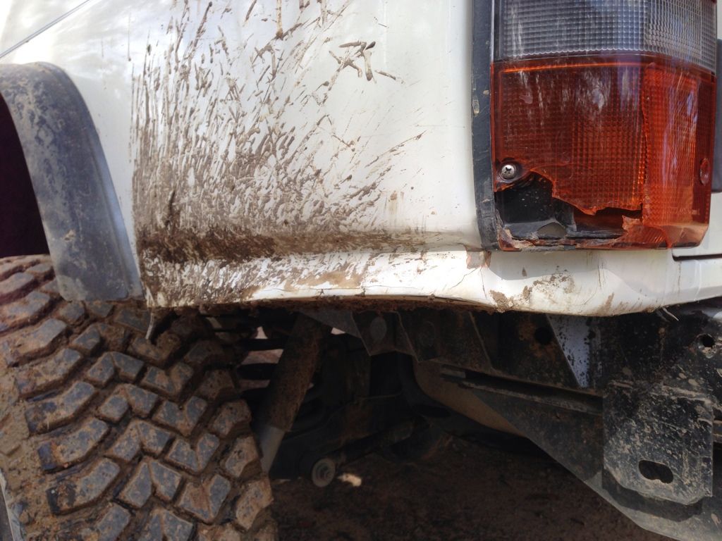

Bit of an update after all the work choping the quarters I destroyed it on a ledge http://i1077.photobucket.com/albums/...psf7ba51a6.jpghttp://i1077.photobucket.com/albums/...psd125f313.jpg
So I put my panel beating skills to test and ended up with thishttp://i1077.photobucket.com/albums/...psd778109e.jpghttp://i1077.photobucket.com/albums/...ps7d3727b4.jpg also thought since I have to paint it may as well cut the guards while iam at it
Witch brings me to the rear bar iam building http://i1077.photobucket.com/albums/...ps0b4a6ddc.jpg
http://i1077.photobucket.com/albums/...ps1d259105.jpghttp://i1077.photobucket.com/albums/...ps9667c7b4.jpg

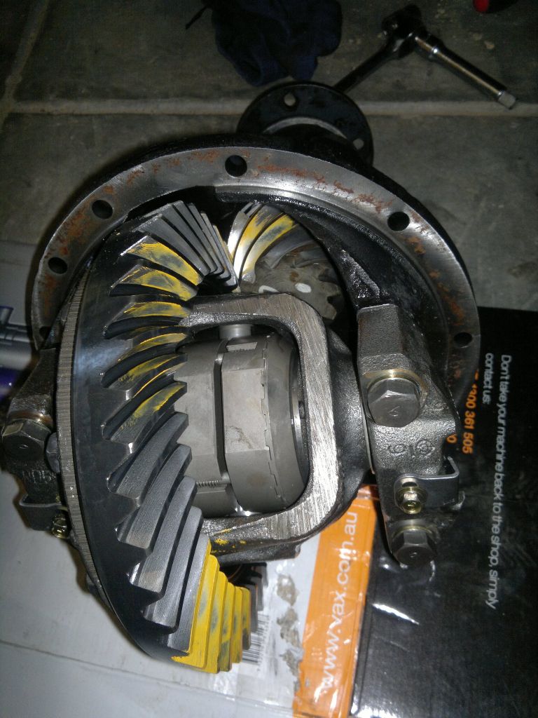

Well haven't been on here much so better do an update I've done a fair bit built a 4 point rollcage made some new heavy duty lower control arms changed to a set of 4.6 diff gears and fitted 85% reduction gears http://i1077.photobucket.com/albums/...ps327b8079.jpg
