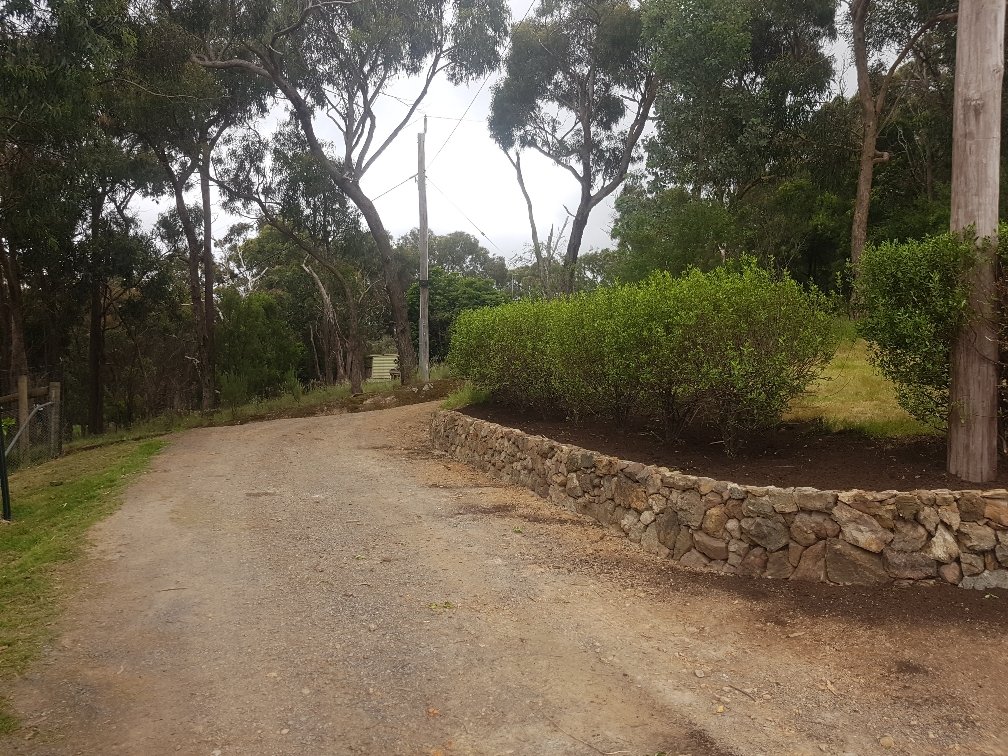

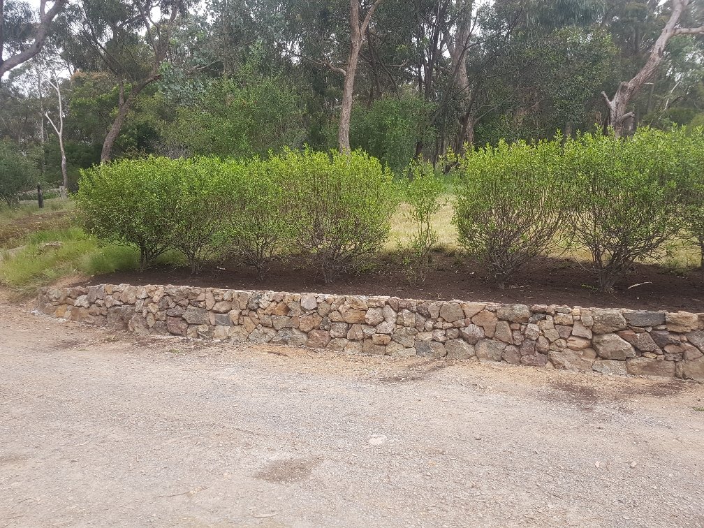

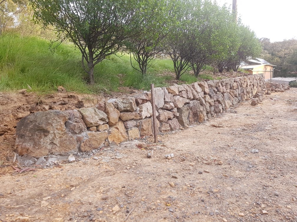

Rock wall is getting there . . .
http://www.nissanpatrol.com.au/forum...2020/10/31.jpg
http://www.nissanpatrol.com.au/forum...2020/10/32.jpg
Just need to turn the corner and taper down then keep going down the drive. . .
http://www.nissanpatrol.com.au/forum...2020/10/33.jpg
Not half bad for a tree logger lol. Looks like you even set a string line! Well done mate looks bloody fantastic
That looks brilliant Rossco, can't wait to see it.
Looking a bit of all right Rossco_top job mate, now for the Lichen starter rock.

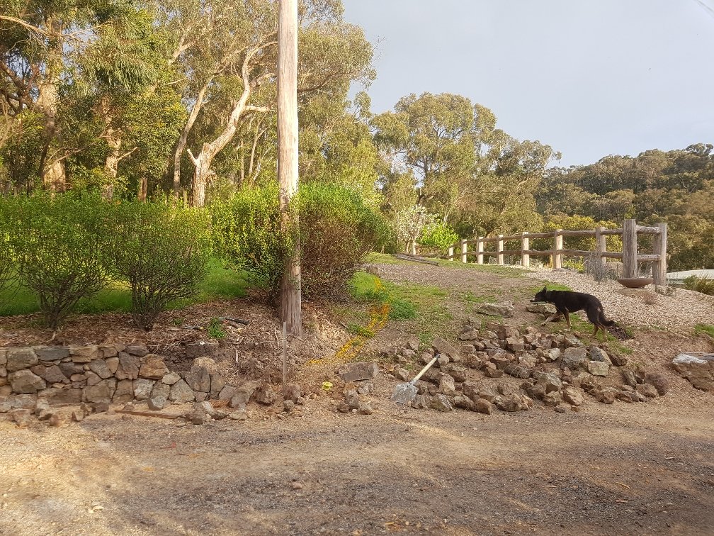

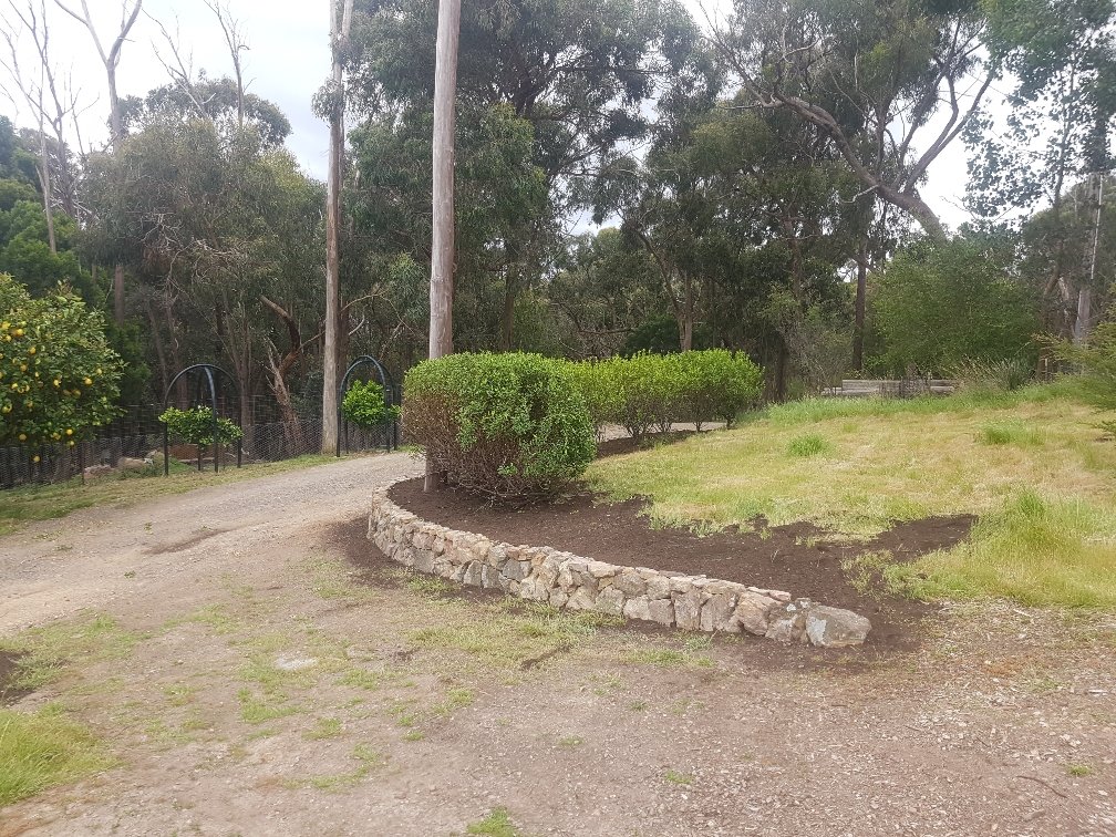

First section of rock wall done and backfilled with some of YG's finest blend. . . Came up look'n pretty spiffy time to keep on mov'n down. . .
http://www.nissanpatrol.com.au/forum.../2020/11/1.jpghttp://www.nissanpatrol.com.au/forum.../2020/11/2.jpghttp://www.nissanpatrol.com.au/forum.../2020/11/3.jpghttp://www.nissanpatrol.com.au/forum.../2020/11/4.jpg
Rossco that looks fantastic!
Cheers mate, yeah bloody stoked how it turned out TBH ! !
Great work, that looks really nice!
Did you use some sort of mortar to hold it all together?
Cheers mate, yeah tried to keep the joins as tight as possible and all mortered and tapered at the back. .

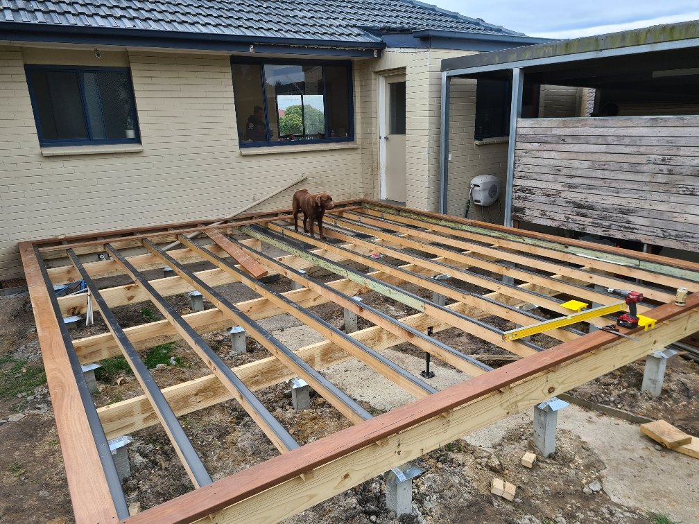

Serious question, I had planned to paint my deck joists black so they will be less visible once the boards have been laid. I got to thinking and I have 20L of pitch black used diesel engine oil, I know back in the day people would paint their fences with it, and I've given it the sniff test and there is no real smell to it now that it has been sitting uncovered for at least 12 months in the shed.
Can anybody see any down sides to painting the joists with it? I'm not really looking to add any protection to the treated pine as it will be undercover, it is purely to stop being able to see the treated pine through the gaps in the boards.
http://www.nissanpatrol.com.au/forum...021/05/192.jpg
@rustynail @MudRunnerTD @MB
@Winnie hmmm if you are not looking to stop rot then I dont think I would mate. I would be concerned about the smell when it hits a 45C in the middle of summer? For the sake of $50 for paint just roll on paint mate.
I’d probably recommend a water based bitumen paint Chrisso Mate, we use it on posts for into ground applications with lesser grade timbers like Sugargum versus bulletproof Ironbark’s.
Have diesel sump oil mixed with turps (needed for workable painting) my hardwood fences for years and they unfortunately stick brown road dust horribly until they need re-coating again every other year painfully doesn’t last as long as you’d think [emoji848]
How big a gap are yoy leaving between boards? What is the contrast like between decking and joists? Maybe you are trying to solve a problem that really isn't there?
If it were me I would be putting some sort of protection for the joists.
https://www.bunnings.com.au/protecta...joist_p0915409
True story.....treated piney aint a pinch of shit worth as it used to be!
If you’ve cut its ends with a saw 🪚 there is no protection as the process of treating barely sinks in on 5mm of outers gifted to you via merchants whole[emoji2961]
I ended up taking your good fellow advice and trying a Bunnings click and collect order and got 100m of the rubber "protect a deck"
For the price of it, it wasn't worth trying to find a reason not to use it, and it will solve the potential issue I had of seeing the joists through the boards, and may even help cushion the boards a little to reduce squeaking.
FWIW....It is honestly worth painting your TP cut ends Chrisso Mate [emoji51]
Remind me, I’ll send disaster piccies to clarify if you need new Homemaker Legends [emoji120][emoji3590][emoji106][emoji106]
@Winnie ; you don’t have termite issues where you are? If you do prep the area for them too.
Thanks for the thought, but all good there.
