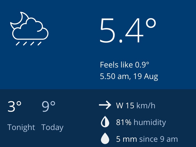

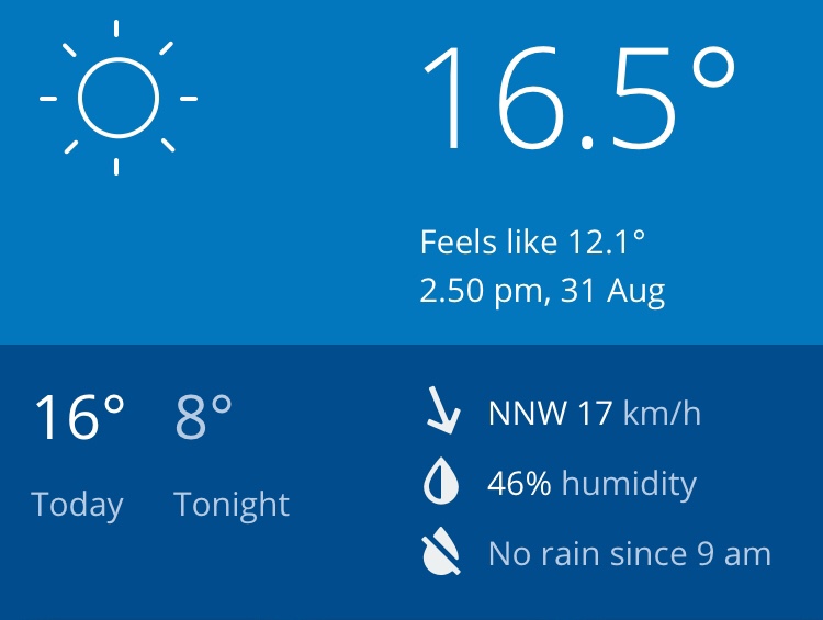

EDIT: Todays peak ambient temperature pic below for my summer time reference safe storage :-)
http://www.nissanpatrol.com.au/forum...019/08/205.jpg

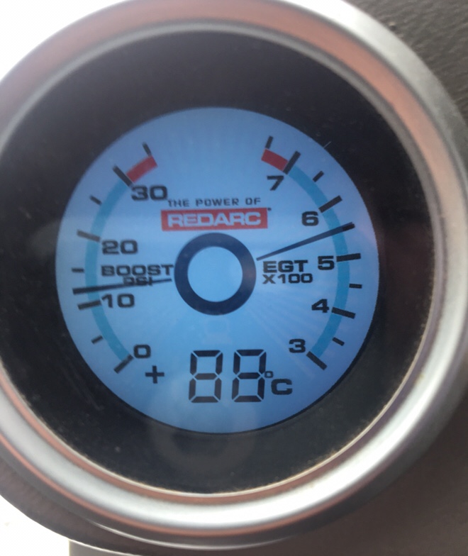

Finally some half decent weather down here earlier today to record some more TD27 88C winter thermostat findings in the old TD42Test.
https://uploads.tapatalk-cdn.com/201...eb96618665.jpg
As per last highway runs record it appears to have now increased all numbers by approximately 1-2C.
So previous range of 80/90/100/110kmph with temps of 88/89/90/91C have today now jumped to 89/90/91/92C and a sneak into 93C at one short blip up and back.
Off highway/freeway gave it another top flogging 575EGT’s up our test hill and did manage to score 96C briefly.
Not too stressed at this stage as previous 88C TS pot tests showed full open wasn’t until 98C.
EDIT: Idle has now come up to 89C too IIRC
