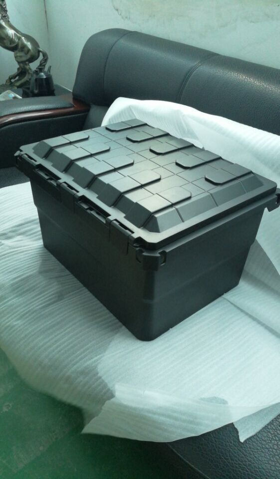

First prototype guys!
Got to sort the seal and goretex valve install now and then smash it around a bit.

Woohoo! Well done & it looks just as good as the virtual ones! Quite an achievement. Fingers crossed that testing goes well.
That looks awesome! I hope it works and lasts as good as it looks.

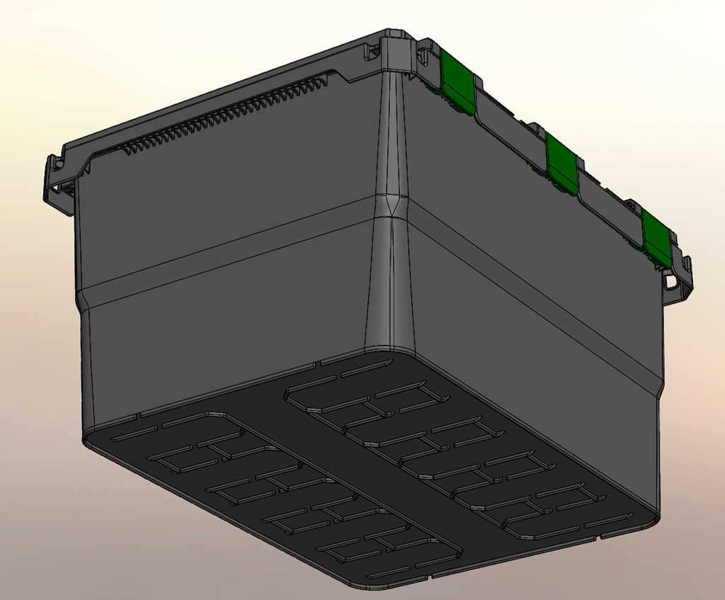

have you got a pic of the underside? is it smooth so it can be dragged across surfaces or ribbed and must be lifted?
Underside will fit the lid ridges to assist with stacking. There are some vague sketches around here somewhere to later play with a wheeled version but at this stage it looks like the below.
If you mean for dragging it across the top of another box, then we've put in two lengthways ribs to help that go smoothly.
http://www.nissanpatrol.com.au/forum...2017/07/60.jpgUnderside by Ben Kincade,
Thanks mate. Yeah I have found with the cheap tubs that the ribs can catch and grab in carpet and rough surfaces and break off. The cheap ones with wheels also don't last well with wheels ripping off.
Surfaces that it might get dragged across would be checkerplate in the bottoms of the camper trailer, carpet on top of the rear drawers in the GU, carpet on the floor at home, concrete driveway. Roof rack mesh.

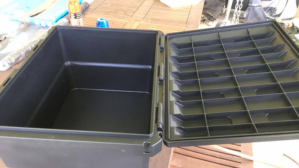

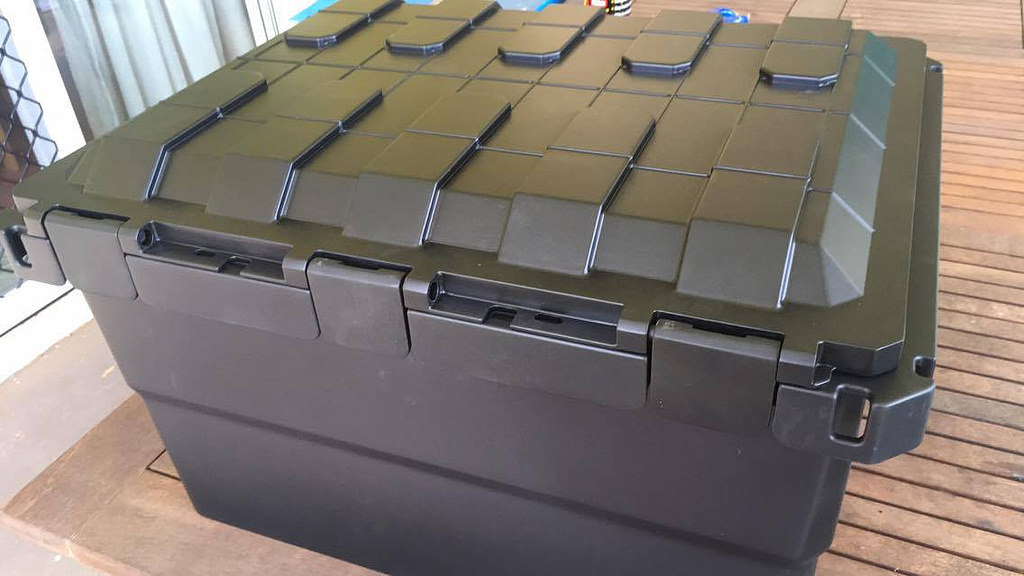

Well, day one of torture testing and we busted a hinge-pin! Back to the drawing board on the hinge for a bit then try again.
Still, happy with a lot of the other features and it is a nice smooth interior like we wanted. The grips also are nice and comfortable and the latches work great, so not all bad news. Just a bit more work to do yet.

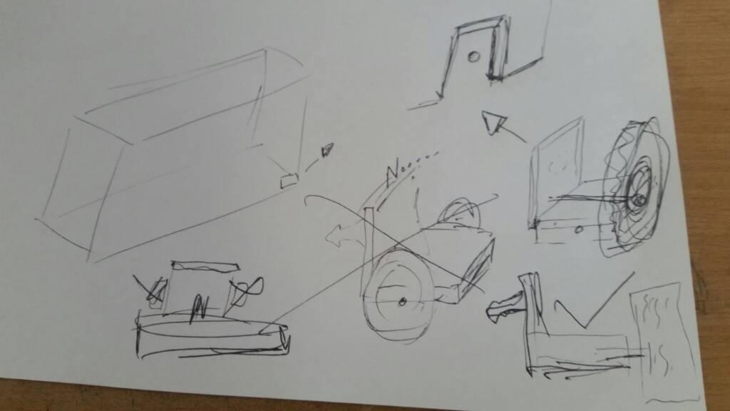

Cheers mate. We are looking at an option to attach wheels but don't want to build them into the box as it takes up too much room. I just carried the thing from Cairns to Brisbane via the airport system and it is also pretty handy as a Patrol Box, but would really benefit from a screw on handle/frame/wheels arrangement. Getting there slowly...
FNQGU for the wheels maybe solid wheels on a axlesetup like the old sack trollie and the back or handle could consentenor the sections being the same size as your boxes so as to use the holes at the corners or the boxes to lock the cart against upside down to get the wheels out of the way . Pretty hard to explain on paper I'm more hands on sort of bloke .
Design a 'clip on' Wheel and Handle accessory that can be purchased separately sama sama tie downs, racks, joining clamps etc. as prev mentioned on other pages.
More money in it for you and you don't have to have different boxes IE one with wheels and one without
Um.....this sort ofhttp://www.nissanpatrol.com.au/forum...2017/08/63.jpg
Plenty of food for thought there. There are a number of design limitations when using injection moulds (due to the way the moulds work) but if wheels and handle things are important enough then no doubt there is a way.

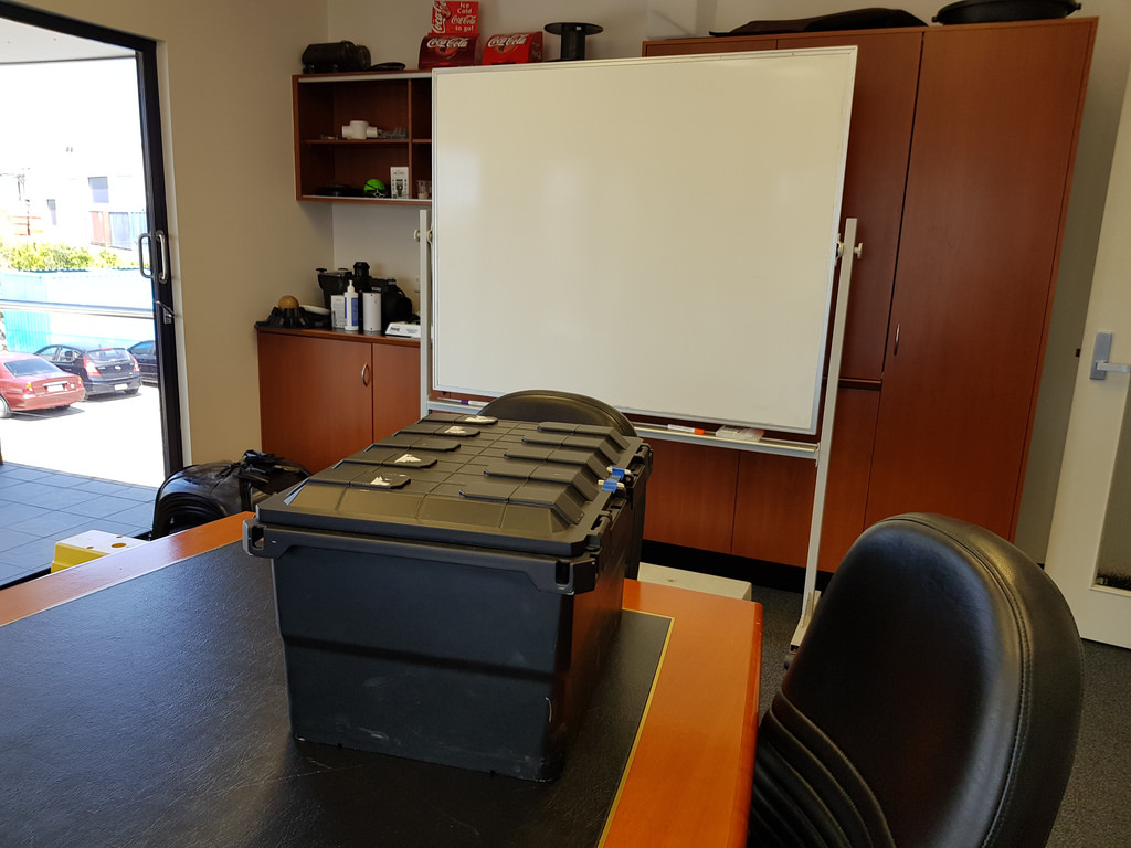

Well, a few final last tweaks are underway to the design prior to ordering the expensive injection moulds.
Yesterday we got it into a boardroom of a major company where much was discussed regarding distribution with our intent of keeping the price as low as we can.
Seems like we can go via the BCF/SuperCheap Auto/Rays Outdoors/Anaconda etc. or try and hit up the big boys like ARB or Bunnings, or we can do it ourselves with like an online thing off our website. Or perhaps both!
We can also do a super duty version that would be tough as nails. Probably made with something like the reinforced nylon in MaxTrax, which of course would be more expensive to make, but might be wanted by a lot of people too.
Still yet to finalise pricing, but more and more certain we can do them around the $120-$140 mark, but a lot of the cost is freight or retail markups.
