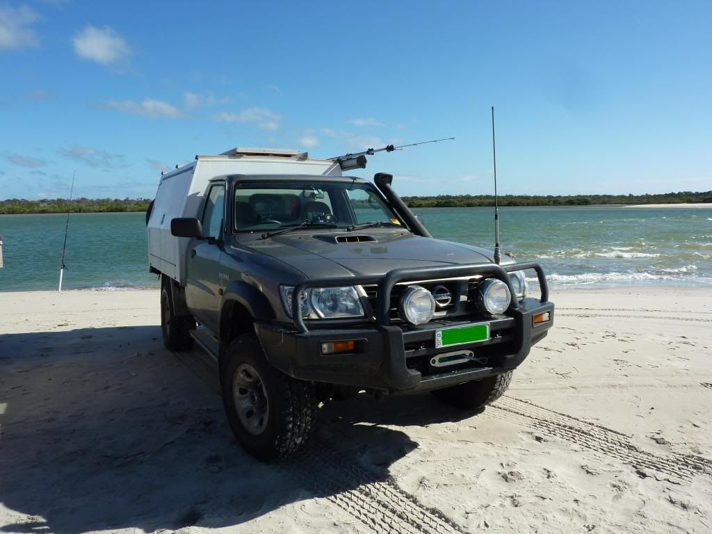

My wife commented on our last trip that the rubbish bin needed somewhere of it's own,
out of the way, where it wasn't taking up bench space. It was getting constantly moved, making it a
real pain.
This is what evolved from that comment.
It clips on and off the fold down shelf and stores in the white tub to the left of the fridge.
So far, no problems.
http://i994.photobucket.com/albums/a...rumTrip039.jpg
The rig enjoying some time on the beach.
http://i994.photobucket.com/albums/a...rumTrip030.jpg
In good company.
