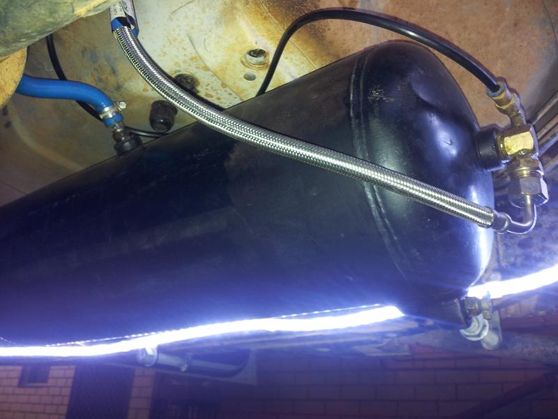

@ SD don't know your driving style but you think tank is OK for ramp over angle.
Love the led lighting, take it they are only led strip lights?

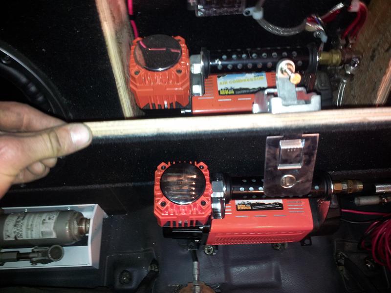

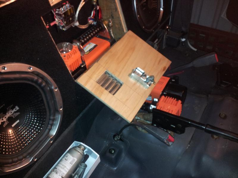

I'm always keeping an eye on my battery's. The compressors I am running are big and these two together are as good as my belt driven one in my workshop.
http://www.nissanpatrol.com.au/forum...2013/11/76.jpg
http://www.nissanpatrol.com.au/forum...2013/11/77.jpg

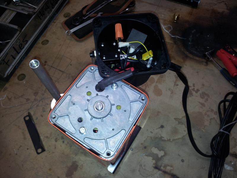

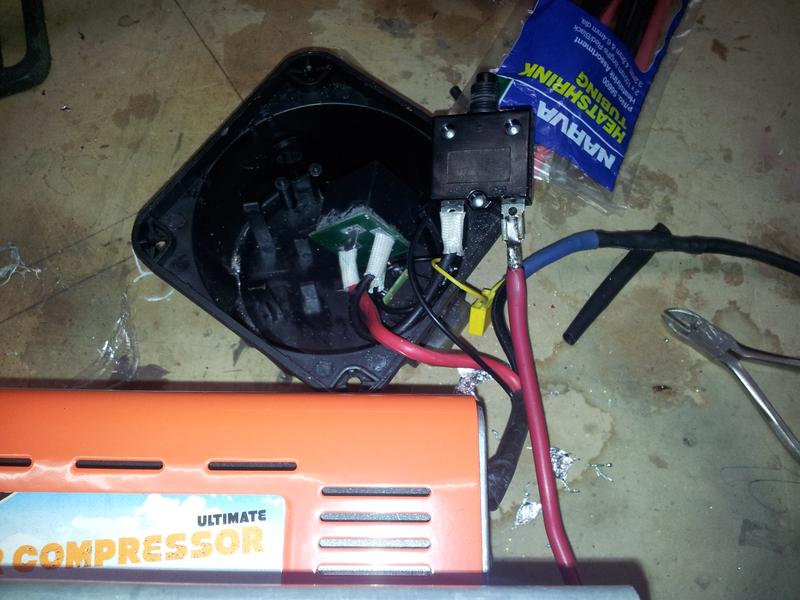

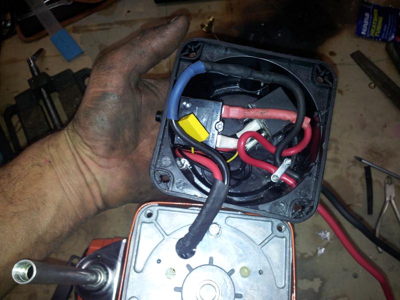

Re-wire begins,
http://www.nissanpatrol.com.au/forum...2013/11/79.jpg
I solider heat shrink everything,
http://www.nissanpatrol.com.au/forum...2013/11/80.jpg

Hi SD. Did you made provision for airflow? My compressor gets quite hot.

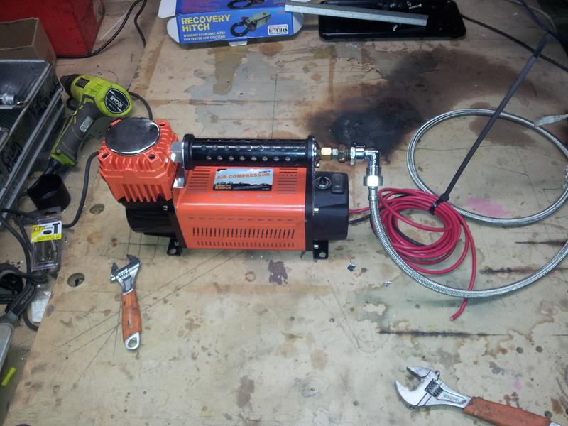

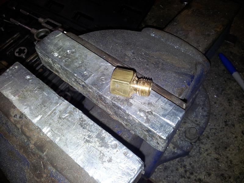

Can I ask what fitting you started with to put into the end of the compressor? I'm guessing 1/4 bsp? Then what did you cut it to, to get it to fit?
I'm trying to do something similar and put a pressure valve off a tee piece and couldn't find anything to fit. Grr
Thank you
Mick
@ Srex idealy you want a non return valve and may be an air manifold to fit the pressure valve to
Cheers mate, I have seen the manifolds but only in npt. I need to be able to get out of the compressor first, either npt or bsp to be able to attach one. I've already been to a couple of fitting shops including Enzed and it's not a common thread which is annoying.

@ strex I think looking at the compressor they have used a bolt thread from the head through the handle to
the nitto fitting,,,,, either 10mm x 1.25 or 8mm x 1.25,,,,,,,,, Sounds right to me.
Are you mounting it as well ,if so Id remove the handle, but thats just me.lol
