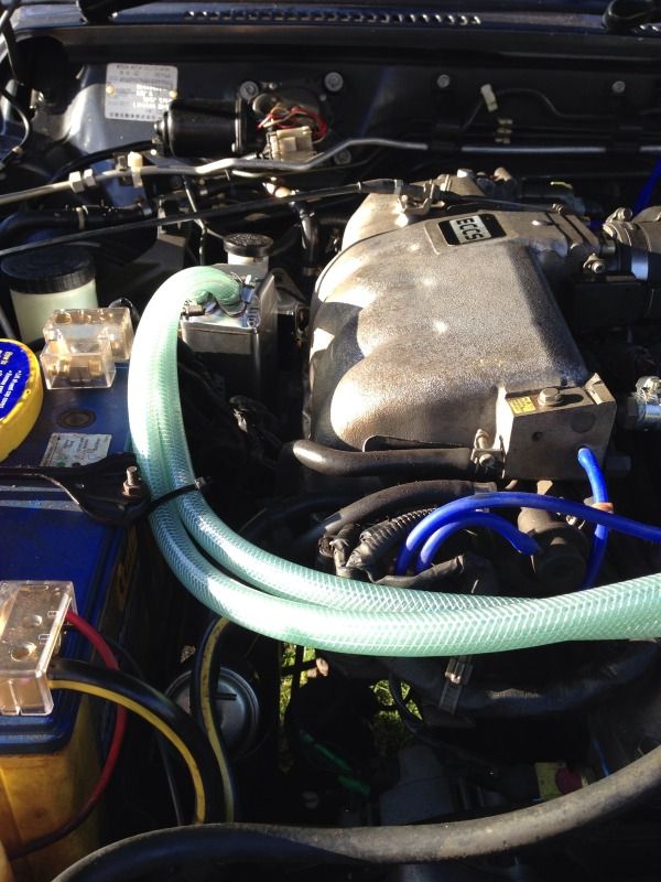

Lots done on the patrol lately. Might be doubling up here but I'll list the latest additions. Rear spring hats are now reinforced with the superior engineering kit, have installed remote central locking/alarm, new 9" spotlights, 50w led brake headlights, ditched the rtc damper and have just a regular damper now. Much better steering feel IMO. Catch can installed, oil cooler re-sealed, new copper/brass adrad radiator, body mounts replaced and lots more I can't remember.

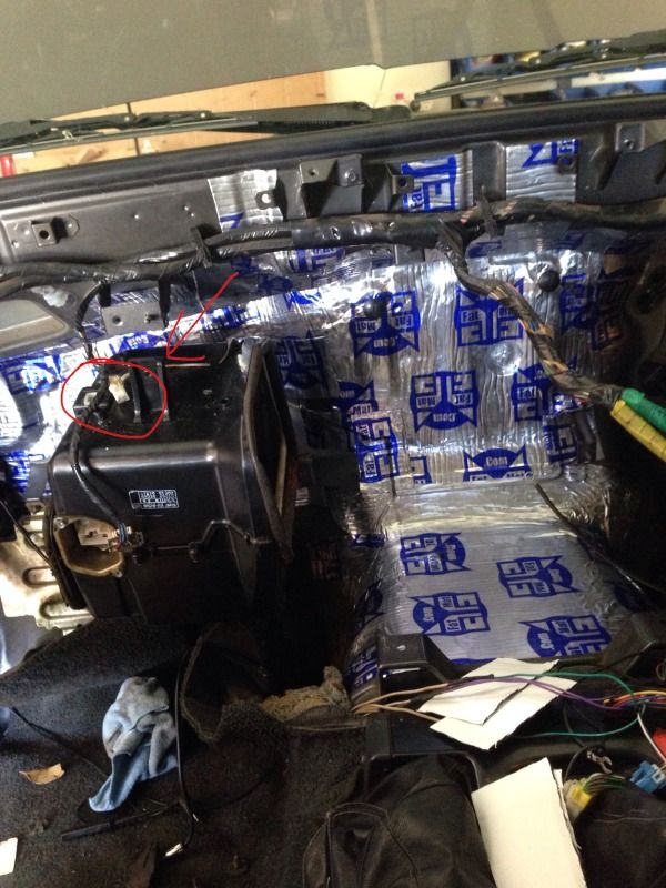

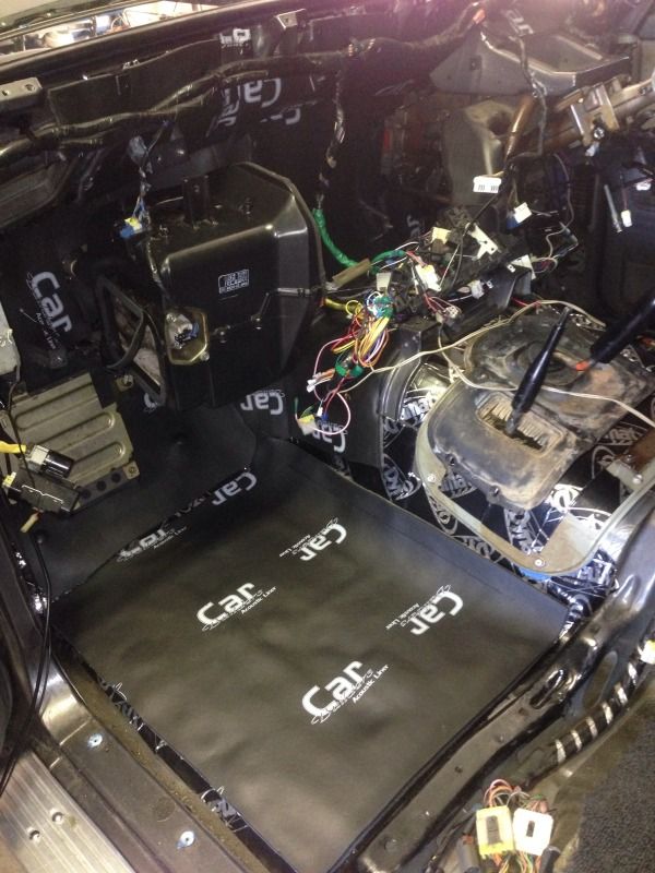

Has been a busy day today, removed all the dash last night and proceeded today by removing all the cracked ceramic insulation and installing fatmat insulation.
Dash removal
http://img.photobucket.com/albums/v9...ps24942422.jpg
http://img.photobucket.com/albums/v9...ps2d94a186.jpg

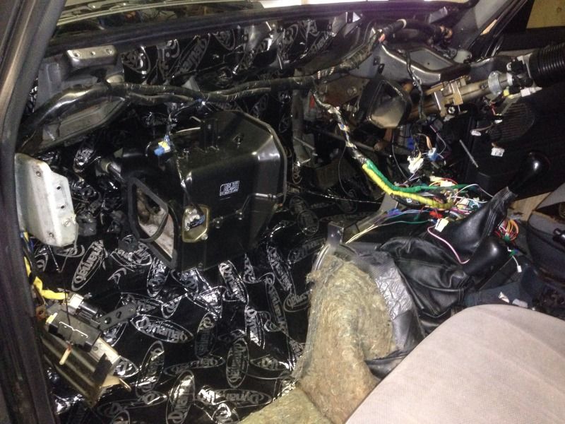

Heater core removed. I left the aircon hooked up for obvious reasons, but the unit was unbolted so I could work behind it fairly easily.
http://img.photobucket.com/albums/v9...ps3698bb85.jpg
Getting there...
http://img.photobucket.com/albums/v9...psb11b8fe0.jpg
http://img.photobucket.com/albums/v9...ps6a682647.jpg

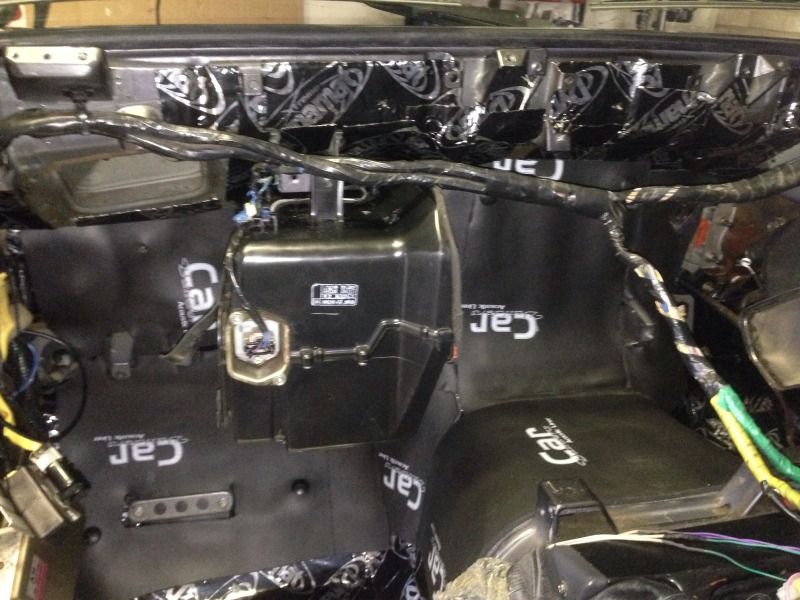

And the nightmare begins putting it all back together again...
http://img.photobucket.com/albums/v9...ps1eb47dd0.jpg
http://img.photobucket.com/albums/v9...ps0165859c.jpg
But all completed now and I can't believe that I had no screws left over. Happy days! Was also a good opportunity to clean all the ducting and aircon/heater core.
The difference in sound level is night and day. Vast improvement over the old setup. Will stock up on more of this fatmat and do the rest of the truck.

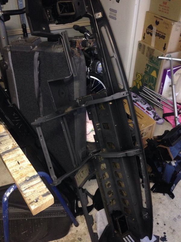

Hey mudnut, what I've just found out is the actual dash assembly needs attention because it is a big source of noise. After all my efforts, there is still an annoying rattle which is coming from the dash, not behind it. I plan to install more fatmat to the inside of the dash to hopefully remove this noise, but I did manage to get rid of most annoying noises. But next time you're in your car, give the flat section of the dash a sharp hit with your clench fist. Hopefully this is the sound you're hearing, if not, you might have to remove the dash to find it. I noticed that the ducting mounts like to crack at the screw holes. Also on my gq ontop of the aircon radiator, there is an electrical plug that seems loose, even though it's connected. This made what seemed to be one of the annoying sounds when I wobbled it, so I just put a fillet of sealant around it to stop it vibrating.

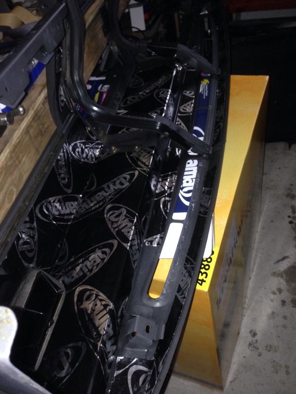

Have removed the dash again and removed the fatmat. Am very disappointed with this product. Have read posts of people using it in the US and in the heat the stuff just drips down the panels and becomes a horrible mess. Well I used a hair dryer to remove the stuff and sure enough it is not stable in heat what so ever. It just became a sticky gooey mess. But it's all gone now and am in the process of installing dynamat.

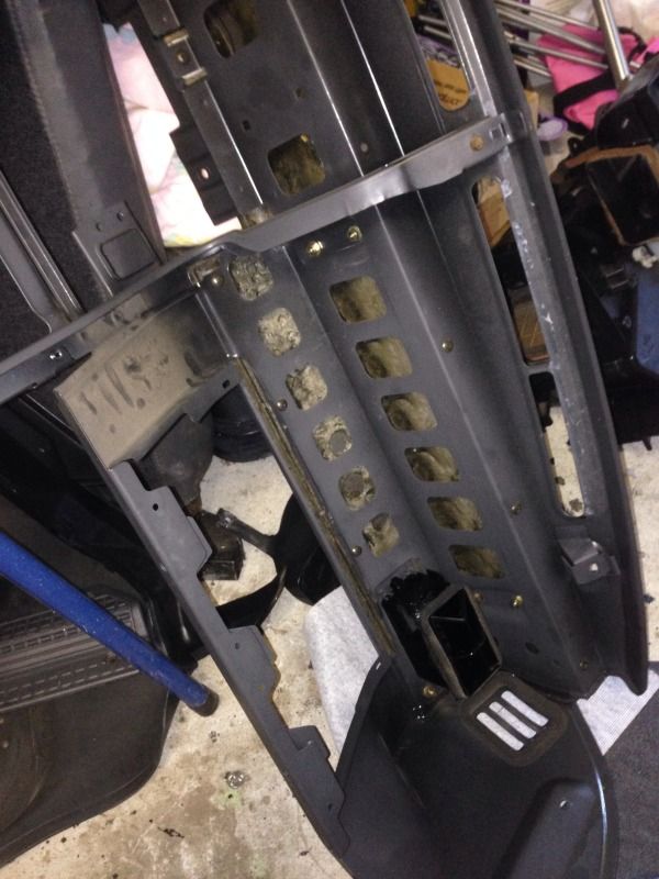

I took a photo of the dash assembly to show how it's constructed. It's basically a steel frame with padding on the top. The frame does vibrate and flex a lot when tapping it from the inside so I will be dynamating the inside of the dash.
http://img.photobucket.com/albums/v9...ps929541f1.jpg
http://img.photobucket.com/albums/v9...psa0e3570a.jpg
http://img.photobucket.com/albums/v9...ps9b90628c.jpg

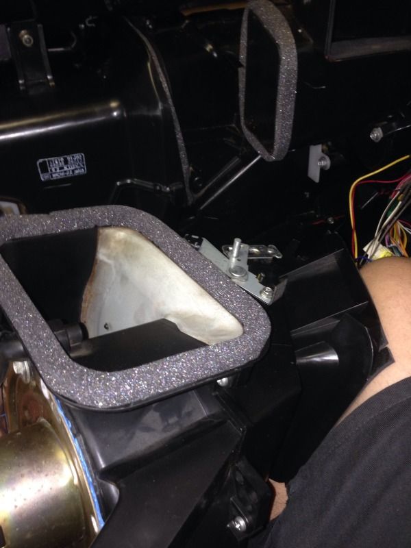

Putting it all back together again. Good opportunity to put new foam on the ducting as the old foam was non existent.
http://img.photobucket.com/albums/v9...ps50f70f0c.jpg

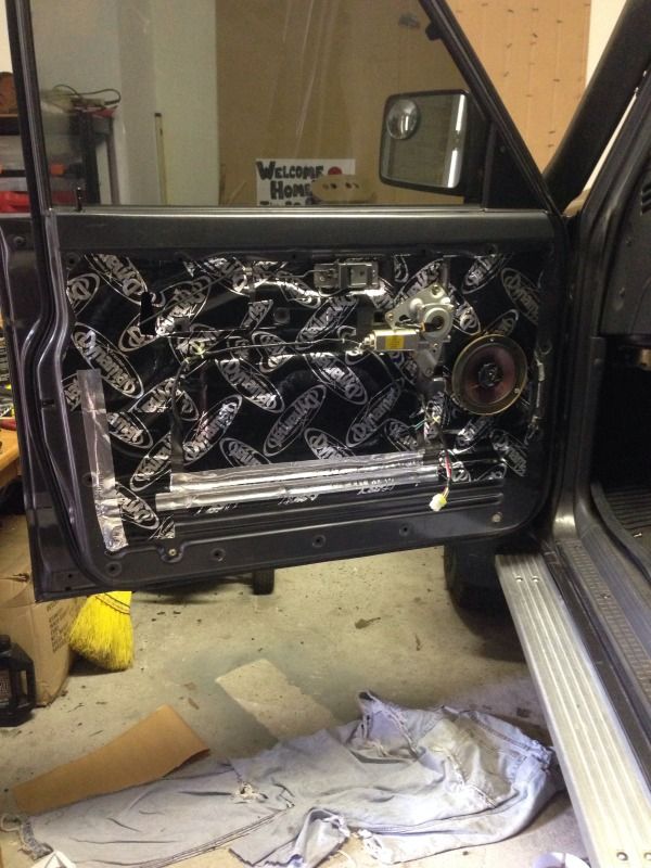

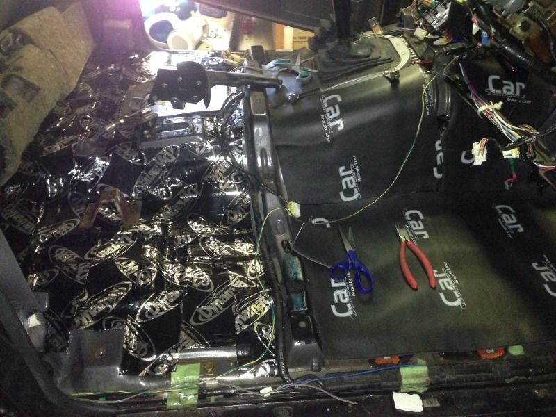

Front passenger door done and also the rear door insides have also been done.
http://img.photobucket.com/albums/v9...ps51a519af.jpg
@ Parksy did you only apply to plastic on door not the door skin itself
