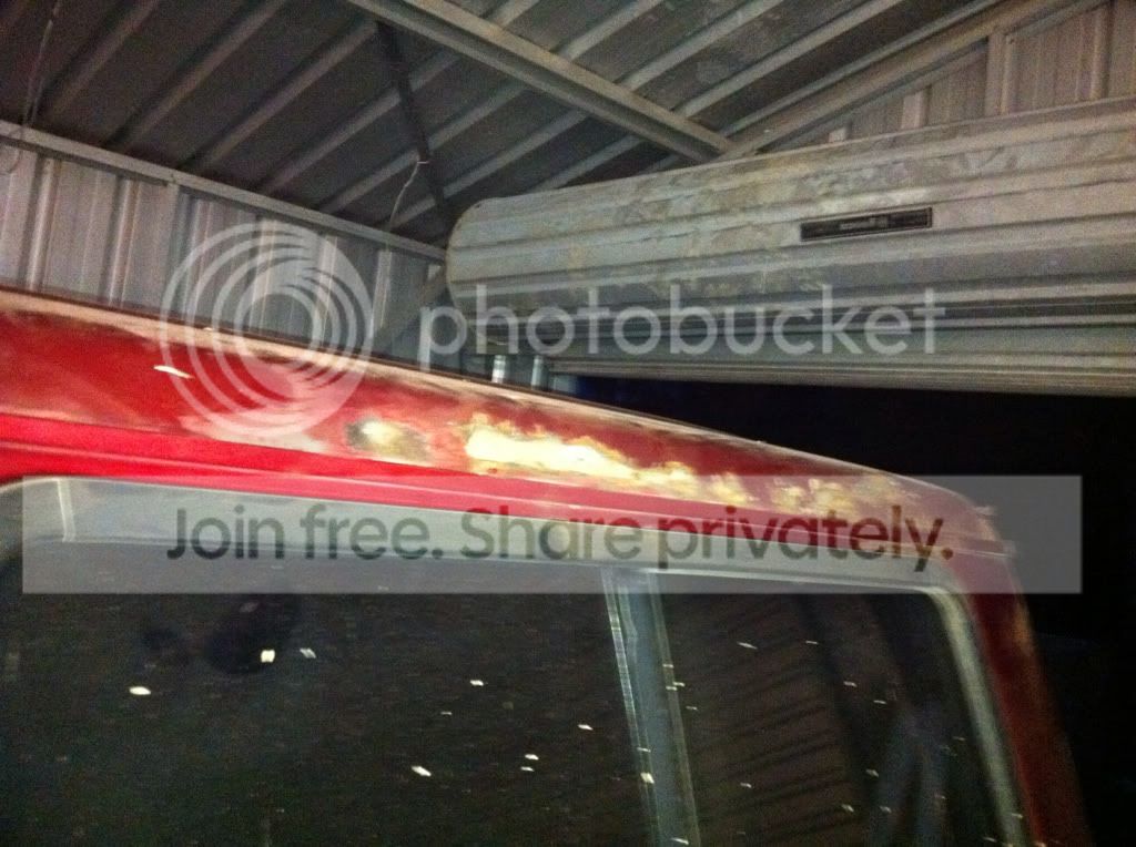

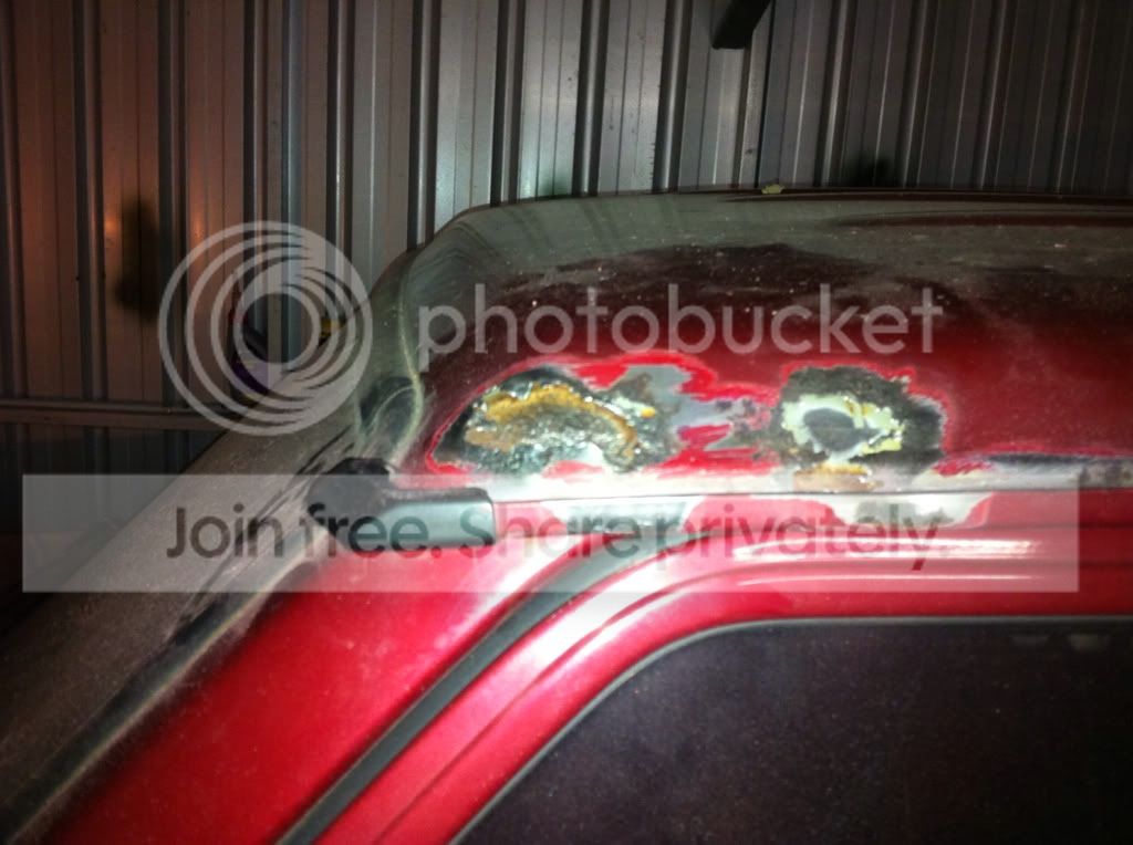

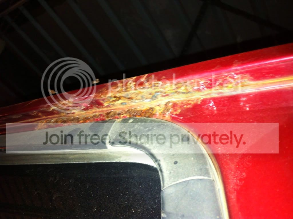

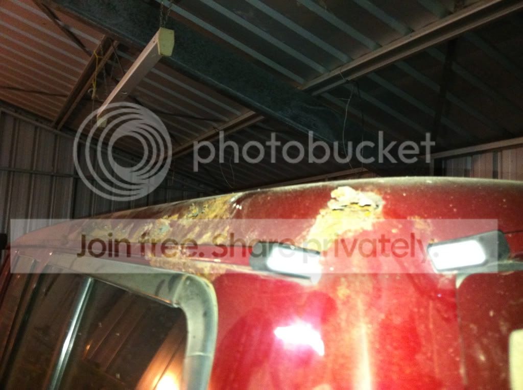

got to work on the gutter rust in the wagon lastnight to see how bad it is... and its bloody bad hahaha. Went out and got a stack of cutting disks so i can start chopping her up tonight. Will be cutting all the rust effected areas off and then plating and fibreglass bogging to get a good finish.
All going well you should not know ive been at it with the grinder when im done.
Here is a few shots of one of the sides once i hit it with the wire wheel to see how bad it was. Other side is just as bad if not worse.

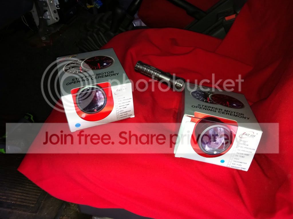

just bought this off ebay http://cgi.ebay.com.au/ws/eBayISAPI....m=130604162838 and a boost guage aswell. They seem to be good kit and are on specialat the moment, got the boost for 65 and the EGT for 120. Bargain. Now ive just got to suss out how to install em and then the boost will be jacked up.

Bloody good price for the gauges too. I just did mine a few months back and It's an easy job mate but just ask any questions if you get stuck.

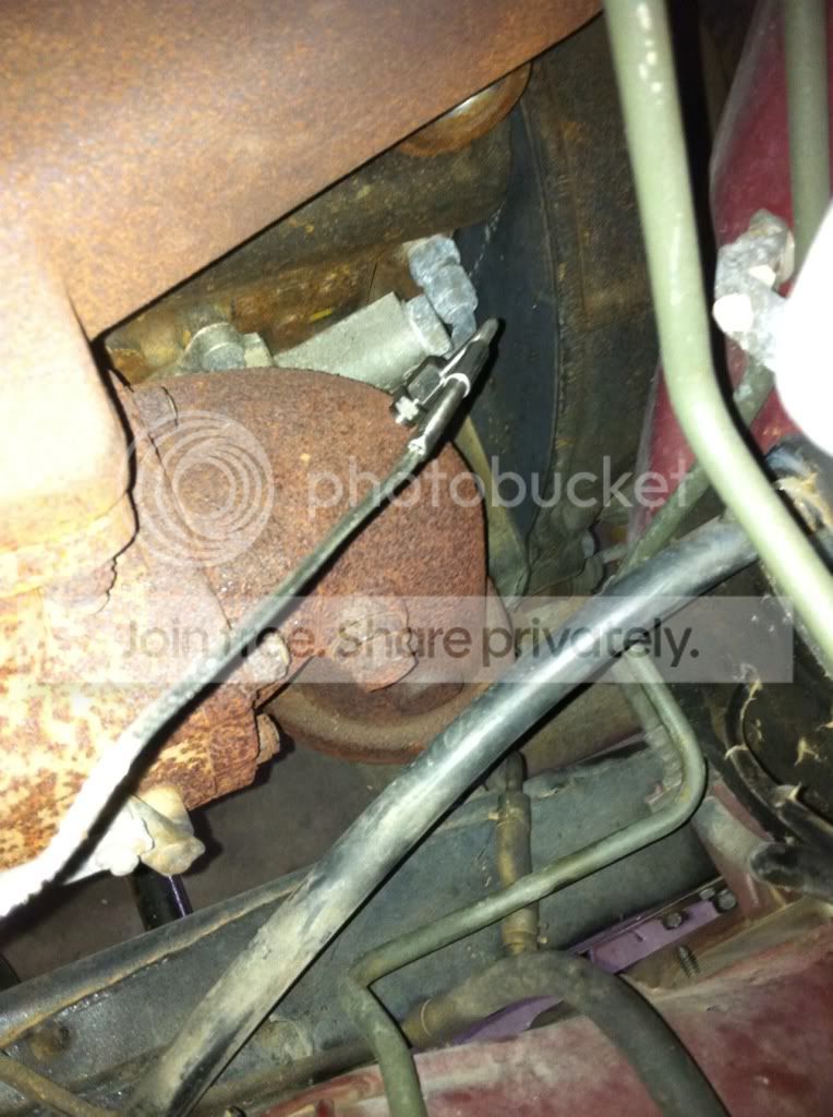

First of all i hooked up the EGT sender to the dump pipe. Luckily the bolt came right out with no problems and i just wacked it in.

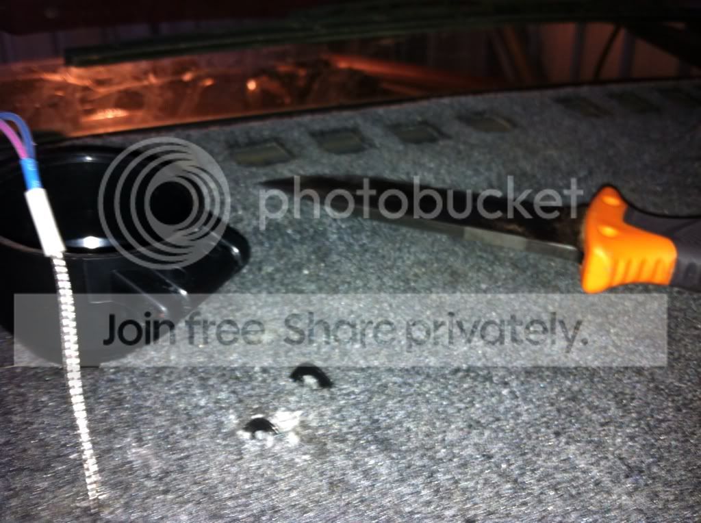

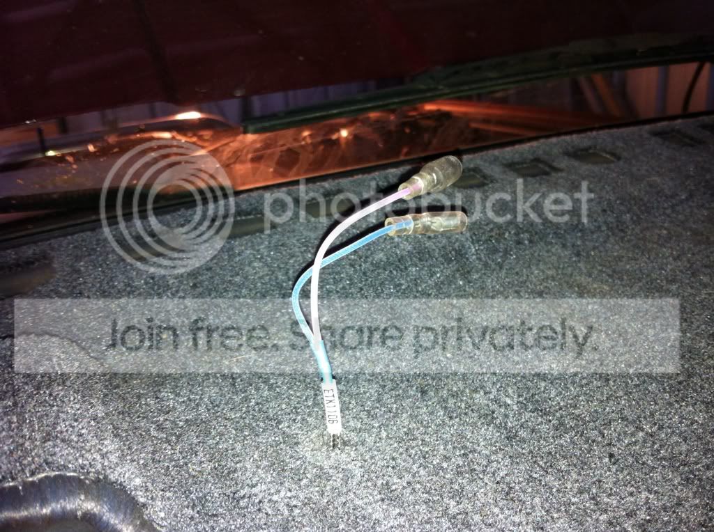

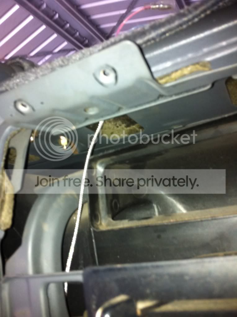

Then i drilled a hole in the dash through the dash mat so i could feed the wires right up to the guages and have the wires come out the base of the cups. If you do this make sure you go around the air con vents and not through like i allmost did lol.

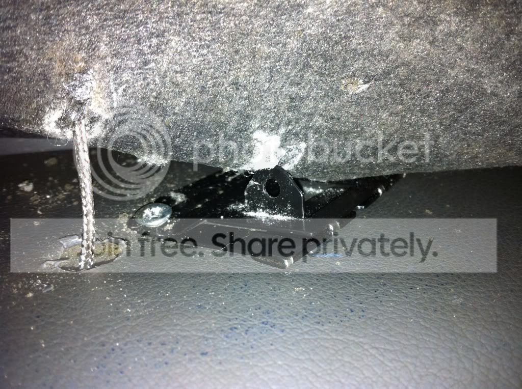

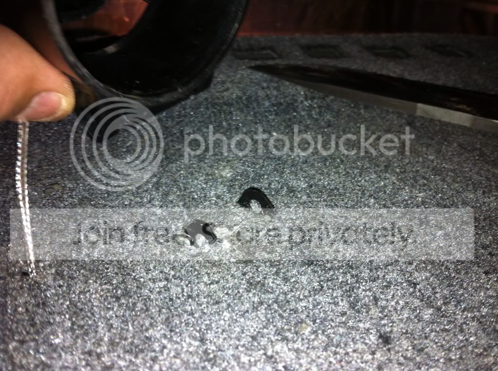

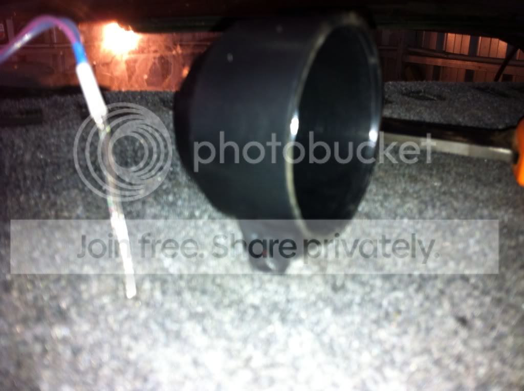

Then mounted the mounts under the carpet to conceal the cup base and cut the grooves for the mounts to poke through.
