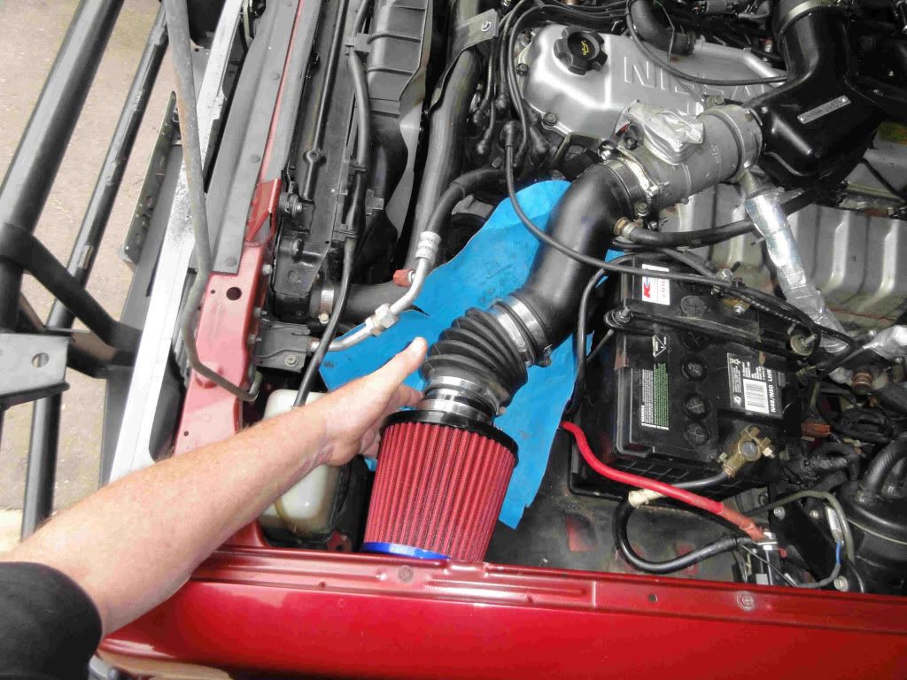

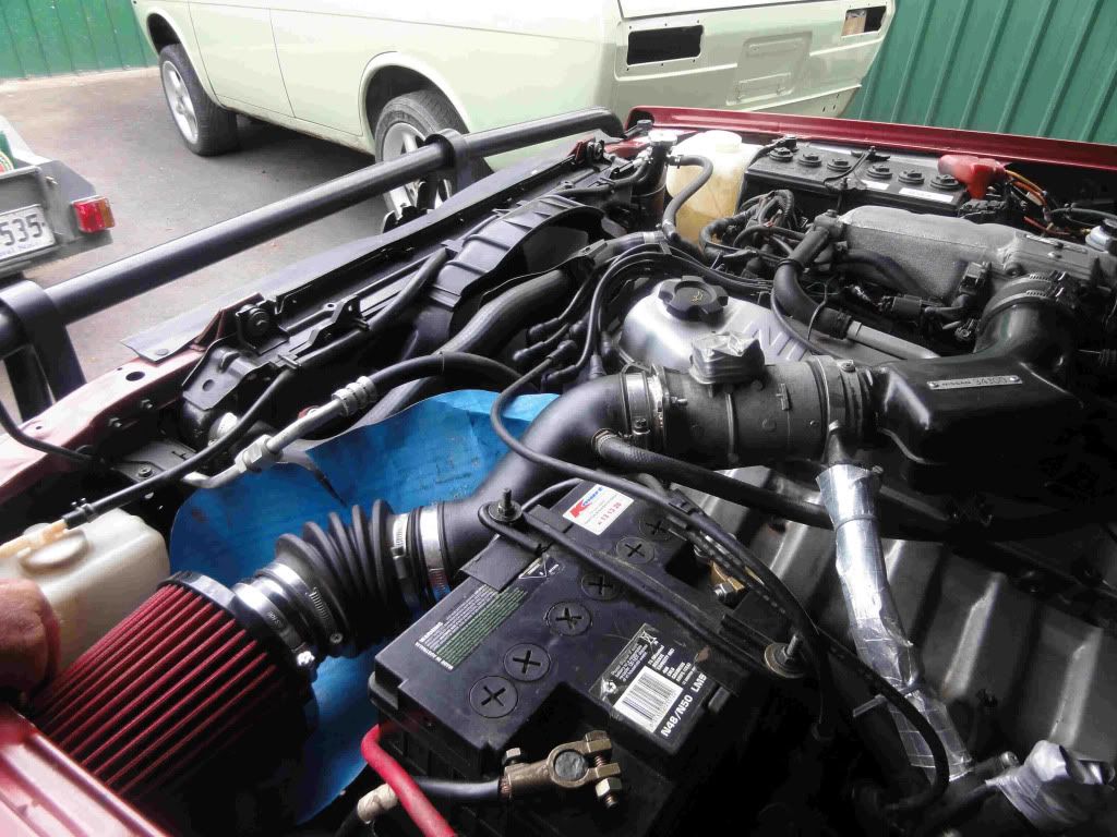

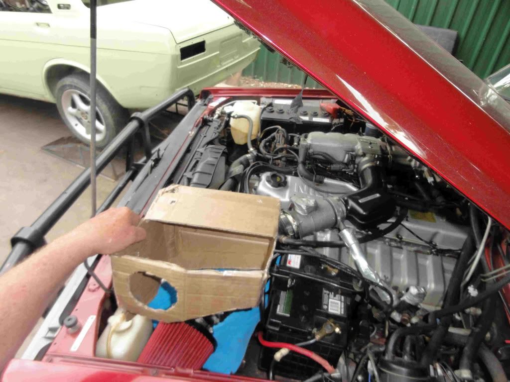

I have GQ with EFI and LPG and of course my airbox has gone to the happy hunting grounds, I too am working on a fix. running a pod aircleaner temporary but working on an alloy box. Making a cardboard template right now, Ive got a tig so lets give it a go. I dont appear to have the room for the A360 filter so I am looking at boxing the pod. Once thats done maybe a snorkel........
I am looking for cooler air as my gq seems to lose power on gas when the weather get hot.
posting a few pics...........if all goes according to plan

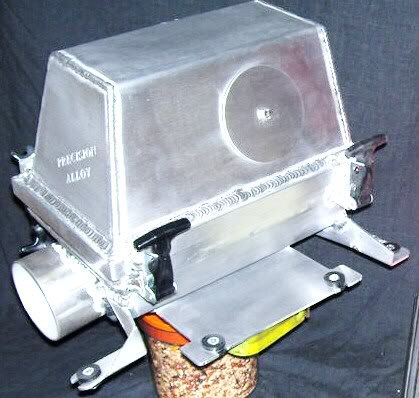

Air box available on EBAY, its got a pressure relief valve...........still going to scare the beejabbers out of you though, I think I need to contact MYTHBUSTERS in SAN FRAN to test it out

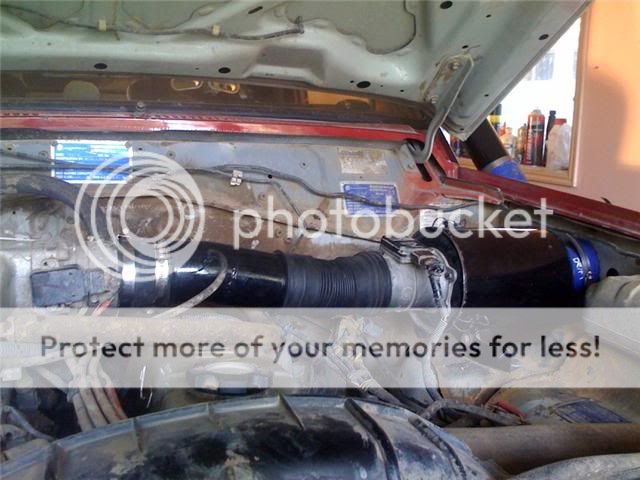

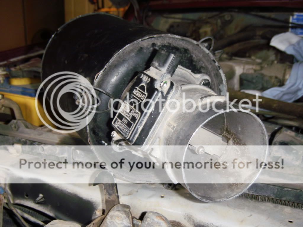

dont mean to hijack but i did this on my 4.2 a while ago using a range rover discovery V8 airbox and a custom bracket. Needed something this big so i could run a 3inch intake and outlet for more airflow. Does the job well.
http://i400.photobucket.com/albums/p...8/P7070033.jpg
http://i400.photobucket.com/albums/p.../induction.jpg
http://i400.photobucket.com/albums/p...8/P7080002.jpg
Thought someone may find it usefull.
