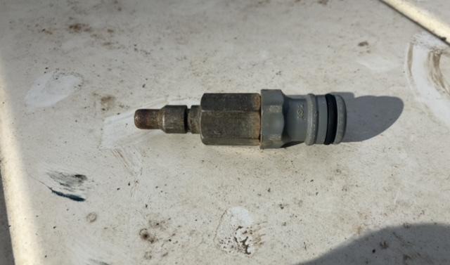

 Here’s the world’s best radiator & a/c condenser cleaning nozzle everer [emoji23]
 http://www.nissanpatrol.com.au/forum...2022/10/73.jpg
 Runs a high volume stream the width of our cores targeted and be careful not to over crank the garden hose and bend fins.
 Every glovebox should have one, especially after the likes of Balfour Tk - Tassie [emoji23]

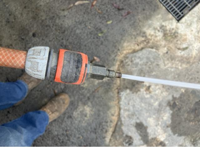

 http://www.nissanpatrol.com.au/forum...2022/10/74.jpg
		I think the trick to be gentle with the fins is to hit the water head on. If you hit is sideways or up/down direction, your're prone to bend'em.
 Oh, and for when it has some fins already bent, there is a tool called radiator comb.
		Perpendicular ALWAYS Brother BZ Mate [emoji106][emoji106]
 Treat our radiators after sludge much like an old school printer….jehjehjehgrrrrr [emoji23][emoji23]
