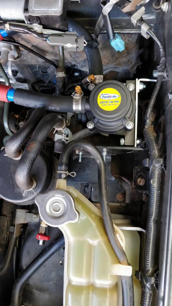

Couple of more (Use FMIC these days):
1. As mentioned, used same existing vert brkt adjacent to ABS but located CC fwd next to aux battery (Current CC install position is where large rotary switch is shown).
2. With large JT cooler (same as CC ultimate cooler), installed CC under Fabwitz Airbox outlet pipe_would have been better to have place it at the current location. Rotary switch was problem then. Not prefered but have spare brkt for this.
