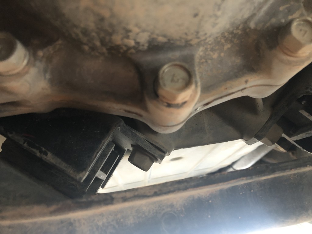

Mine had the original factory fluid in it when I first discovered the leak while doing the 40k service. I drained 5 litres from the auto and topped it up with Castrol Transmax Multi-vehicle, and I also used the same Castrol fluid when I changed the transfer case fluid at the same time. Mine has no visible leak now as shown in the below pic, so I guess it's possible the old fluid was getting a bit thin in the transfer case?
http://www.nissanpatrol.com.au/forum...2019/09/38.jpg
