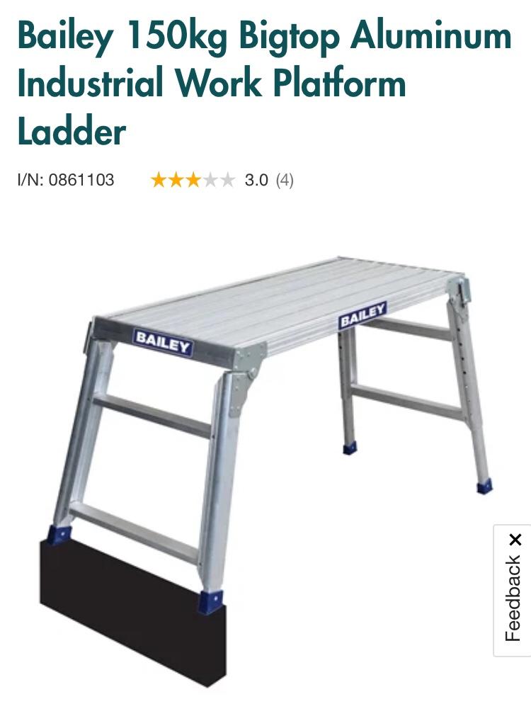

Once watched a Stubborn Legend with a seriously buggered hip load all of his family’s touring lightweight gear up top off a simple 8kg thingo similar to this:
http://www.nissanpatrol.com.au/forum...2020/12/83.jpg
Think it was smartly/quickly mounted to his steel aftermarket tyre/jerry can rear bar swing arms but also doubled as a a table family cooker station table under their awning, one less table to carry[emoji106][emoji106]
