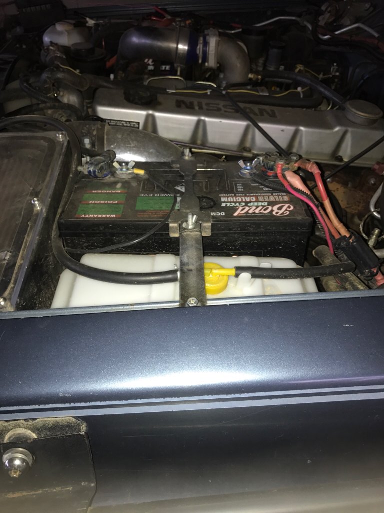

I would say this is only relevant if you have been dicking around with the cap recently. If not then its something else.
@AB, whats the correct orientation of the overflow cap - is there an in and out which suggests a check valve of some description? If this has not chan ged, then pointing toward the radiator cap?
I'm not sure about zd30's mate but the td42 overflow which surely is similar to that is long side down on inlet side and short side on external.
Liquid goes in, long side sucks back into radiator, short side exerts coolant if bottle is full.
http://www.nissanpatrol.com.au/forum...017/11/189.jpg
I'm too lazy to take off brace.
Long side left, when cool, sucks back into system.
I’ll take a picture of mine when I get the chance but I really wanna get this sorted out.

I have a ZD30 the orientation for the rad caps is the pressure cap goes on the overflow bottle near the guard
n the normal cap goes on the radiator . Hope that helps
