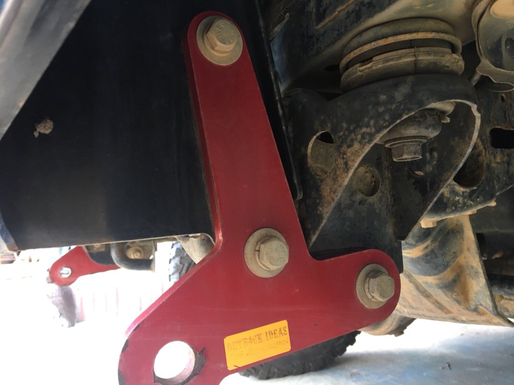

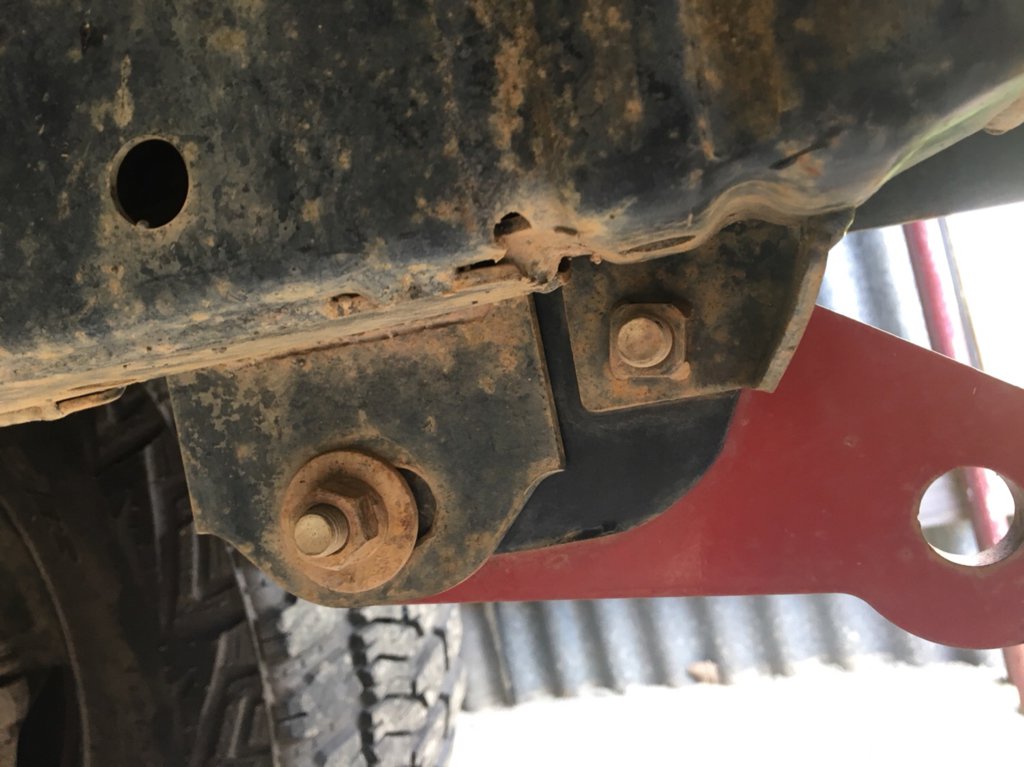

Thanks for all the input guys. I saw John's "T" shaped ones but my bullbar has a flange/folded section of metal that runs vertically along the the bullbar mount (left of the mounting holes (yellow arrows) in the picture I posted) so I think that might get in the way. Not sure about grinding a bit out of that in terms of structural rigidity for the bar? I'll try post a photo when I get a chance..

Iron Man recovery points are the only ones I know of that will fit both sides on early GUs. The one on the passenger side comes with nuts that are welded to wires so they can be fitted from holes to the rear of the chassis and then engage with bolts that fit through one side of the left hand chassis only. No need to muck about with the end of the chassis rails. Talk to your nearest Iron Man rep.
