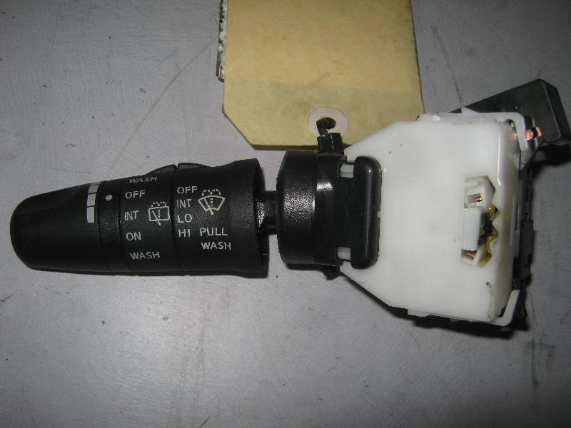

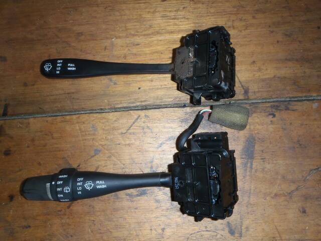

I know what a POT is TD, so I'm guessing yours isn't like the bottom on in this pic then (which is from a GU ST wagon), the top one is from a DX ute
http://www.nissanpatrol.com.au/forum...017/03/108.jpg
http://www.nissanpatrol.com.au/forum...017/03/109.jpg
Is yours like this? There is a step in them but if been used a lot the step isn't very noticeable.
It is only 3 speed though not 4 like is said before.
yep same one Winnie, just went out and had a feel, there's one very distinct step, the other quite faint so probably why I never really noticed it before, actually time it as well, slowest setting is 11sec, next step is 8, next is 5 and the end is 2 seconds (also timed between the positions and get the same times)....... makes me wonder if the RX was indeed the same then, but I had a round stalk on that one......... so now I understand what @threedogs is on about (for once hahahahaha). I can only presume that all Patrols variable wiper stalks are the same stepped type then.
So if the OP has no stepped variable wiper speed then I guess he has a DX stalk

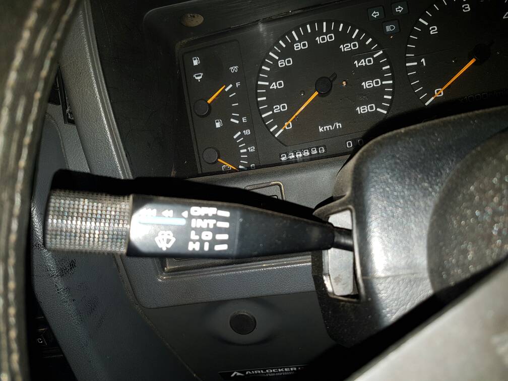

this is the other style for the GU I found
http://www.nissanpatrol.com.au/forum...017/03/110.jpg
@Clunk happy you now "get" me.lol lol
Mine is the same as the bottom stalk, GU ST
It's a 2015 GU Y61 ST. It has intermittent wipers but they are only at several preset switched intervals which I cannot change.
