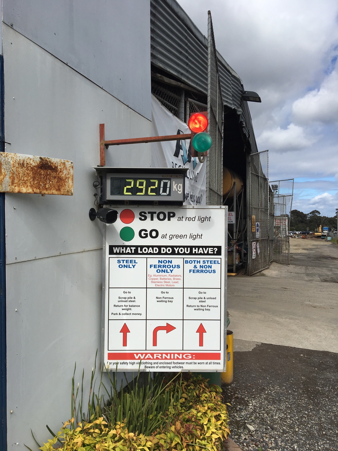

Bugger me, quick stop off check, back to the drawing board :-(
http://www.nissanpatrol.com.au/forum...2016/11/23.jpg
Yeah mate, they're certified, but if you're really nice a quick drive in/out may be negotiable ;-)
Was thinking coldstream tip would be a good one too to go over the scales. Might have to do it one day, be interested to see how much the camper is too.
Not sure if I'd trust their scales mate. Maybe better these days but years ago on multiple daily ute loads the difference was quite confusing to me!
