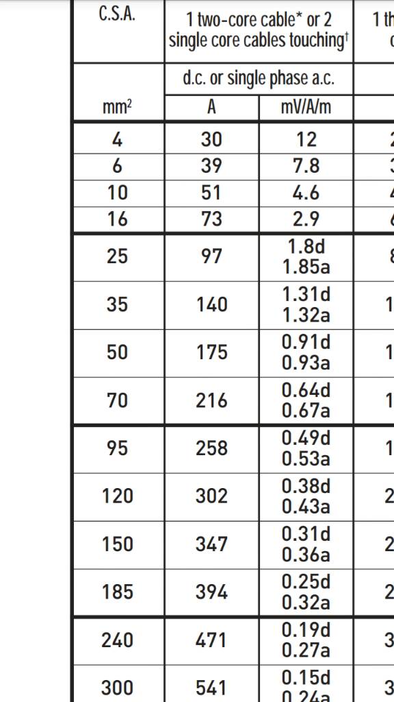

50mm is good for 500A.
30mm is a standard 400A earth lead..
Yep. At a minimum maybe 95mm2. 300mm2 is huge.
You can't really say that a cable is okay for a particular current, it depends on a lot of things.
I have sold 50mm cable that ran nothing but a 10A GPO.
Anyway, the cable supplied by the winch manufacturer will always be the bare minimum.
On powerlines we use 95mm2 as bare minium for 200A circuits, for wiring up transformers secondary voltage. Anything up to 185mm2 feeding 400A circuits. DC is probably different. And I'm sure there is also different grades of copper is there not.

Remember you are talking about Peak non continuos loads when spiking to 400amps. Warn supply smaller than 35mmsq on their new winches and see those kind of amps.
