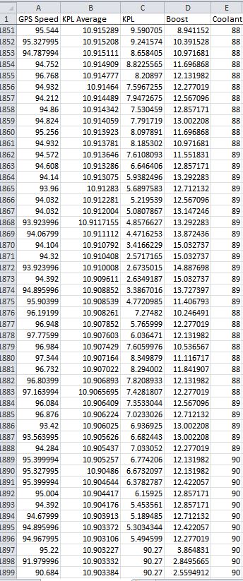

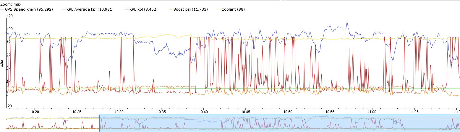

I dont have dawes and needle setup. What you could do is do some data logging to see whats the Boost is at when you hit that sudo limp mode.
Something like this would help.
http://www.nissanpatrol.com.au/forum...2015/10/24.jpg
http://www.nissanpatrol.com.au/forum...2015/10/25.jpg

that's some pretty impressive data logging. is that generated by the ECU and accessible by the scan tool?
