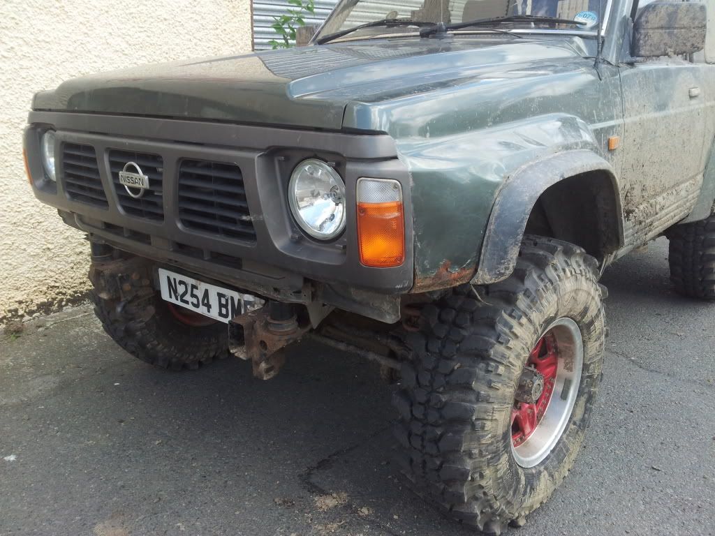

I had a bit of a misshap while "testing" the new suspension :SNruQWn369624407:
Managed to park the old girl right into a tank trap and bashed in the front panel and wing :oops:
http://i667.photobucket.com/albums/v...6-24161010.jpg

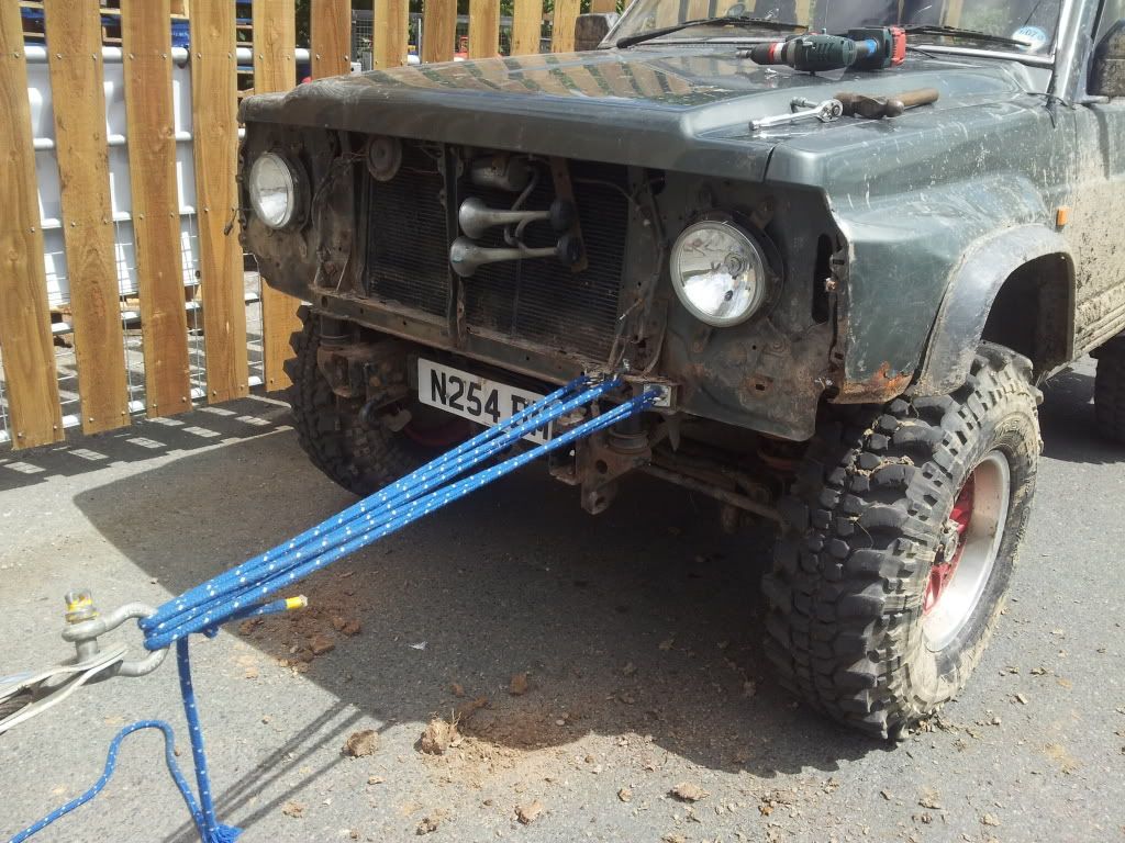

So this weekend me and my mate took his winch to my Trol's special eye.With the front panel off the extent of the damage was evident :redface:
http://i667.photobucket.com/albums/v...701_124611.jpg
A quick lace up with a bit of rope attached to 3 points where the front cross member was bent and then a snatch block and 8 tonnes of winch pull should do it :thumbup: Tied the back of the Trol to a gate post and engage winch man :devilred: Delivered a few well aimed blows with my friend Mr Hammer while under tension sorted things a treat.
http://i667.photobucket.com/albums/v...701_131405.jpg
And relax, all better, well enough till the next time :Yahoo!:
