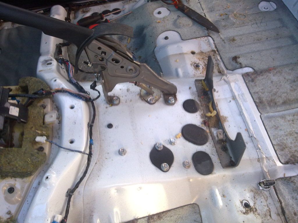

On your left seat you only need two bolt holes for the seat hinges. On the right hand side your bracket/adapter will have to include the bottom mount point for the seat belt .
Ok guys i ordered all the parts i need monday they are coing from FRG Racing $500 for all the back end less seats as i dont need them i alreay have a set. I will post up some pic later
The rear tie down points are the same as the rear seat points.

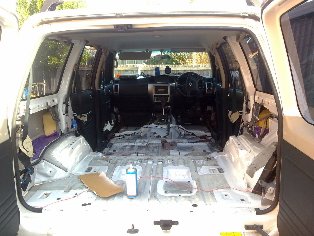

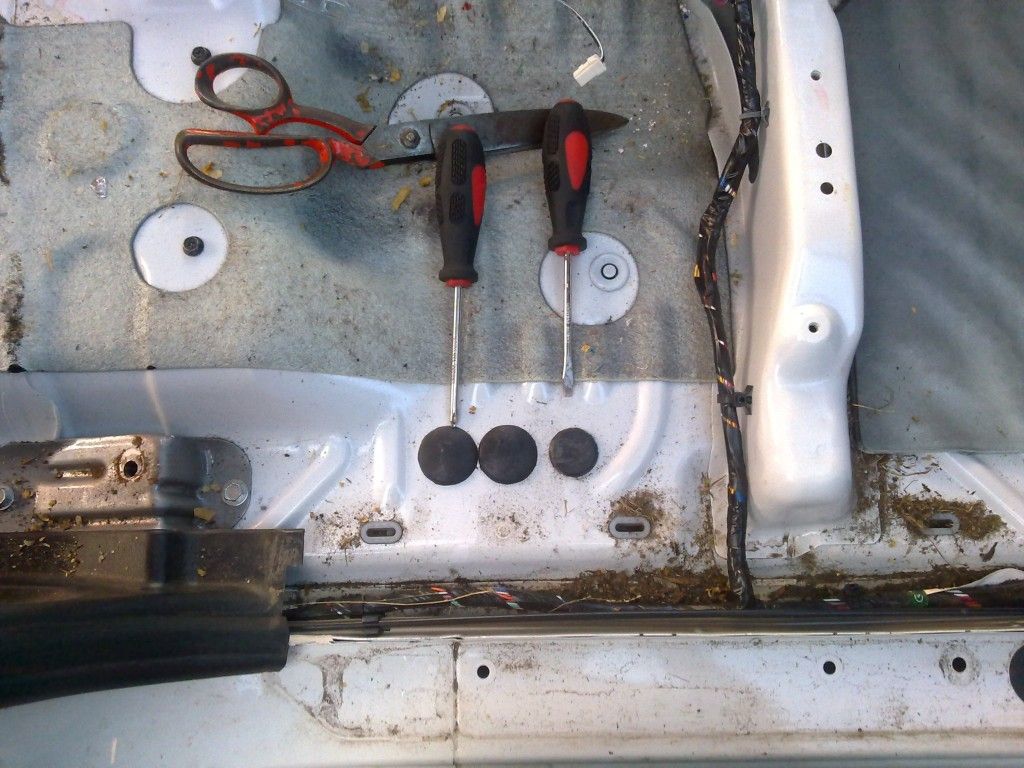

OK new updates for you all
I went out and brought every thing needed.
I had a friend weld in the seat mount with a Tig while i sat outside with a wet rag and put out the fires from the sound deading crap in the wheel arch
2X dickie seats
2x Hoops or Seat locking loops whatever you wish to call them
2x Seat belts
2x Plastic top trim
2x carpet bottom trim
2x Factory mounts
1x Right hand side seat belt bolt mount
Bolts to suit

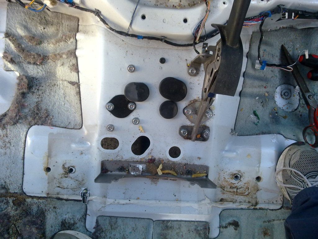

Left side seat mount
http://i193.photobucket.com/albums/z...1052012302.jpg

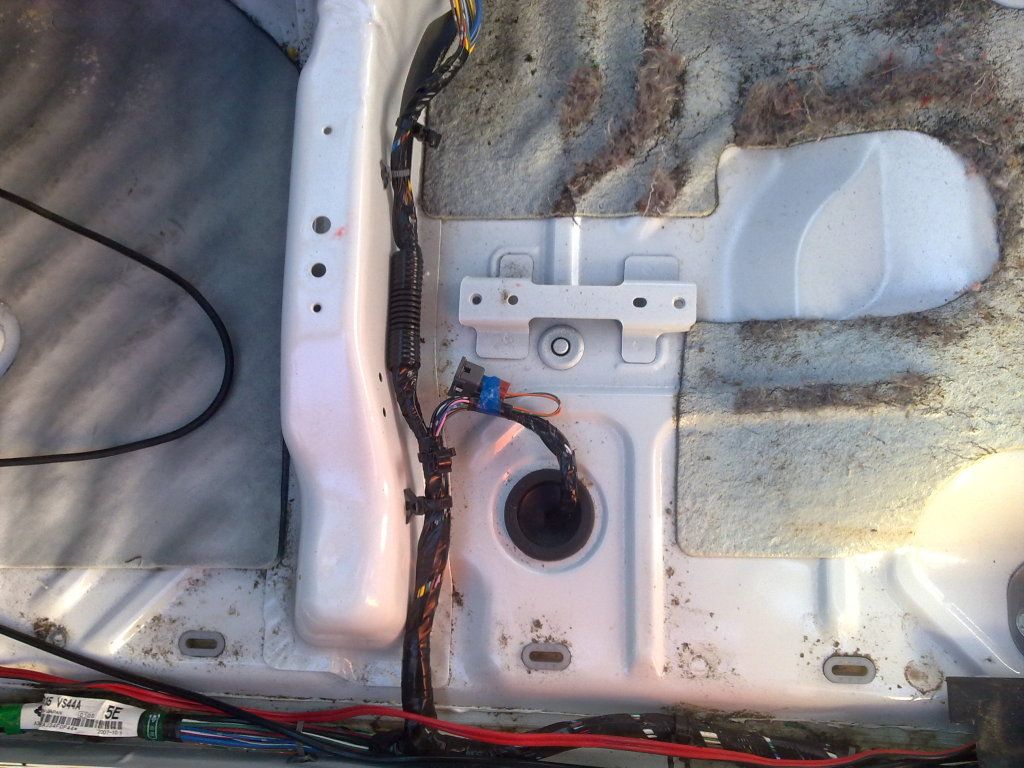

Right side seat mount & seat belt bolt mount
http://i193.photobucket.com/albums/z...1052012303.jpg

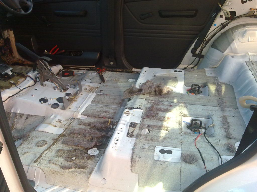

Rear of car
http://i193.photobucket.com/albums/z...1052012304.jpg

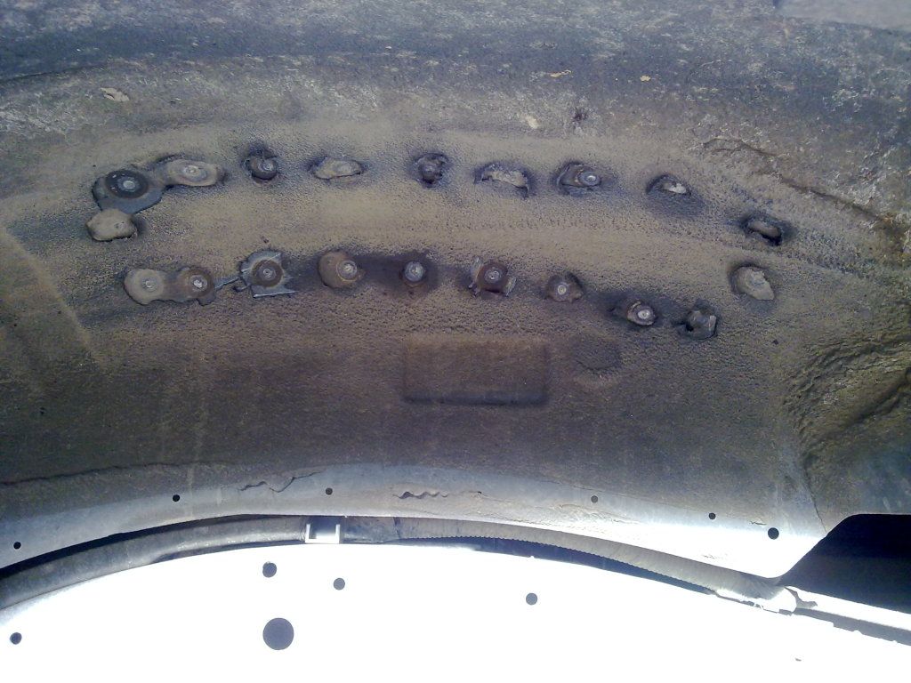

Left wheel arch Weld
http://i193.photobucket.com/albums/z...1052012307.jpg

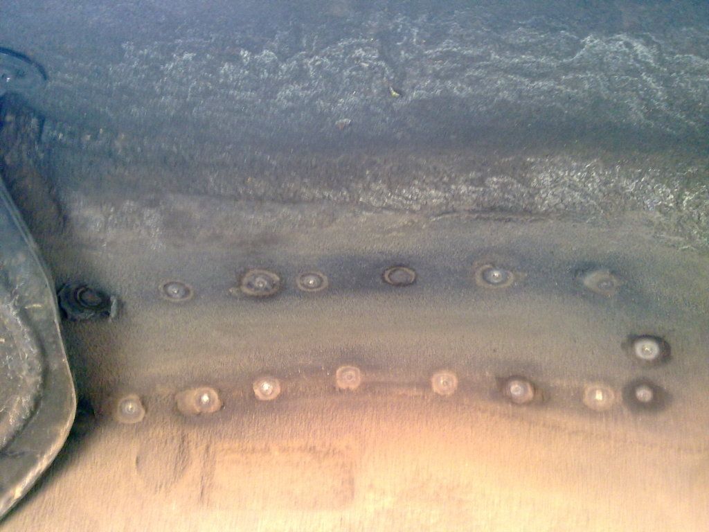

Right wheel arch Weld NOTE Make sure to remove the plastic cover before welding. This covers fuel filler hoses seen left of picture
http://i193.photobucket.com/albums/z...1052012306.jpg

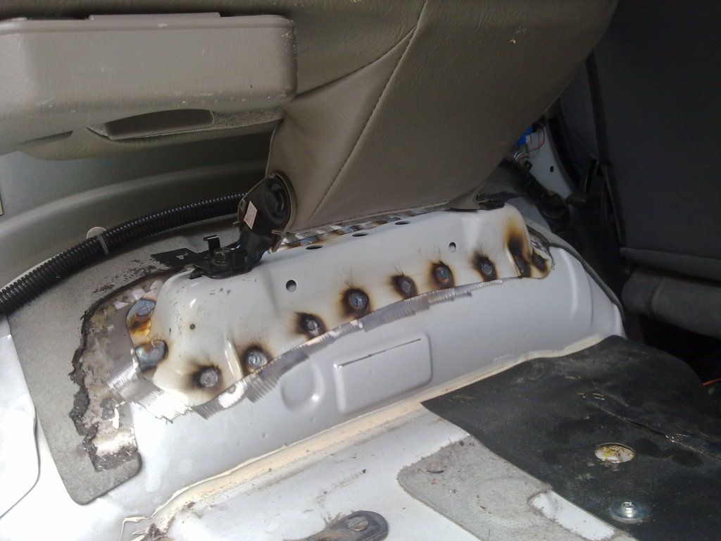

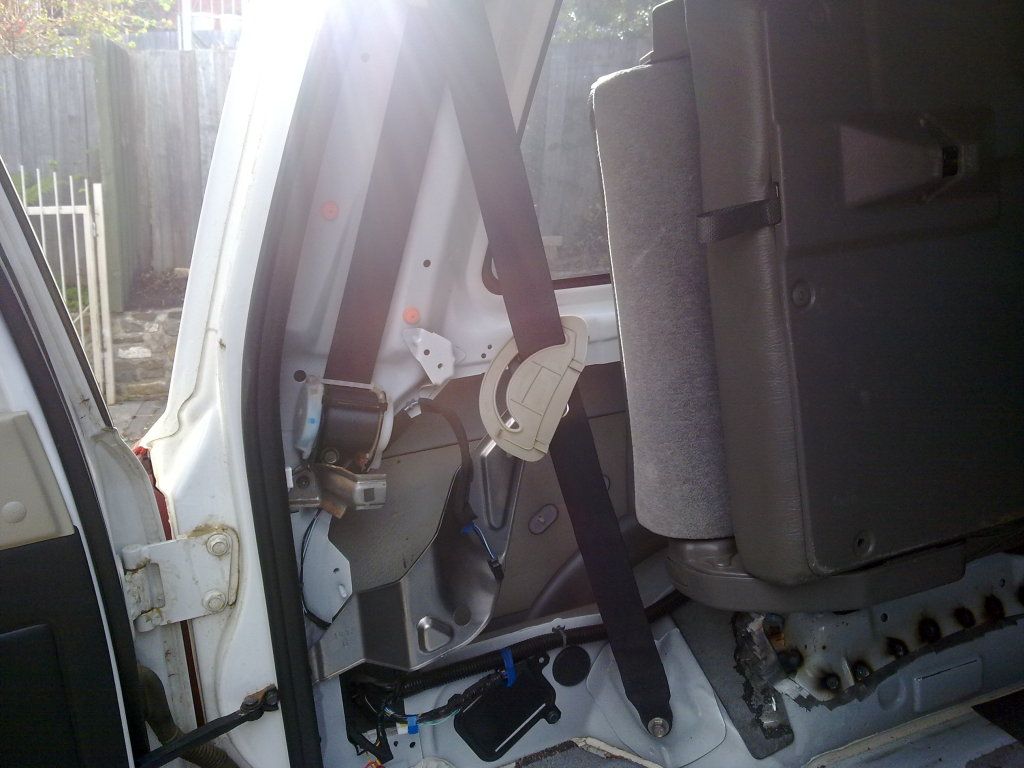

Left seat belt in place
http://i193.photobucket.com/albums/z...1052012308.jpg

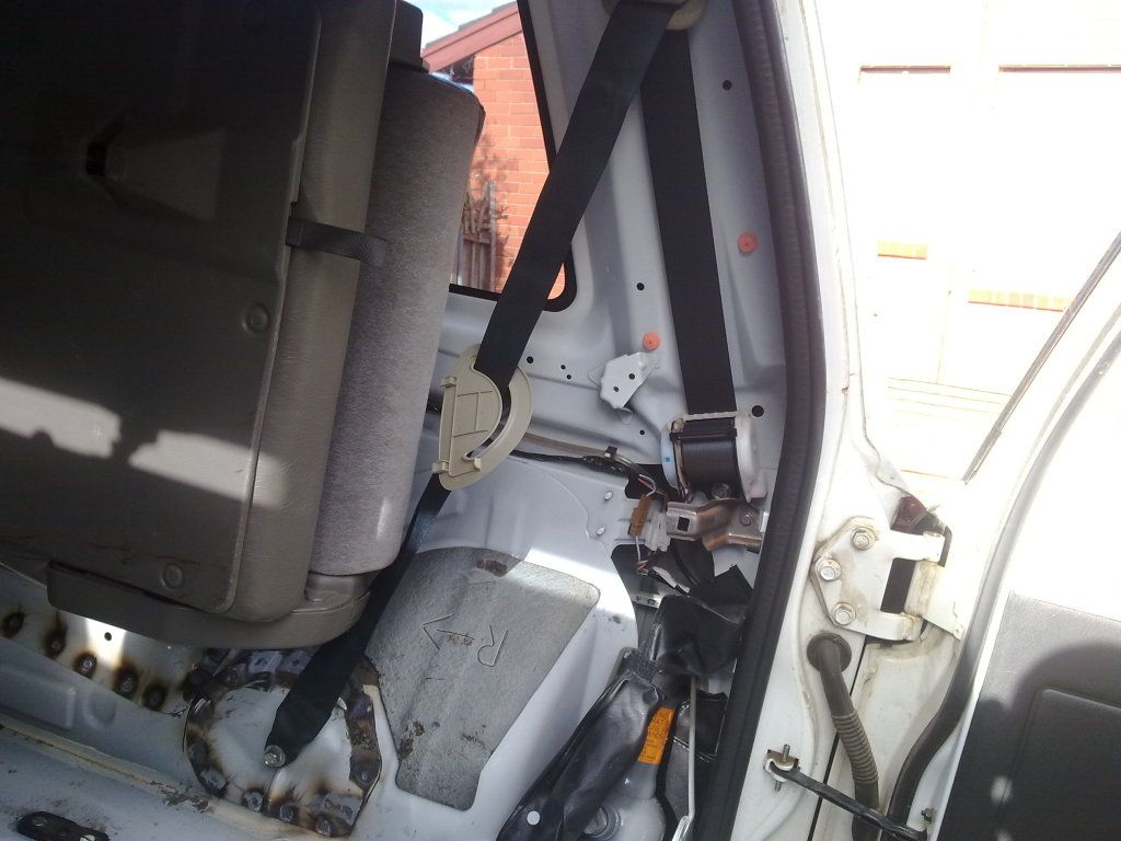

Right seat belt and mount
http://i193.photobucket.com/albums/z...1052012309.jpg

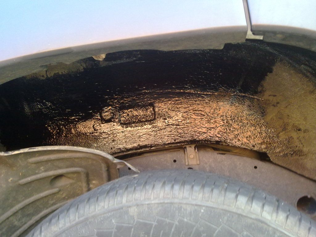

Left wheel arch with new sound deading
http://i193.photobucket.com/albums/z...1052012310.jpg
Right wheel arch with new sound deading NOTE fuel filler is behind the plastic when welding you will need to remove the plastic and watch hoses or place a wet rag over them
http://i193.photobucket.com/albums/z...1052012311.jpg

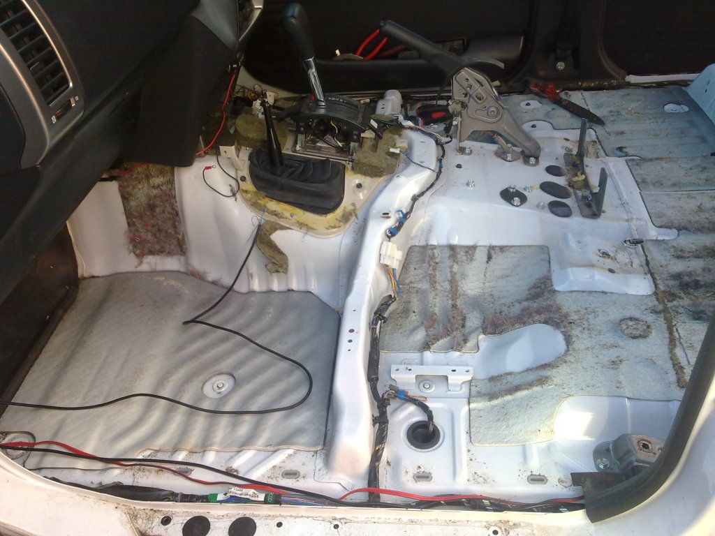

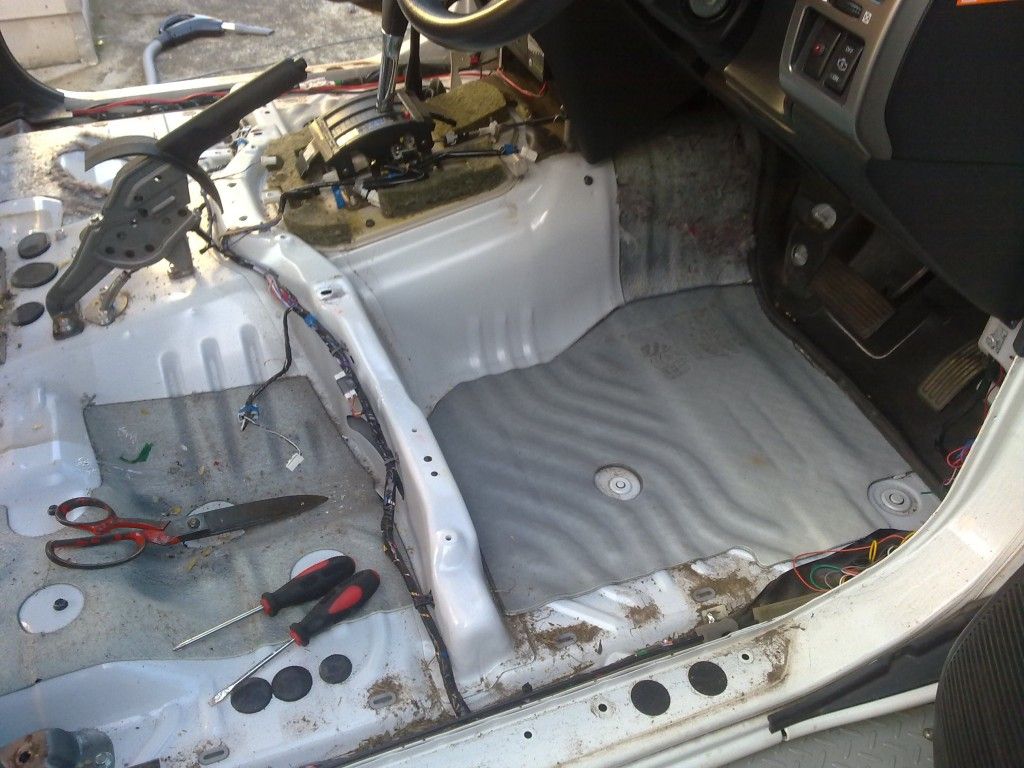

Ok well I’ve got some more pictures for you all
I’ve just finished putting the seats in and I put carpet underlay all threw the 4wd to keep it quiet, sorry I didn’t get any pictures of this as it was raining
I also found loads on grommets that could be used to run wiring into the car so I took some pictures just for interest sake.
I will get a picture of it all finished and put up soon but i look like a patrol
http://i193.photobucket.com/albums/z...8052012312.jpg
http://i193.photobucket.com/albums/z...8052012313.jpg
http://i193.photobucket.com/albums/z...8052012314.jpg
http://i193.photobucket.com/albums/z...8052012315.jpg
http://i193.photobucket.com/albums/z...8052012316.jpg
http://i193.photobucket.com/albums/z...8052012317.jpg
http://i193.photobucket.com/albums/z...8052012318.jpg
http://i193.photobucket.com/albums/z...8052012319.jpg
http://i193.photobucket.com/albums/z...8052012320.jpg
http://i193.photobucket.com/albums/z...8052012321.jpg
