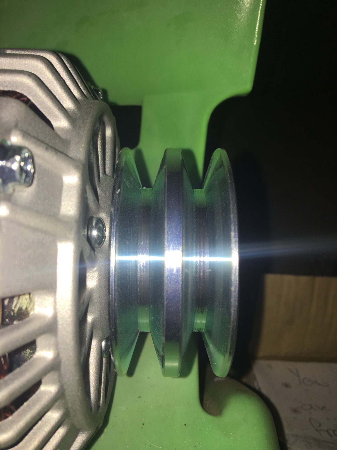

It's a bit freezing and dark outside to check at the moment but do you know much mate about 'V' belt angles/pitch to match on these pulleys, callipers needed or just eyeball it? Guess in a worst case I could swap pulleys over without hopefully needing to adjust shaft holes maybe too :-( ? http://www.nissanpatrol.com.au/forum...017/05/154.jpg
It is likely to be a 13A belt, meaning the outer width of the vee belt is 13mm. You can also get 11A belts, which will work but are not as strong and have less friction area on the side of the belt. I doubt it would be a B section as these are circa 16mm wide. The groove at the top of your A section belt pulley should be the same for the old and new. Ony reason to swap the pulley is it there is insufficient adjustment. The wrap angles will be very similar even if the pulley dia is different by a small amount.

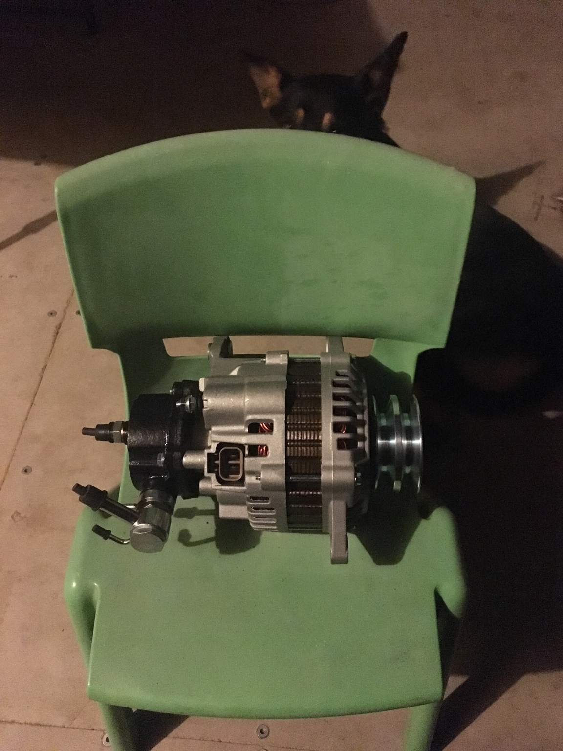

That alternator looks new @MB where from and how much?
From Phil's link kindly above mate. New 170a GQ42 Ebay advertised/shared!
It does say 'sold' now but as Phil kindly mentioned above the bloke relists after singulars are sold within an hour or so it seems!

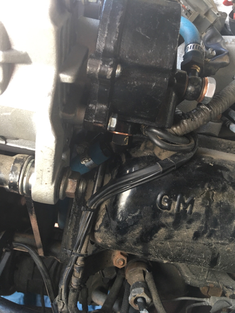

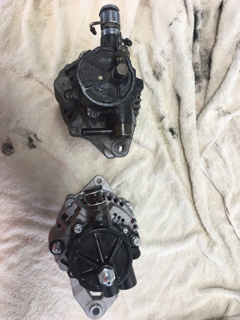

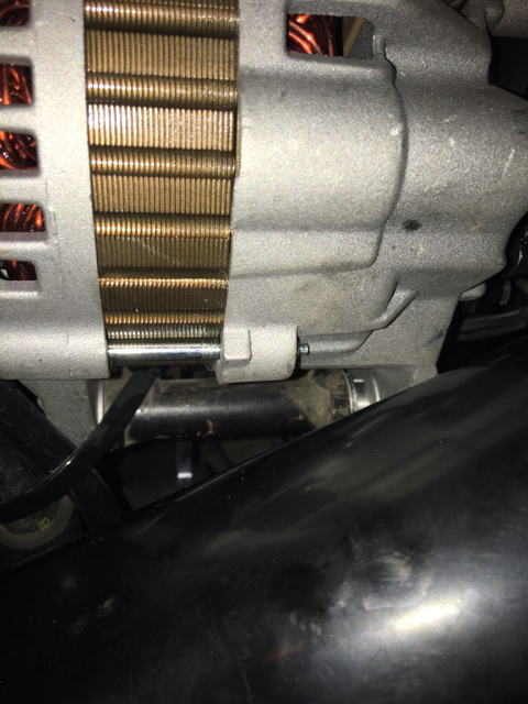

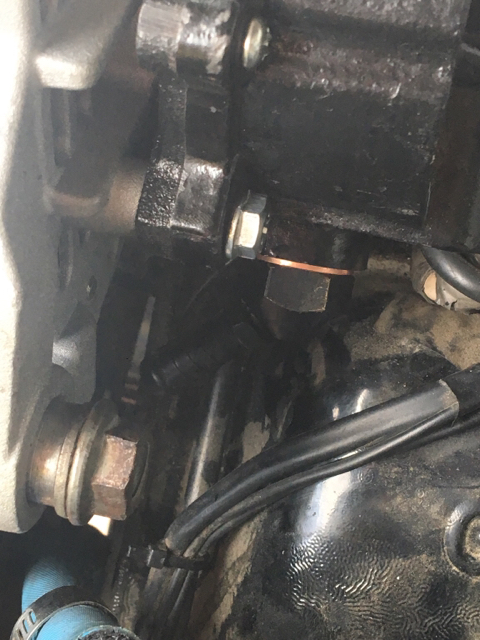

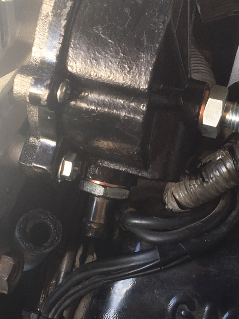

Quick update on the 6.5NA 'V-belt 13A' Mitsubishi Pajero alternator swap over to the 170a Nissan GQTD42 kindly Ebay found by @PeeBee ! A special thanks to @matfew and his after hours elecy skills and time too! Mounts all fit perfectly with only one thin washer needed below to align the pulley square. http://www.nissanpatrol.com.au/forum...017/05/199.jpgThe fun began when we finally realised the new GQTD4.2 oil drain was now hitting the rocker cover. http://www.nissanpatrol.com.au/forum...017/05/200.jpg Turned out to be that the vacuum pump castings and bolts are some say 10 degrees rotationally different. http://www.nissanpatrol.com.au/forum...017/05/201.jpg Thanks to the kind help also of 'Scooter' at 'Pirtek-Wodonga' on our way through home we have customised a 45 degree M16/1.5T ('JIS -Japanese Hydraulic') new drain to clear the rocker cover finally. http://www.nissanpatrol.com.au/forum...017/05/202.jpghttp://www.nissanpatrol.com.au/forum...017/05/203.jpghttp://www.nissanpatrol.com.au/forum...017/05/204.jpgThe next little challenge became the existing vacuum pump oil feed Banjo bolt would not fit the new M10/1.5T again ('JIS- Japanese Hydraulic') thread. 'Ultimate Fastners' next door kindly gave us a suitable bolt then the lathe and drill press at Pirtek went to work on more customisation. http://www.nissanpatrol.com.au/forum...017/05/205.jpghttp://www.nissanpatrol.com.au/forum...017/05/206.jpg Good news is that they do fit with a bit of tweaking and it's only now needing a descent charge wire and fuse to gain its full potential.

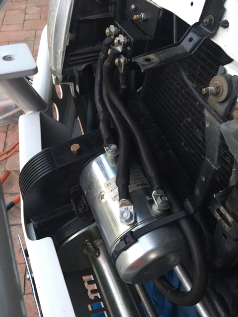

Ooh, and a double special thanks to @matfew for kindly wiring up my revamped winch tonight whilst waiting too ;-) http://www.nissanpatrol.com.au/forum...017/05/207.jpg

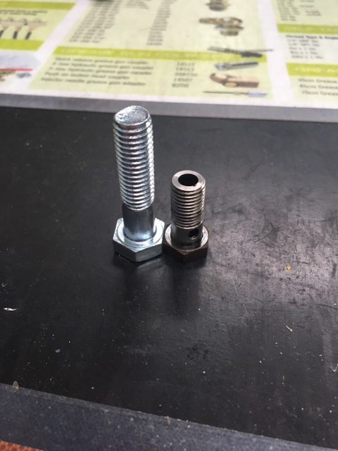

Was the original drain banjo a different thread?
The patero alt had some imperial threads and gq alt is metric. The vacuum fit straight on oil supply was the m10 and the drain was m16. Not sure on sizing of the pajero one.
Very strange for a pajero (japanese) to be imperial. Unless the conversion company has done some customising.
Noticed the new alternator has 4 mount bolts as well, the mitsu only has 3 so you can swivel the pot orientation 120 deg without issue, but the 4th snookers you, plus the 10 deg thing is a bugger. Anyway, its done, charging ok?
Yep, as Matfew mentioned vac banjo up high fitted no probs, drain banjo on the Nissan was smaller and the new rotation unfortunately wouldn't of allowed it even it was same. The oil feed banjo as you say Matt was very strange for Jap to Jap so maybe was tapped before possibly? Both vac pumps were 3 bolt mounts Phil, it might be the vac case screws seen in the picture. It's running great so far and back up to 14.5/.6 on the multi and Matfew is kindly helping install the additional chunky charge wire with 150amp fuse next week ready for some winching. Matfew has a clamp meter thingo for amp testing so we'll load her up with everything that has a switch and see how it goes.

Quick recent trip footage up the mountains. Love my 6.5NA for its awesome compression downhill and even better crank inertia uphill :-) https://youtu.be/vk1rVg6tbv4 Found some quick humility soon after that my 150psi chassis air tank and lockers are poorly plumbed and flooding solenoids with moisture/icing up totally/scary disabled:-( https://youtu.be/TKNqMLD5qOM Good news to share for the recently installed 170amp GQTD alternator though! Powered the newly revamped Warn HM Iskra/Mahle motor without a sweat, just kept hauling up that slippery ledge with lockers gone, my saviour :-) https://youtu.be/AfAEzIx_0f0

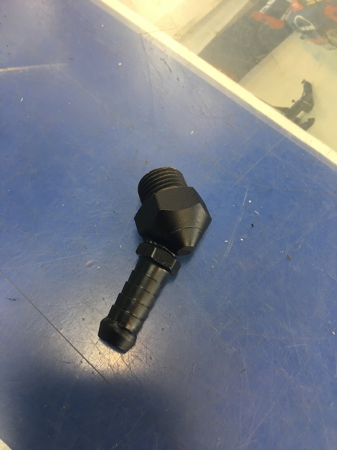

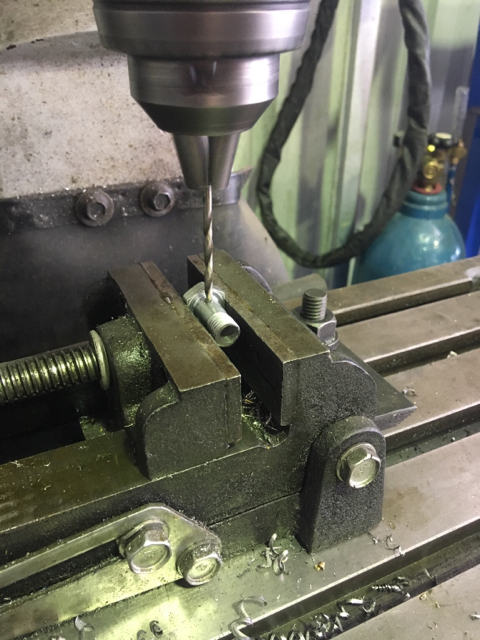

Phil it would be best to get the new alternator then the pipe sizes and go to pirtek (or similar) with a list. What we done with marks was a back and forth till we found right fitting. The only issue was the oil drain which was a custom made jobby by the local pirtek in wodonga but it is something that could be made at home if your handy with a Oxy or something.
