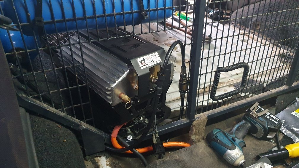

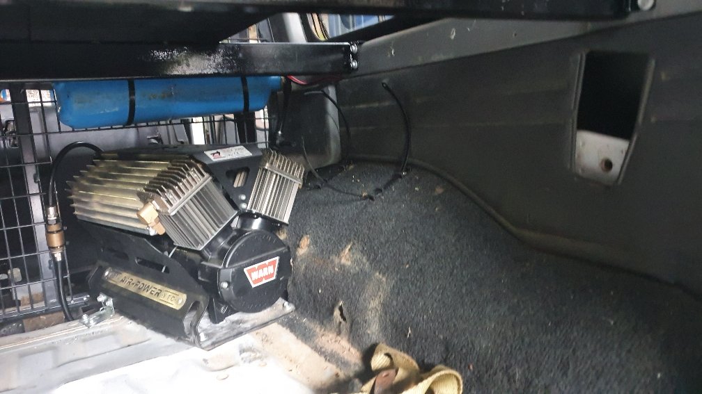

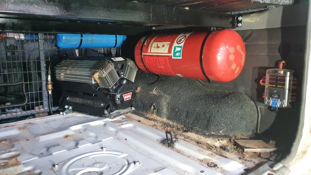

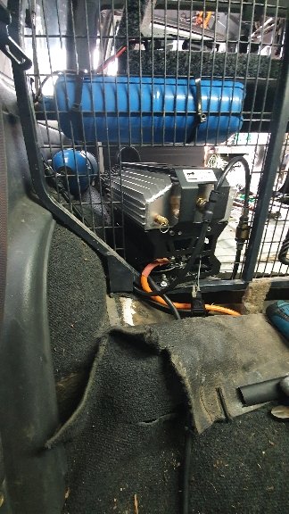

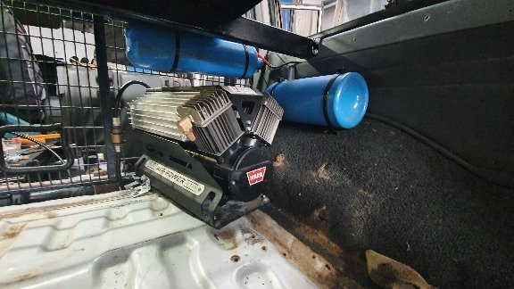

Got most of the install done today.
http://www.nissanpatrol.com.au/forum...2020/07/19.jpg
http://www.nissanpatrol.com.au/forum...2020/07/20.jpg
http://www.nissanpatrol.com.au/forum...2020/07/21.jpg
Pulled out one of my air tanks to fit a bigger one.
http://www.nissanpatrol.com.au/forum...2020/07/22.jpg
http://www.nissanpatrol.com.au/forum...2020/07/23.jpg
I need to rework a solenoid in the system.and add a loom bridge and we are game on.

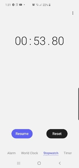

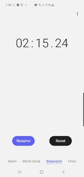

So some testing. From zero pressure to 100psi into the holding tanks.
http://www.nissanpatrol.com.au/forum...2020/07/25.jpg
And I aired down the 37 to 16psi.....
http://www.nissanpatrol.com.au/forum...2020/07/26.jpg
To pump up the 37 from 16psi to 42psi without the engine running....

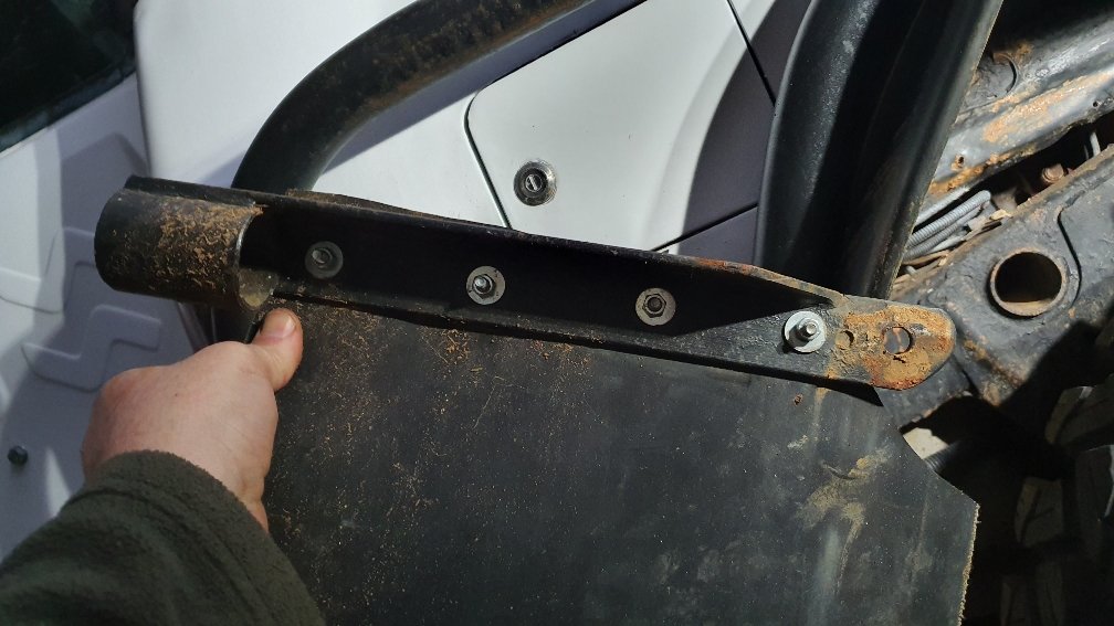

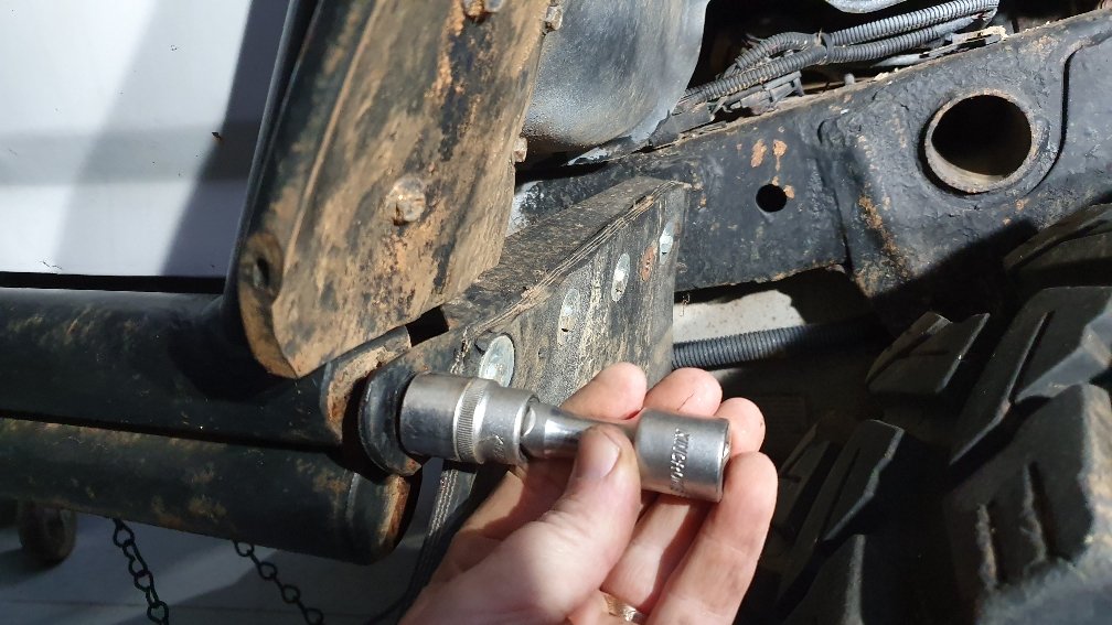

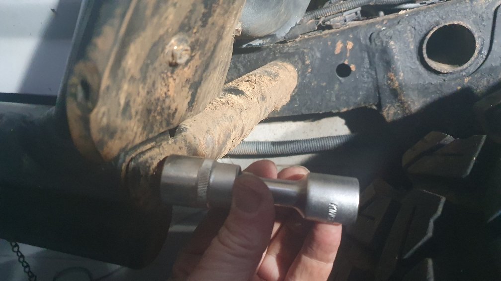

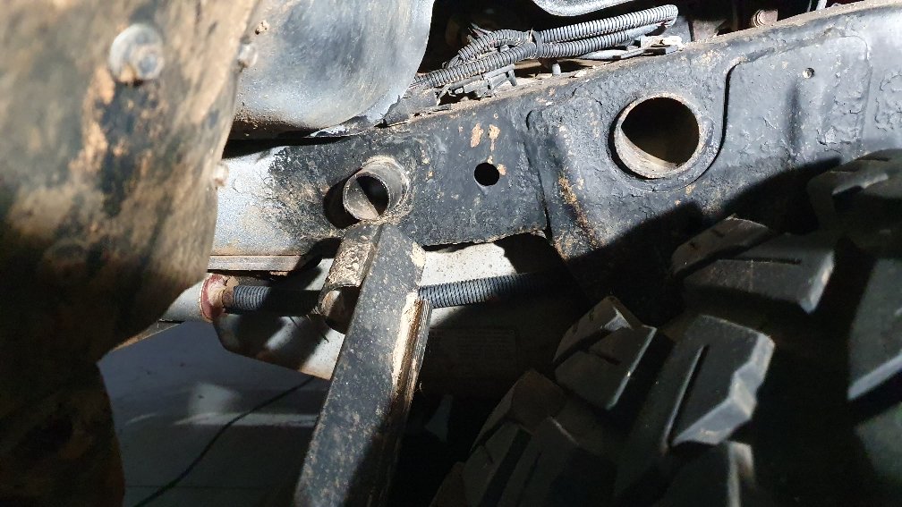

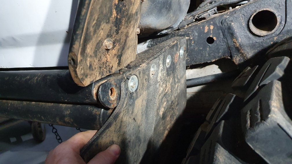

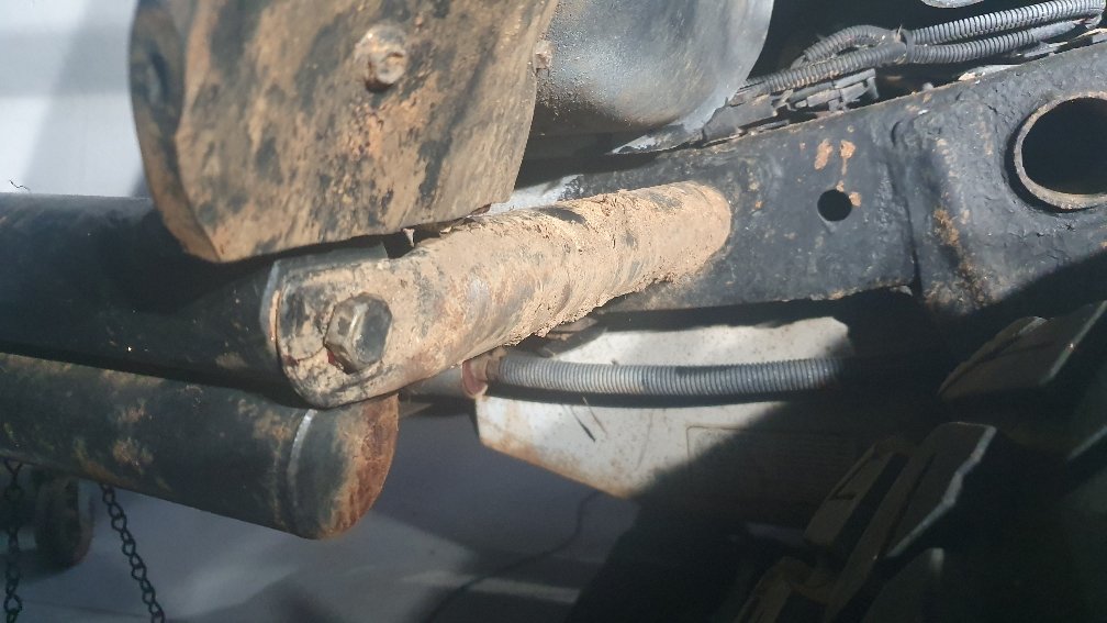

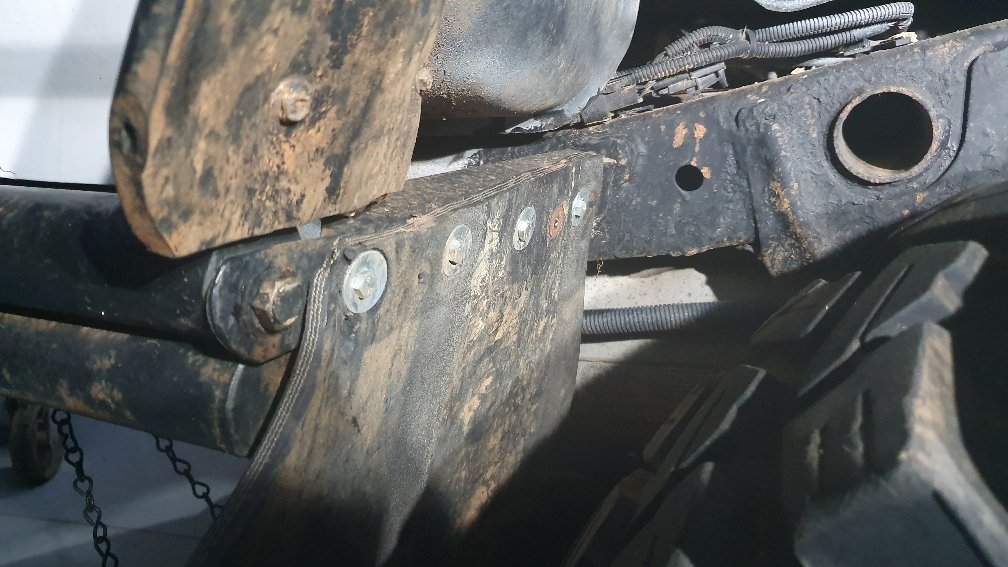

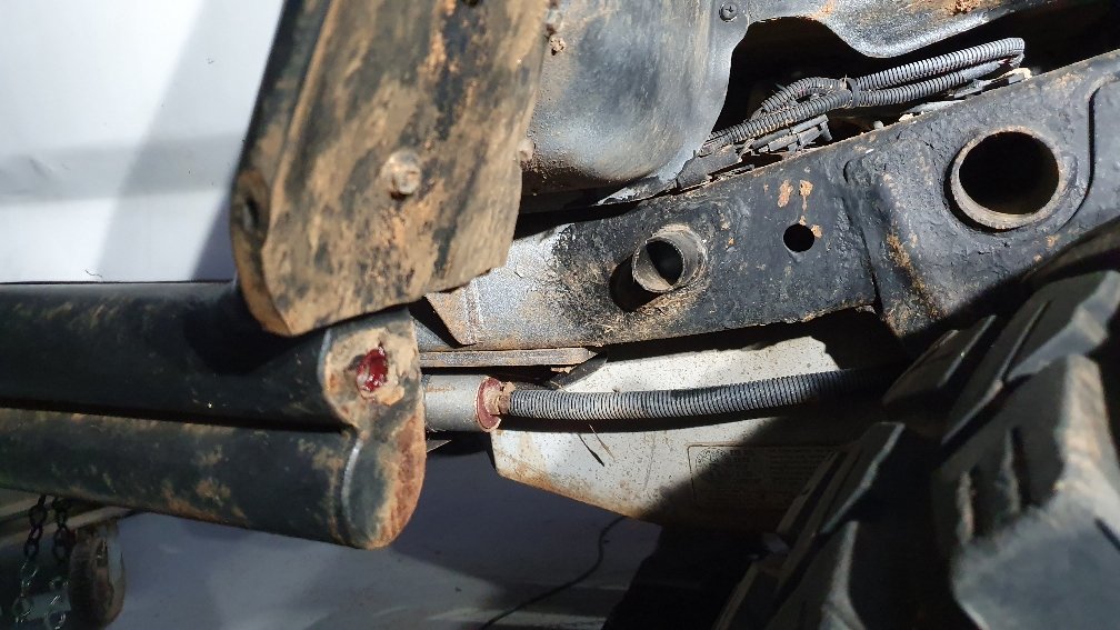

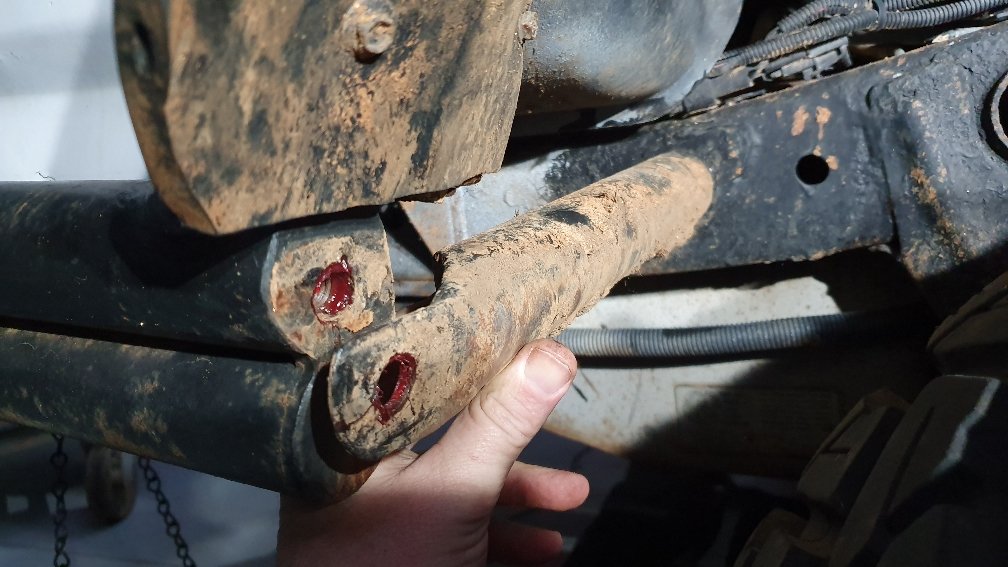

Had a chance to take some better pics of my removable mud flaps today.
19mm spanner and swap takes about 1 minute a side
http://www.nissanpatrol.com.au/forum...2020/07/32.jpg
http://www.nissanpatrol.com.au/forum...2020/07/33.jpg
http://www.nissanpatrol.com.au/forum...2020/07/34.jpg
http://www.nissanpatrol.com.au/forum...2020/07/35.jpg
http://www.nissanpatrol.com.au/forum...2020/07/36.jpg
http://www.nissanpatrol.com.au/forum...2020/07/37.jpg
http://www.nissanpatrol.com.au/forum...2020/07/38.jpg
http://www.nissanpatrol.com.au/forum...2020/07/39.jpg
http://www.nissanpatrol.com.au/forum...2020/07/40.jpg
That's clever Darren, luv stuff like that. I may graft the concept onto mine - somehow??? Factory flares front and rear are bent and mangled, so need an upgrade.
