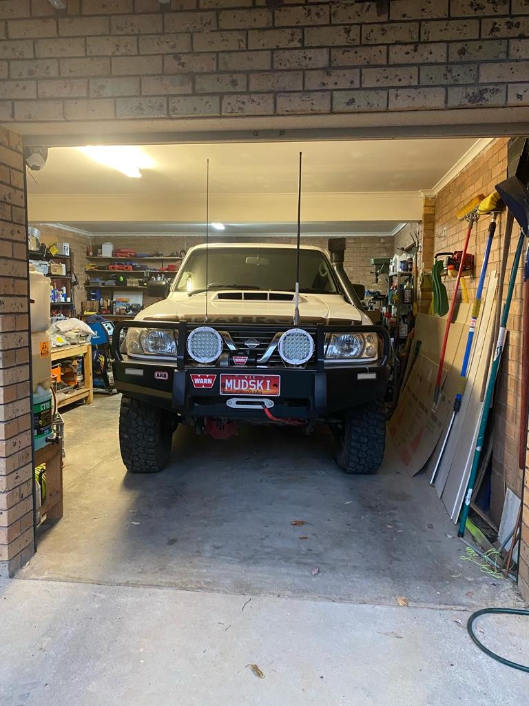

Also have the old GUrl a wash.
Attachment 82828
Nice shed ;)
that's one nice Patrol . all your good work is paying off ..
Yeah thanks. A lot of hard work has been invested. We have a love hate relationship. Theres been a lot of hate. But at this point in time is love. Whilst on our summer trip, yeah she got hot, and bloody hot, I was asking a lot of her. A thing or two broke, but didn't break me. Got home all good and all the broke things are fixed.
She got pushed, and hard in some really hot temps. This old GUrl held her own on this summer break. I was quite happy.
