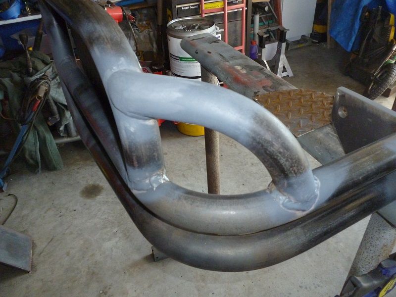

Started fabbing a tube rear bar for a GU this morning.............
http://i36.photobucket.com/albums/e3...ps2cd8a6a6.jpg
http://i36.photobucket.com/albums/e3...ps882c471c.jpg
http://i36.photobucket.com/albums/e3...ps8f39f87a.jpg
That looks good and strong. I am Interested to see how you attach the tow bar mount.
Thanks mate :bigthumbup: The tow bar will be the original one, I'm just building a replacement rear bar :)
Got some more done on the 'Trol tube rear bar .........................
http://i36.photobucket.com/albums/e3...ps3980f4bf.jpg
http://i36.photobucket.com/albums/e3...ps916e3822.jpg
Not far to go now. Welded out & started doing the fill in panels. Also, have a couple of idea's for the tail light mounts I'm keen to try out.............................
http://i36.photobucket.com/albums/e3...psece21f71.jpg
http://i36.photobucket.com/albums/e3...psa9d54210.jpg
http://i36.photobucket.com/albums/e3...ps1b5d0d50.jpg
Got the tail lights mounted...............
http://i36.photobucket.com/albums/e3...psb9f2705b.jpg
http://i36.photobucket.com/albums/e3...ps1a8c509a.jpg
http://i36.photobucket.com/albums/e3...pscf1d94b1.jpg
