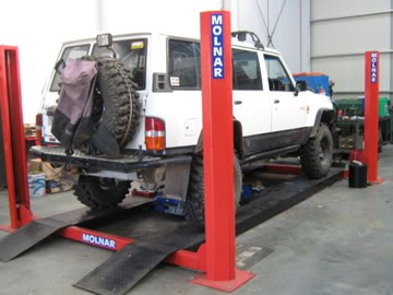

Yesterday i was able to line up a free 4 poster hoist at a local ARB dealer that i am friends with, Very kind.

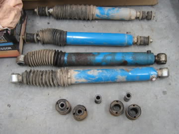

Firstly, during the build i fitted 12 stage adjustable BOSS Shocks! BOSS stands for "Bit Of S@#t Shock." i blew 1 in the first 1000kms on the front left and the other spat its oil all over the joint before they were 1500kms old. They had very little compression preload and a ridiculous amount of rebound dampening that saw my wheels off the ground every time i took it out.
http://nissanpatrol.com.au/images/St...g?t=1301808786
BOSS Shocks = JUNK!.

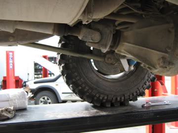

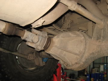

Secondly, i fitted a big lift and adjustable upper rear control arms to the back. When i fitted these i set it up to achieve the straightest possible pinion angle i could (Wrong) (a pinion requires about a 5 degree offset to give best performance) being straight gave the pinion nothing to do....
http://nissanpatrol.com.au/images/St...g?t=1301810096
The idea of an adjustable trailing arm is to achieve the best setup for all of the suspension components ie, a nice straight spring without a big bow, a good pinion angle (5d), clearance around the tyres and best possible factory geometry.

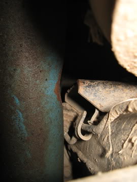

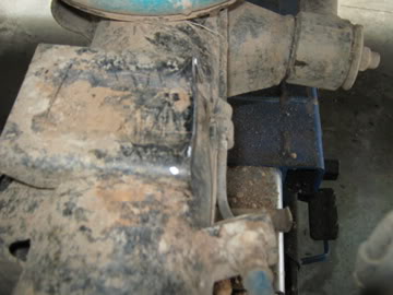

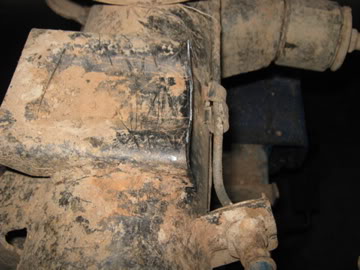

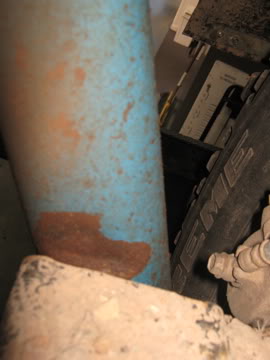

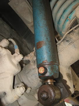

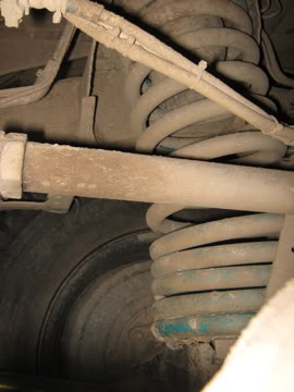

Also with the upper control arms set that way they were the diff was rolled back and the springs bowed back. The shock mounted behind the rear springs was rubbing on the springs during extension.

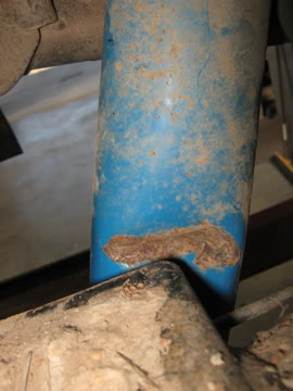

The other thing that the shocks were hitting was the back of the bump stop base on the top of the diff. (read ROOTED)
http://nissanpatrol.com.au/images/St...g?t=1301810336
Some close ups.
A heads up on this during the buy and prior to the setup would have been a real winner as i would have made the adjustments at setup. Damn it. Down a full set of shocks to find this out gets a bit average.
When I fitted my Tough Dogs I had to cut about 10mm off the back of the bump stop plates on the rear diff to stop that happening.

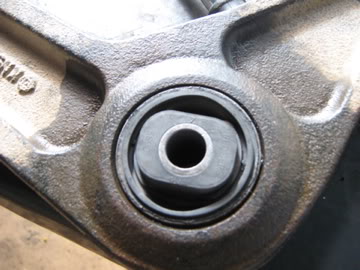

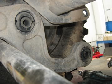

Now i hear you ask "Why do you need the hoist MR??" Well the Front Radius Arm Flexi-Bushes i fitted in the build 1500kms ago are ROOTED too!!! NOt happy Jan! The Rubber ones that i took out that Mr Nissan fitted some 350,000kms ago where like new by comparison to these.
Well i only have grass in the back yard at the moment and for safety's sake i wanted to do it on the hoist and had use of aq press while i was there===>> Bonus!

http://nissanpatrol.com.au/images/St...g?t=1301810683
Bush #1
Bush #2
Bush #3
Bush #4
http://nissanpatrol.com.au/images/St...g?t=1301810729
NOT MUCH CHOP HEY!
Trashed and Crappy.
OK Get this S#$t OFF my Truck!! NOW!
1500kms old!
http://nissanpatrol.com.au/images/St...g?t=1301810941

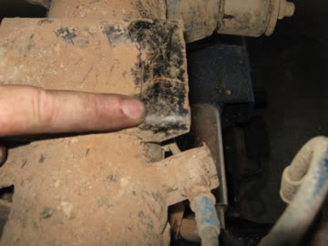

Yep as you say Tony have to go the chop mate, Shame i did not get a heads up on that or it would have been done at the fit up.

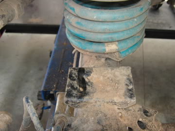

so here is the plate that is causing the trouble.
http://nissanpatrol.com.au/images/St...g?t=1301811340
And this is what i am going to cut off it
http://nissanpatrol.com.au/images/St...g?t=1301811374
Check out the placement of the brass brake tubes though = Be bloody careful with that angle grinder.
http://nissanpatrol.com.au/images/St...g?t=1301811297
Didn't need that bit of steel anyways.

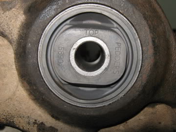

Suspension Stuff did me a great deal in kind for the crap i am taking off which s fair given that the sale took place 3 years ago and it all sat in a box for 2 years using all the warranty up. I reckon i got the replacement parts for Cost so that will do.
Here is the fit up of the new Pedders Branded Bushes
http://nissanpatrol.com.au/images/St...g?t=1301811848
Look nice hey!

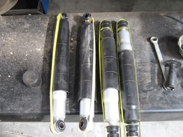

The Shocks are a Gas Twin Tube Suspension Stuff Branded variable Shock and i think they are Dobsons.
There is plenty of clearance now with the plate cut and the Uppers adjusted

They look nice and feel completely different to handle and test than the BOSS.
most of the fall over Body Roll that i had when driving around is now gone and the car feels great again

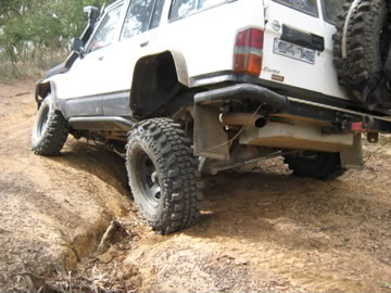

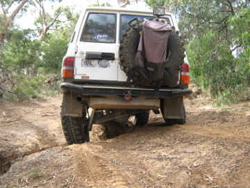

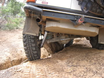

OK, Now some test pics. Fortunately there is a bit of public bush beside the industrial estate where the workshop was that i know very well and i had to go and have a play and a feel . Some things just have to be done.
So, It feels a little firmer, not as much body roll.
http://nissanpatrol.com.au/images/St...g?t=1301811909
http://nissanpatrol.com.au/images/St...g?t=1301812336
Go the Nissan Hand Brake!!
http://nissanpatrol.com.au/images/St...g?t=1301812454
and i think it works OK?
