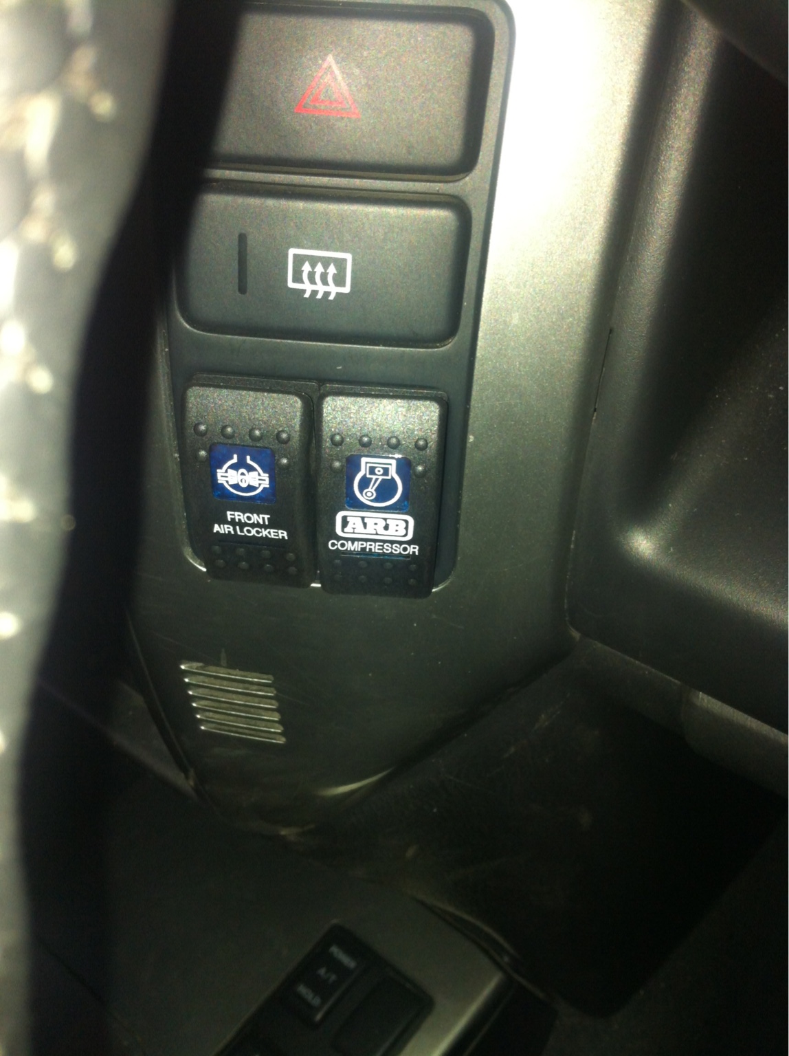

The left hand button is no no longer a dummy button. http://www.nissanpatrol.com.au/forum...015/09/137.jpg

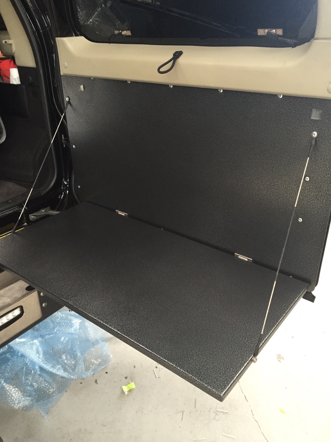

What was the door table worth mate? I am going to build some drawers next week as i scored an ARB fridge slide dirt cheap. So i thought to door a door table too. But i want to do a metal one over wood, purely for ease of cleaning.

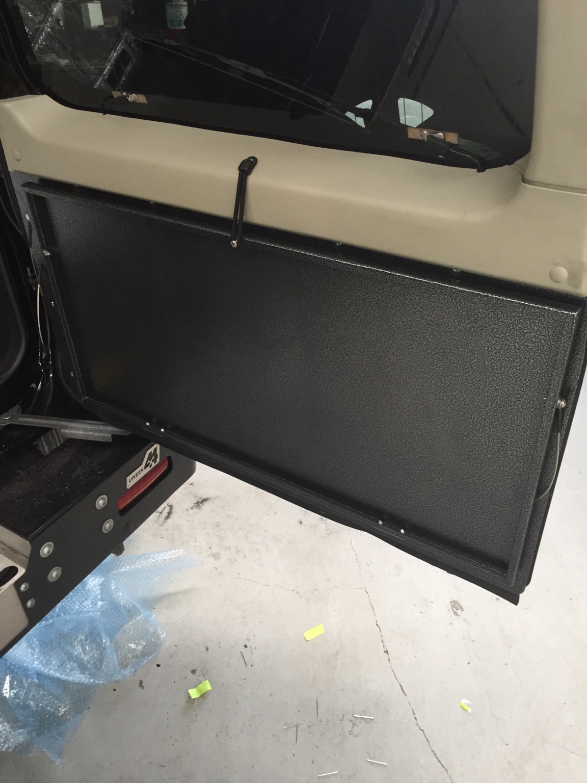

I paid $320 for the both sides in hammertone powder coat.
The only flaw is the table holder, I believe won't hold the table hard enough against the panel to stop it from rattling when going over bumps.
So I asked for it to be looked at whilst it's still at ARB. for a tighter, stronger hold.

Yeah. . . You'll end up switching it on every chance you get just for the fun of it Haha!! You'll get the feel for it pretty quick.

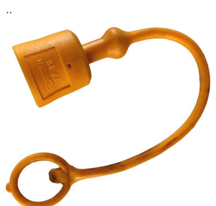

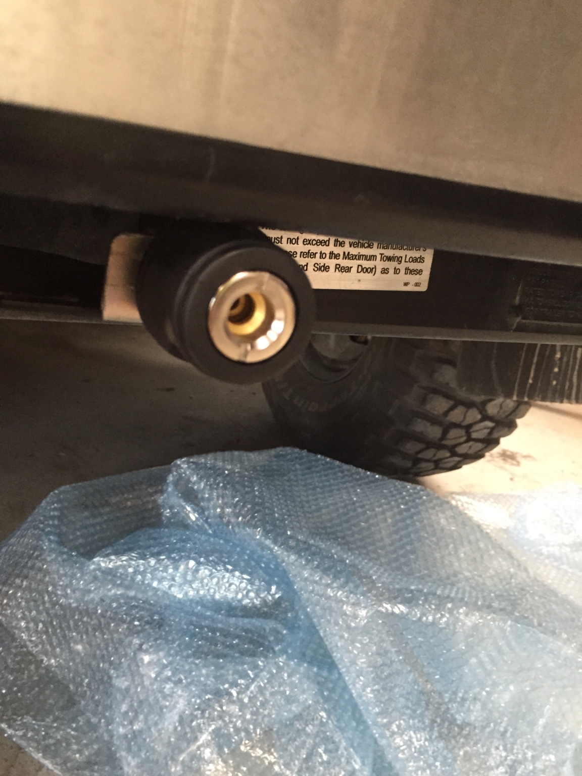

Should chuck a cap on the air outlet. They end up getting mud in it then the compressor will just run when you try to put locker in. . . Still need to do that to mine. . .
Looking for something like this or similar http://www.nissanpatrol.com.au/forum...015/09/144.jpg

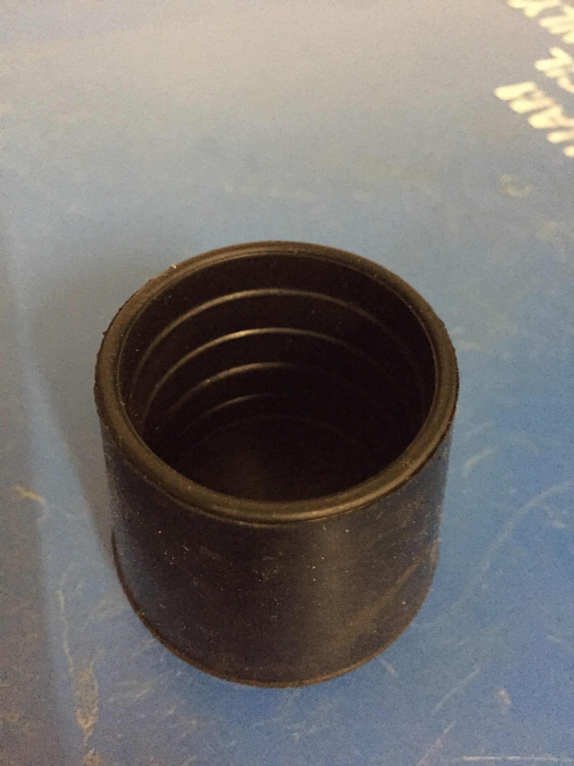

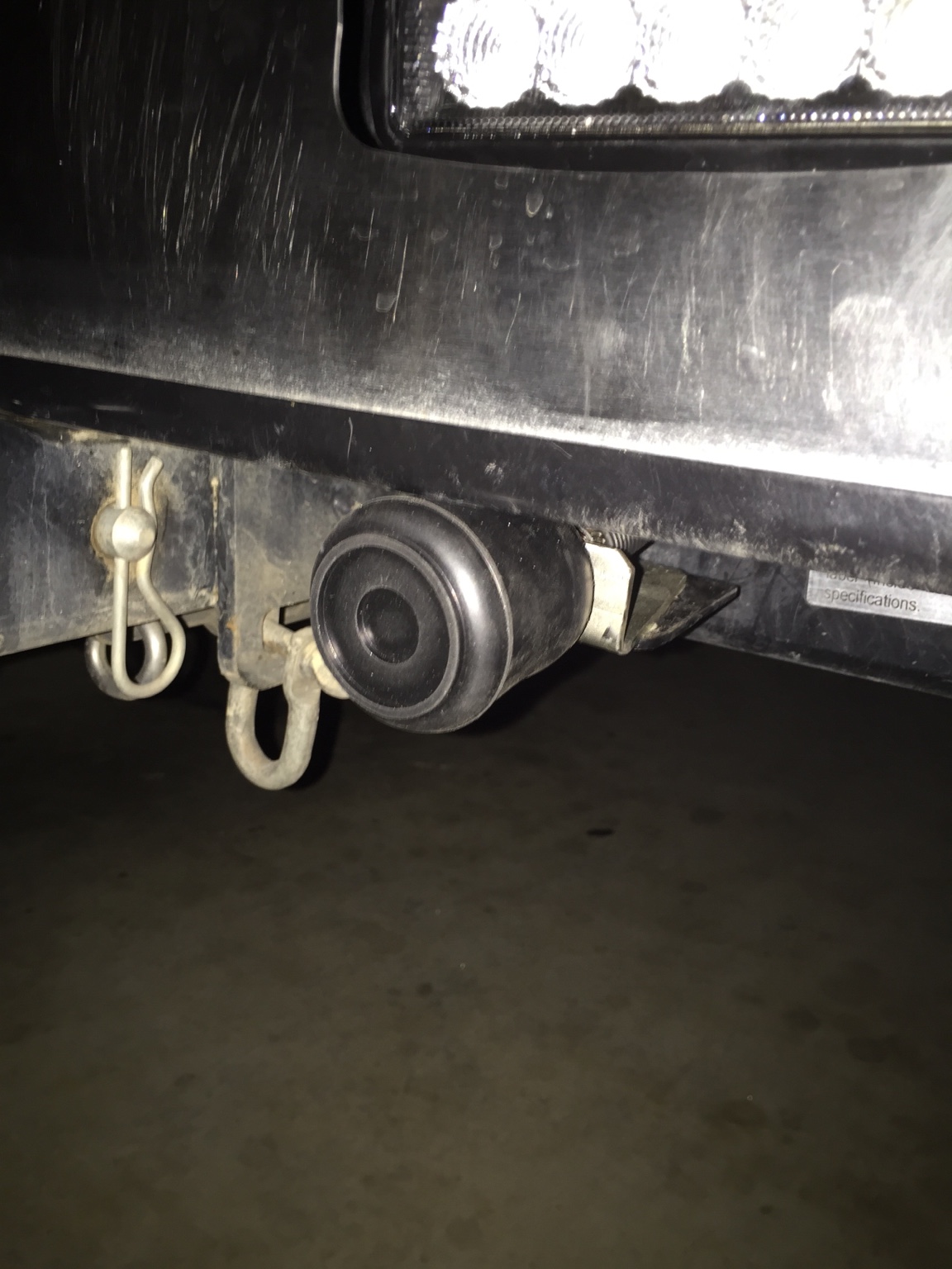

Ended up at Bunnings and bought 38mm chair leg rubbers. http://www.nissanpatrol.com.au/forum...015/09/150.jpghttp://www.nissanpatrol.com.au/forum...015/09/151.jpghttp://www.nissanpatrol.com.au/forum...015/09/152.jpg
