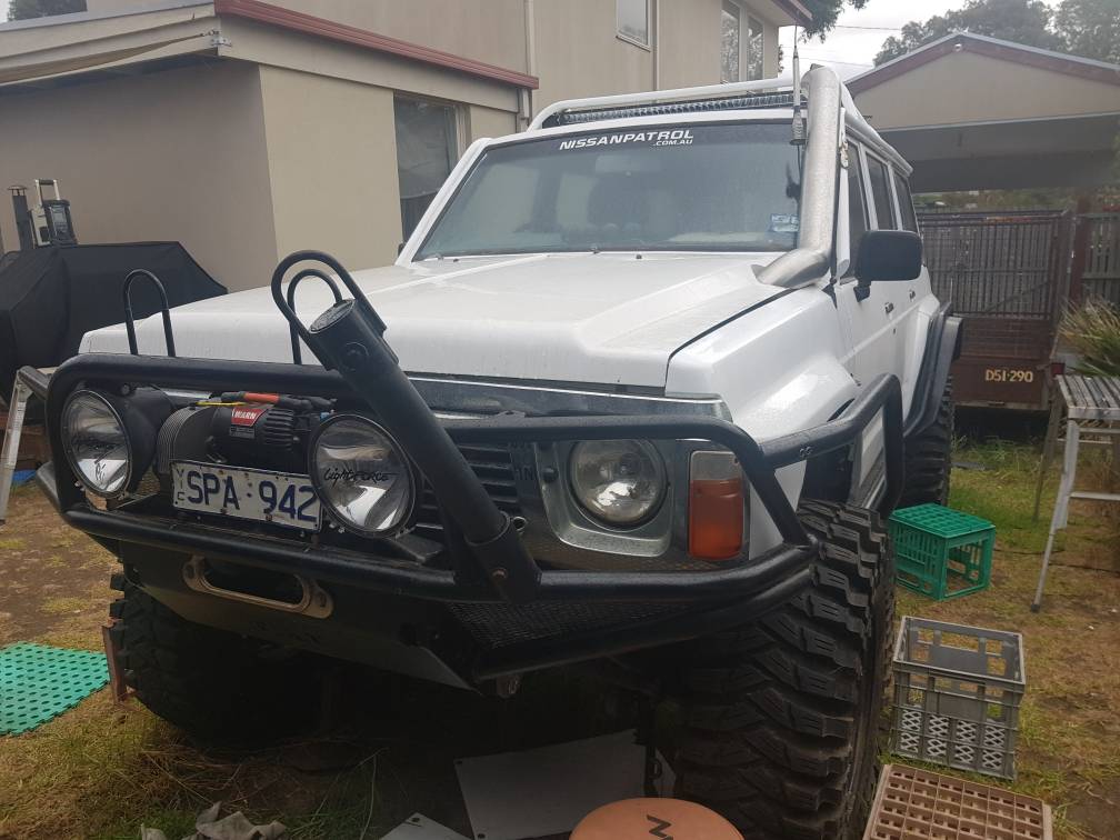

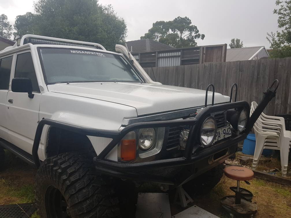

Getting bloody close now.

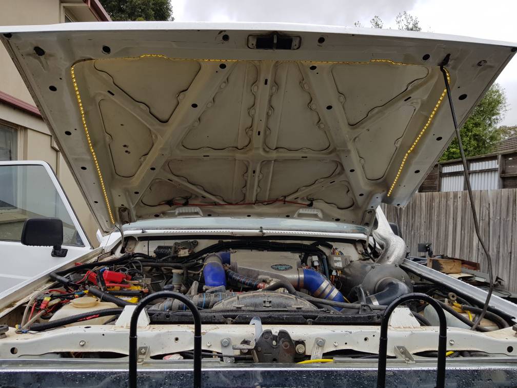

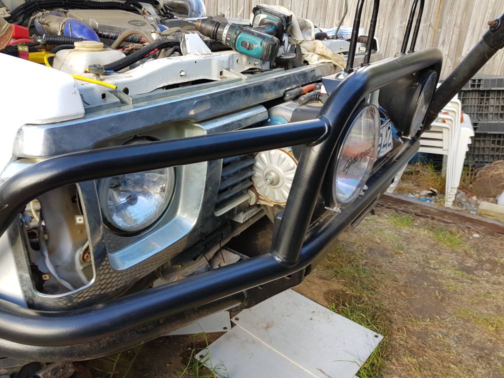

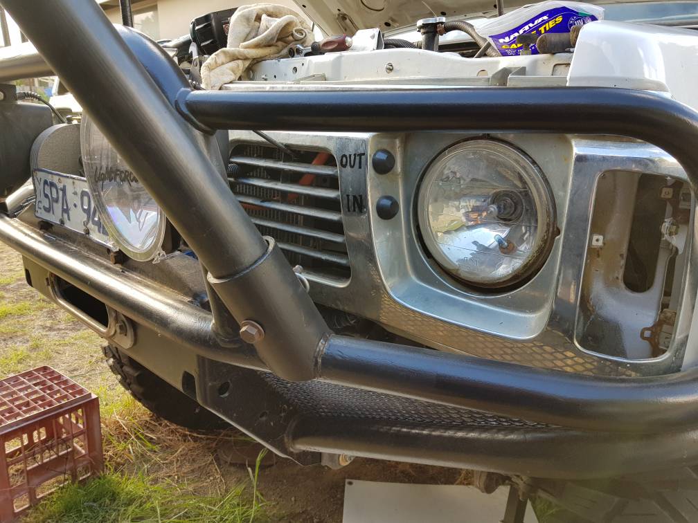

Many little jobs finished. Fitted the grille. Parker lights. Filled the winch with oil.

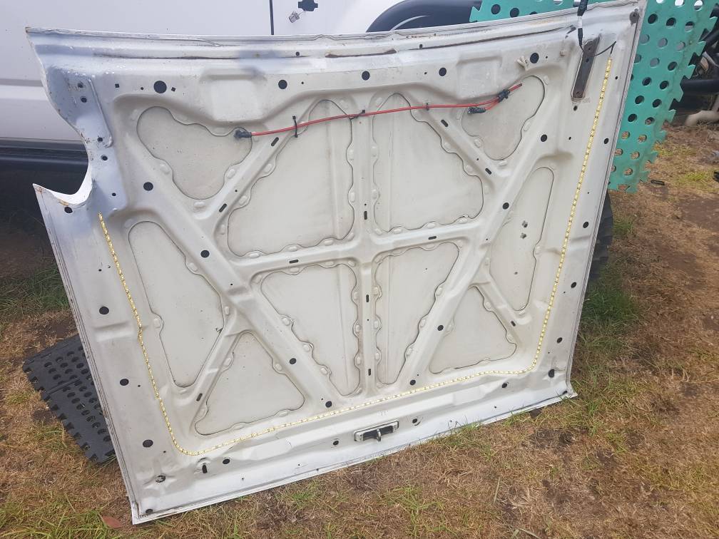

Trying to adjust the bonnet and snapped a bolt damn it so the bonney had to cone off!

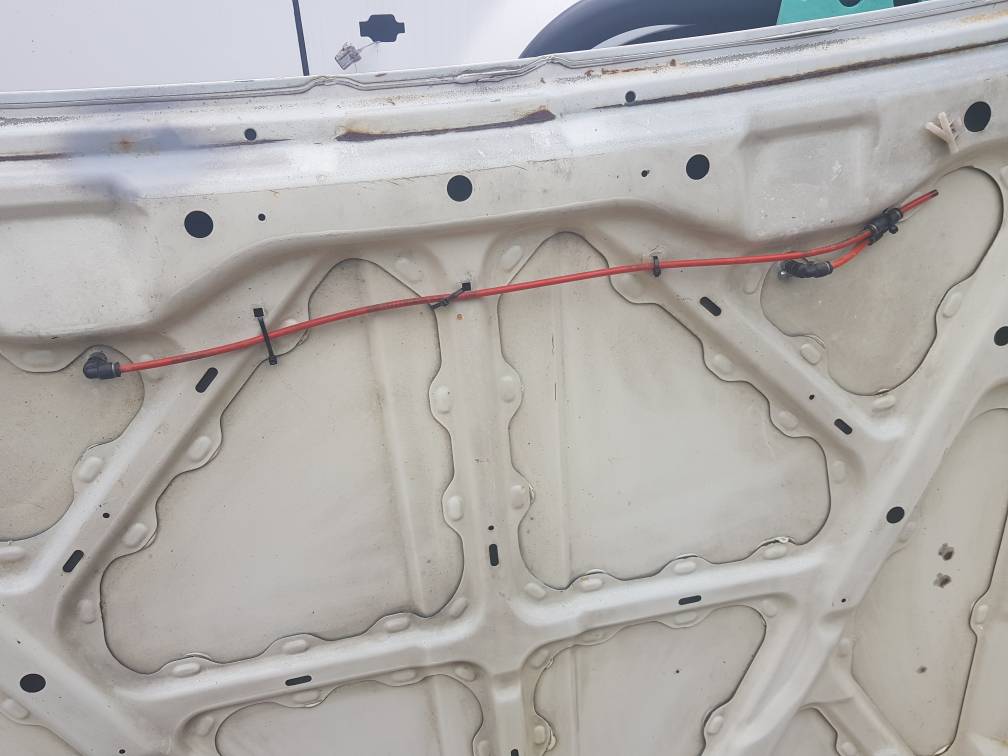

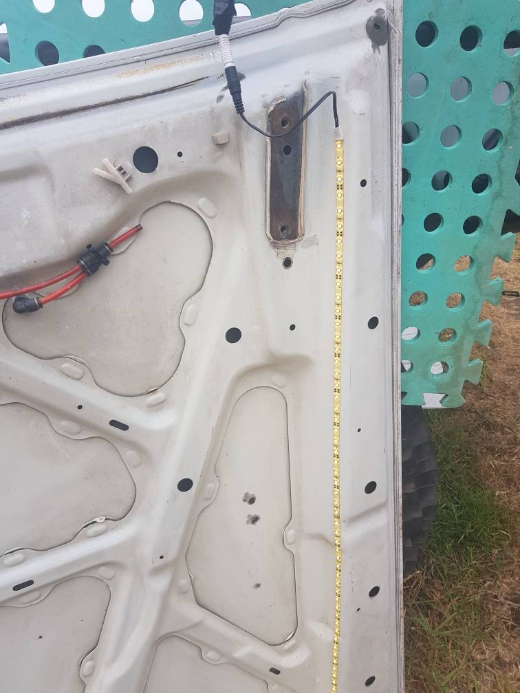

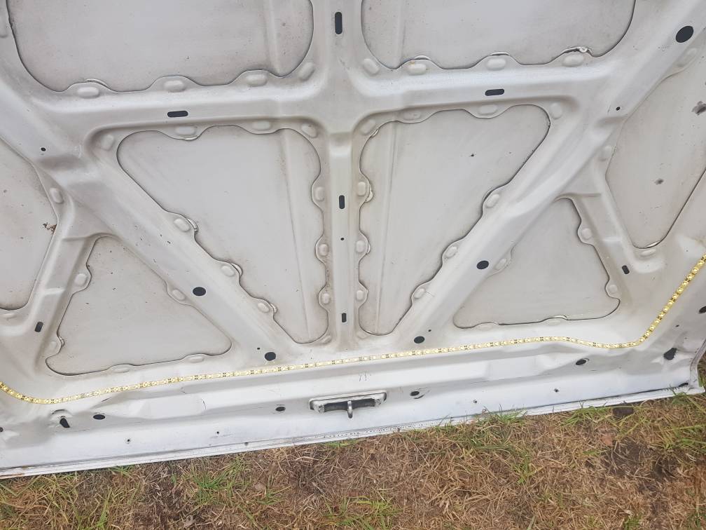

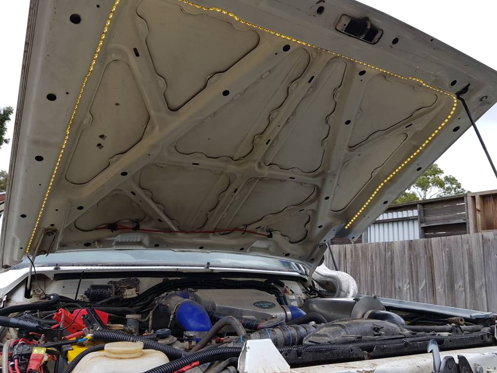

Took the opportunity to run the washers back in and fit some LED Lighting.

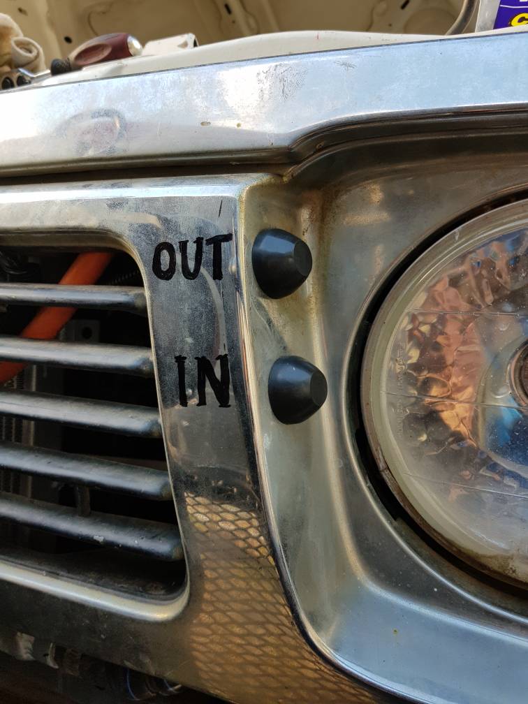

Winch grill switched in and labeled

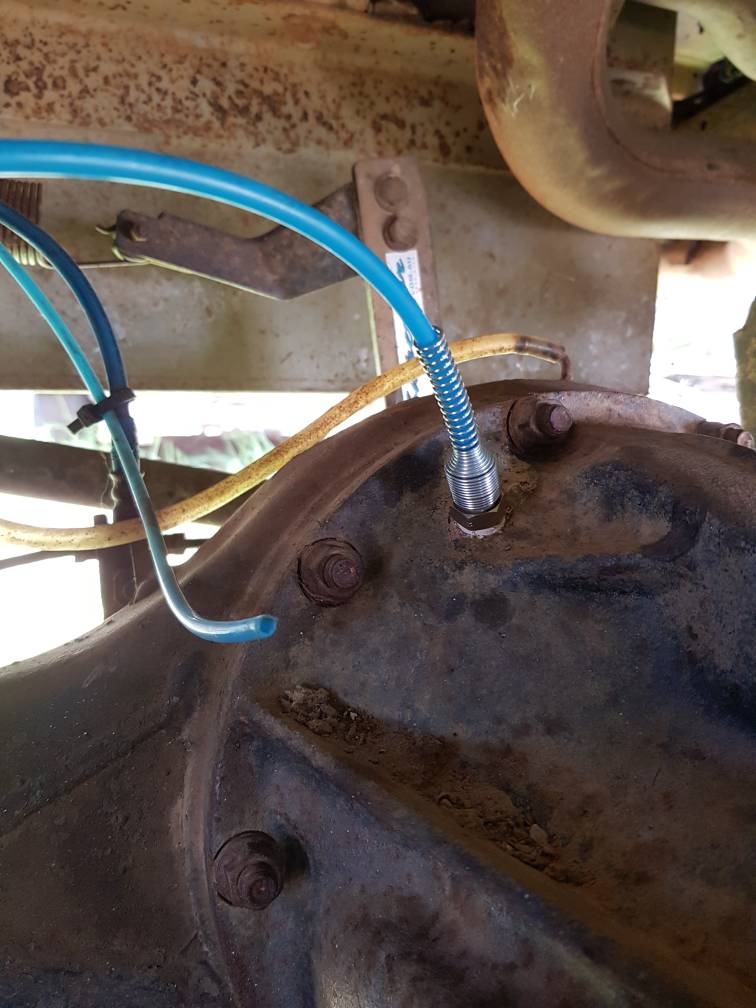

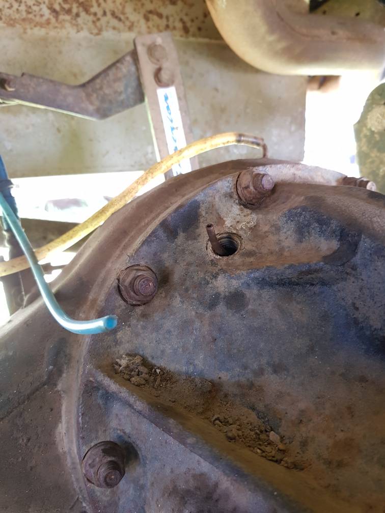

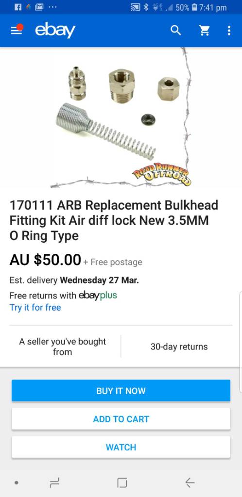

Re fitted the airline to the rear winch with a new fitting and the airlocker works again!!!! Yippee!!!
http://www.nissanpatrol.com.au/forum...019/03/316.jpg
http://www.nissanpatrol.com.au/forum...019/03/317.jpg
Just for interest this is the part i needed. Before buying online i did a price check at ARB......... $12 in stock. Identical.

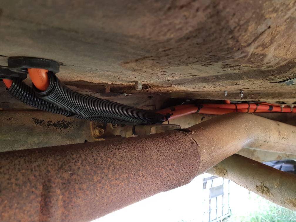

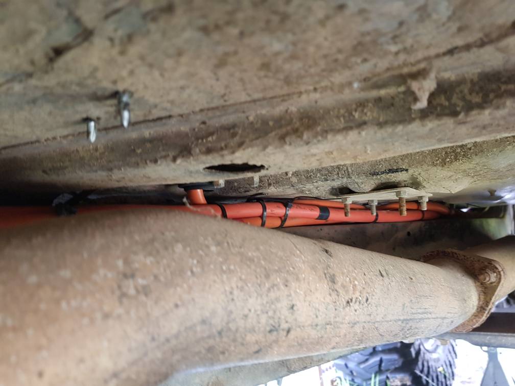

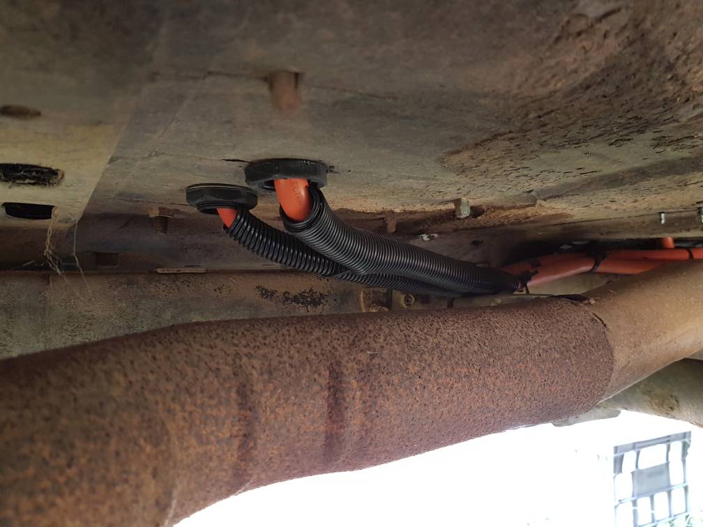

Tidied up the winch 24v wiring and added some extra insulation

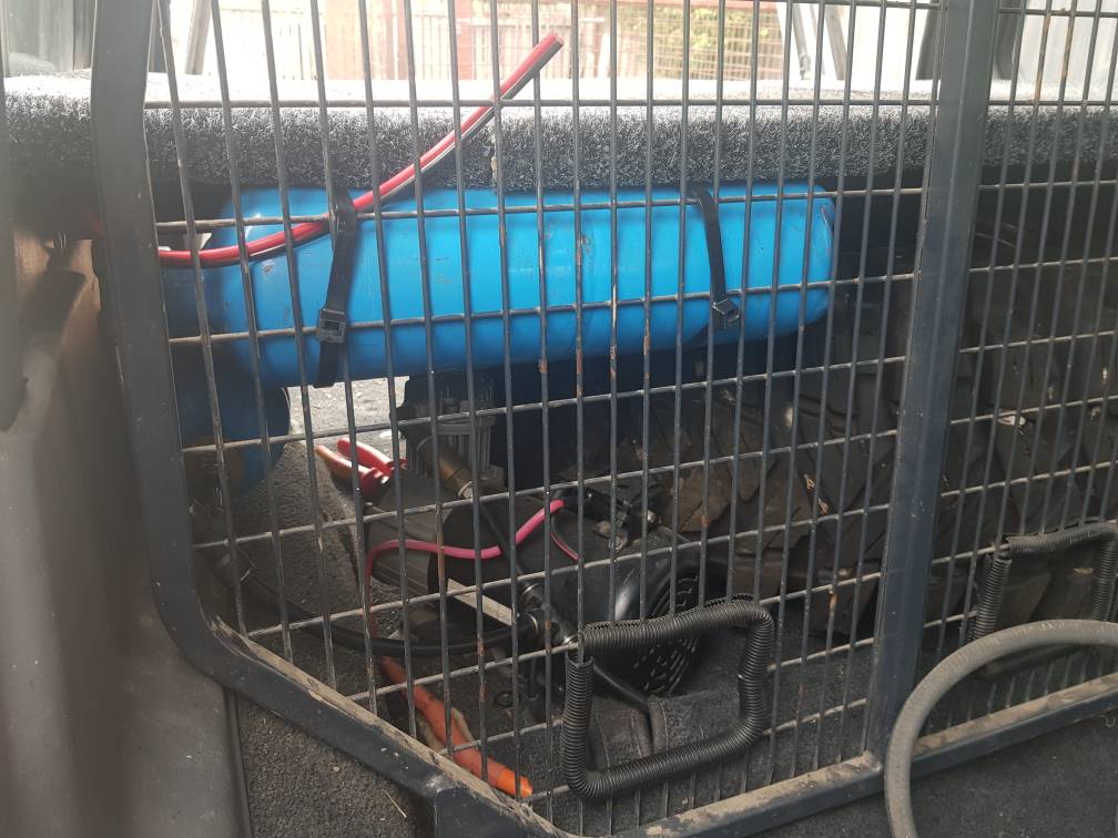

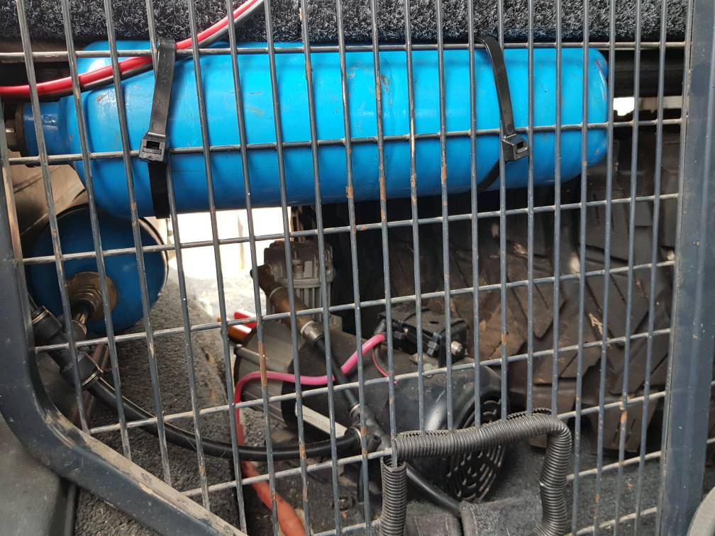

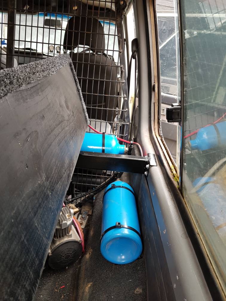

Fitted 2 Air Vessels for extra storage.

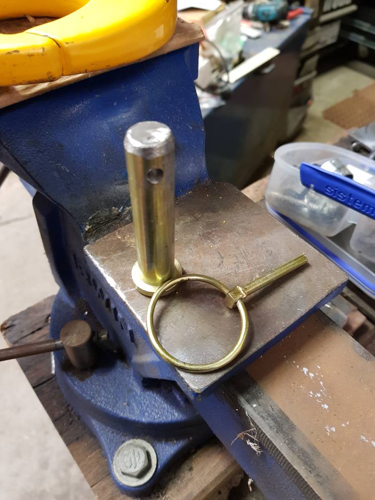

Swapped to a pin for the winch dildo

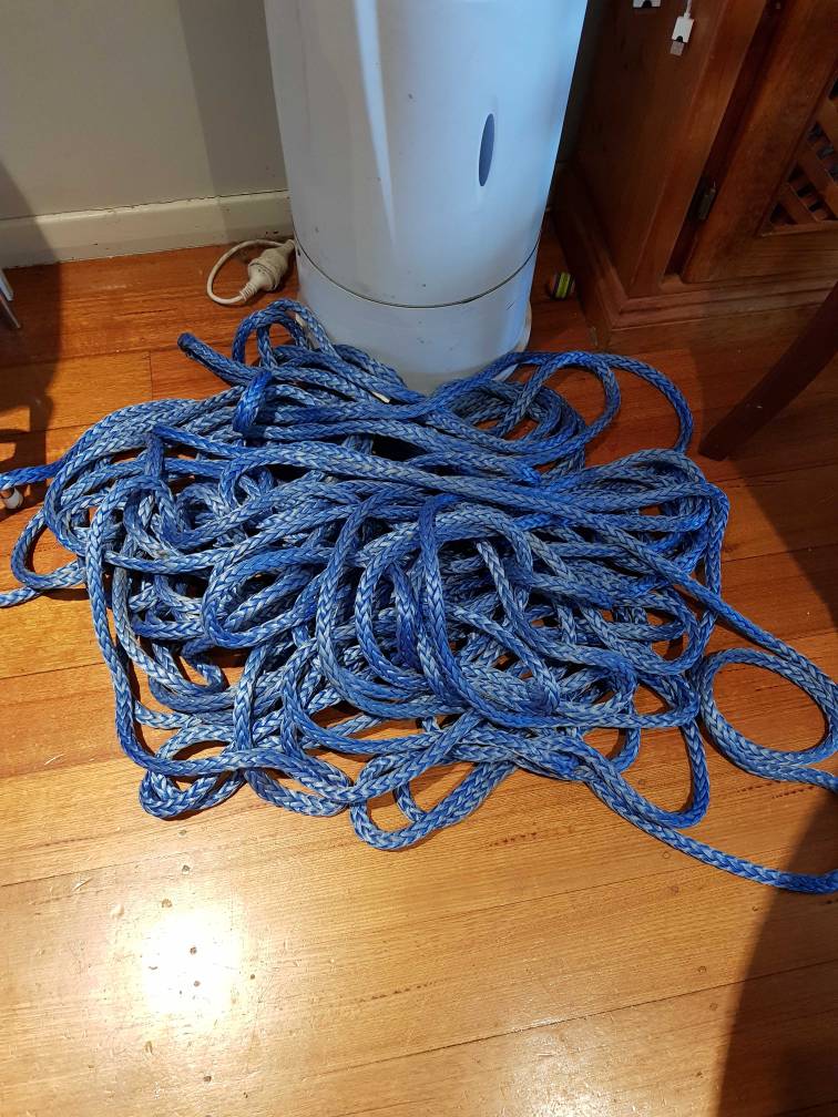

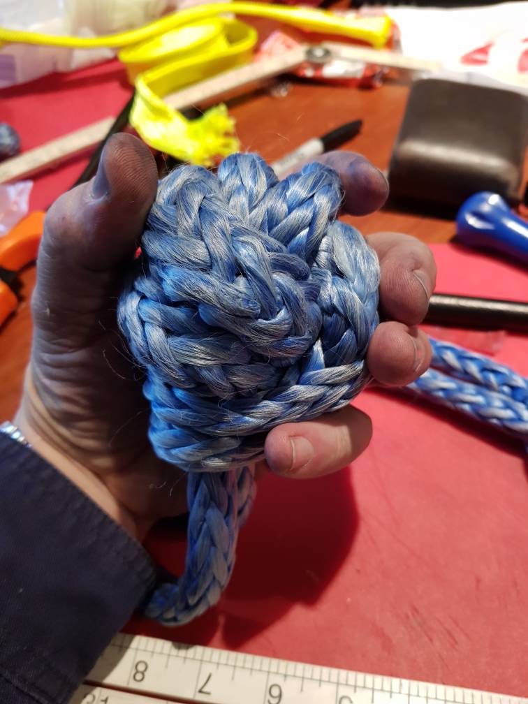

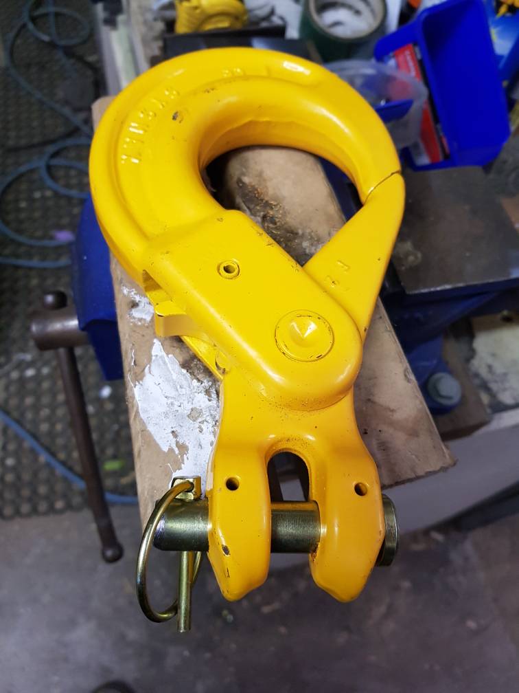

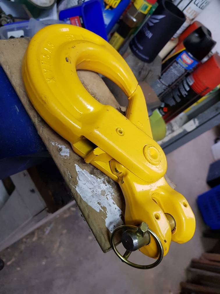

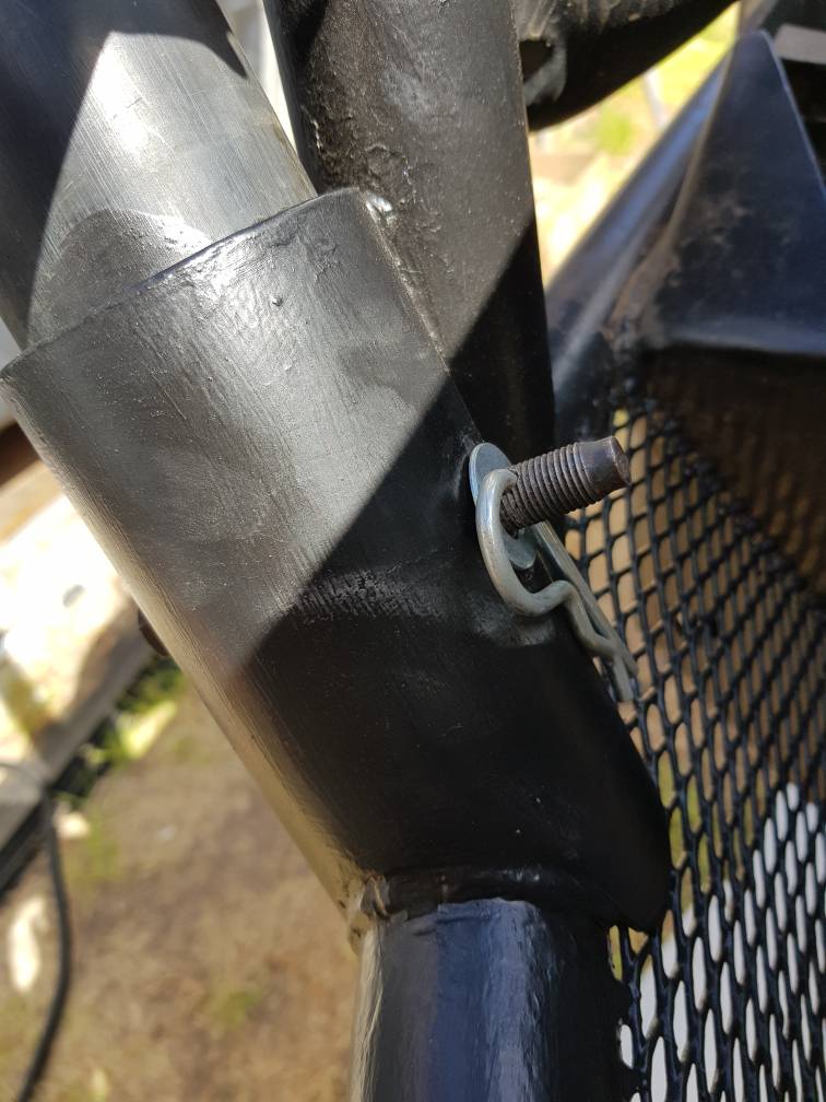

And modded my winch hook to be a quick release for my new 12mm rope
http://www.nissanpatrol.com.au/forum...019/03/328.jpg
http://www.nissanpatrol.com.au/forum...019/03/329.jpg
http://www.nissanpatrol.com.au/forum...019/03/330.jpg

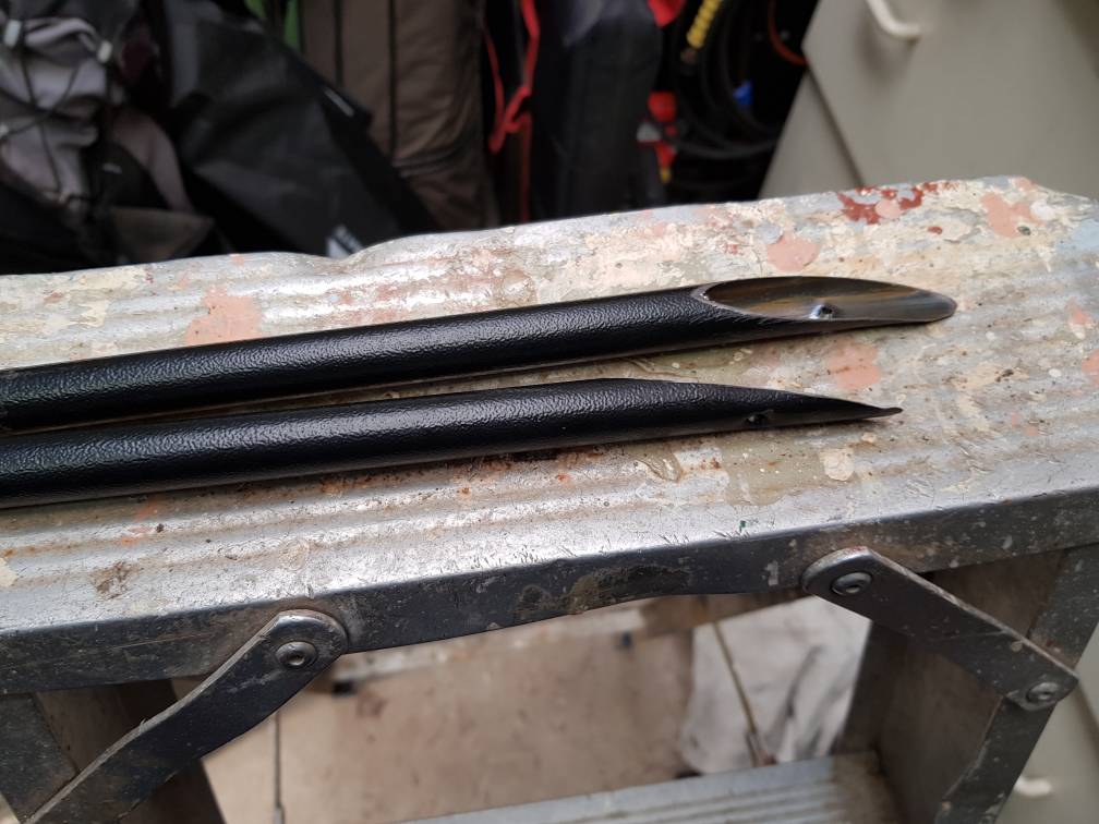

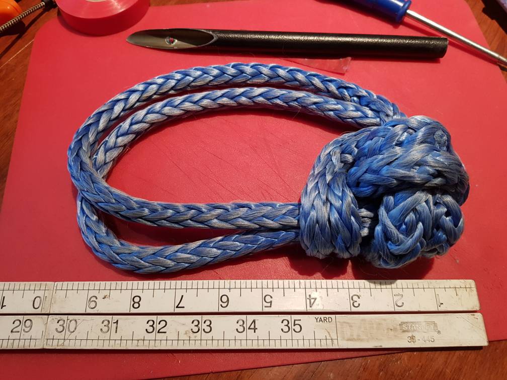

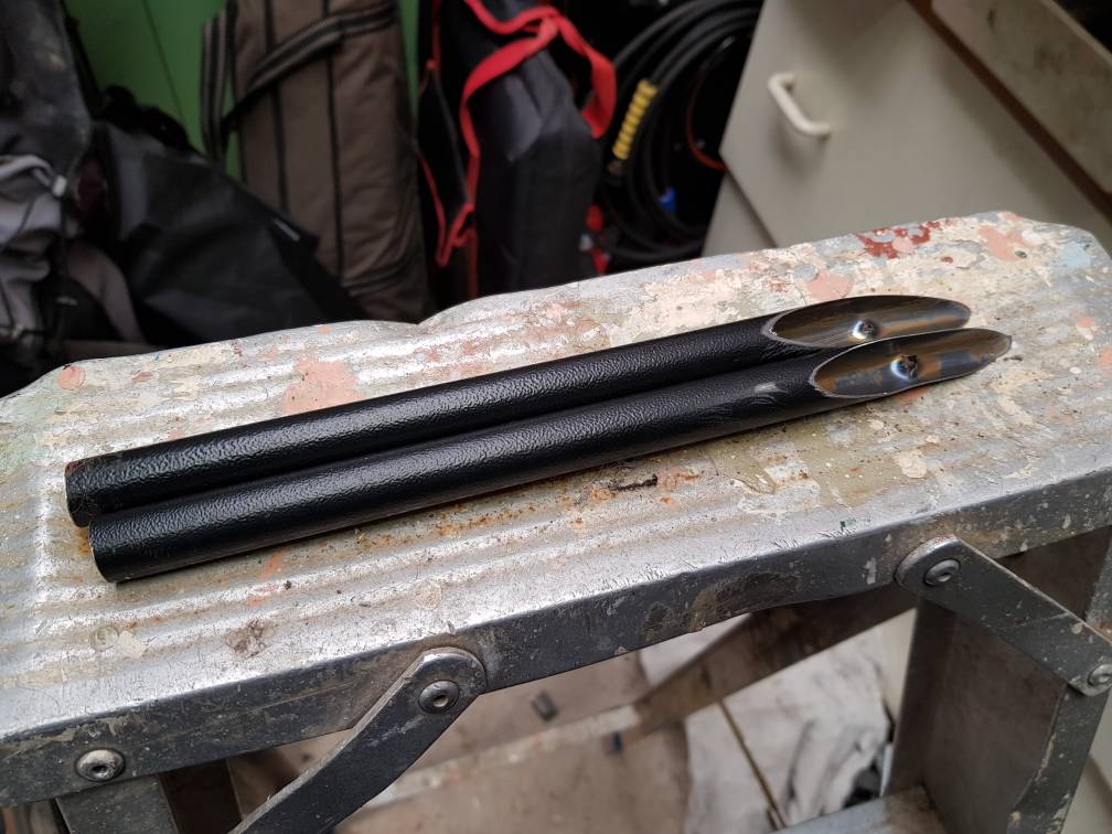

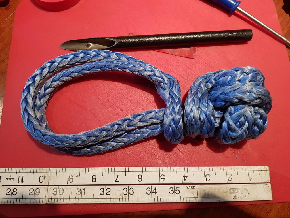

Then made 2 fid in 12mm to use to work with my 12mm rope. Going to make a couple of soft shackles and splice in my loops
