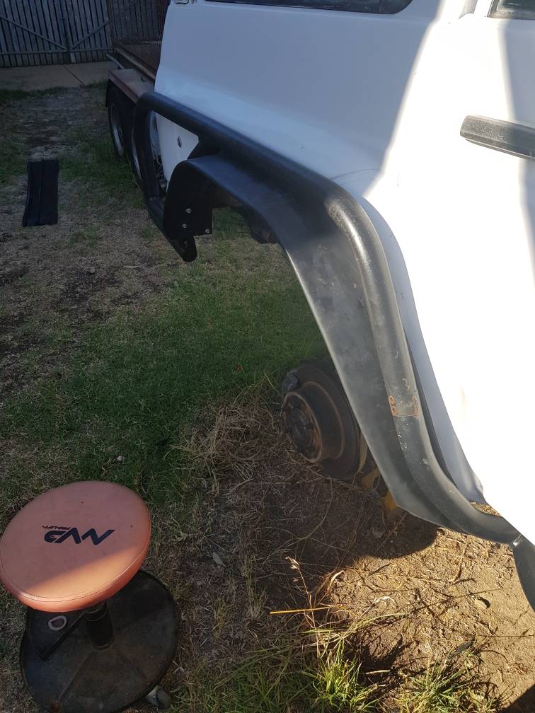

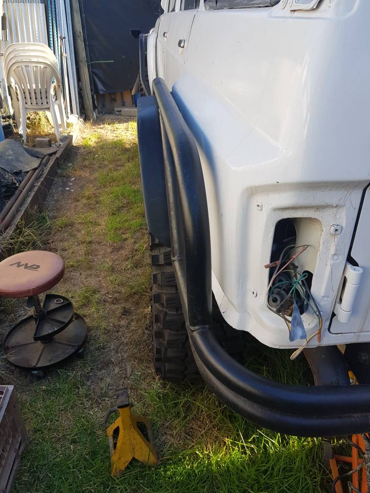

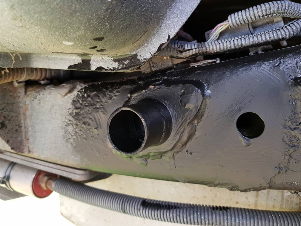

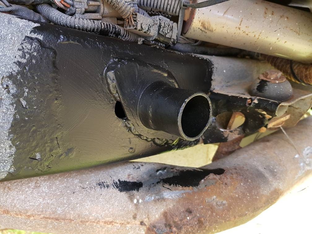

I grabbed these 2 pics today to show what is welded to the chassis.
http://www.nissanpatrol.com.au/forum...2019/02/94.jpg
http://www.nissanpatrol.com.au/forum...2019/02/95.jpg

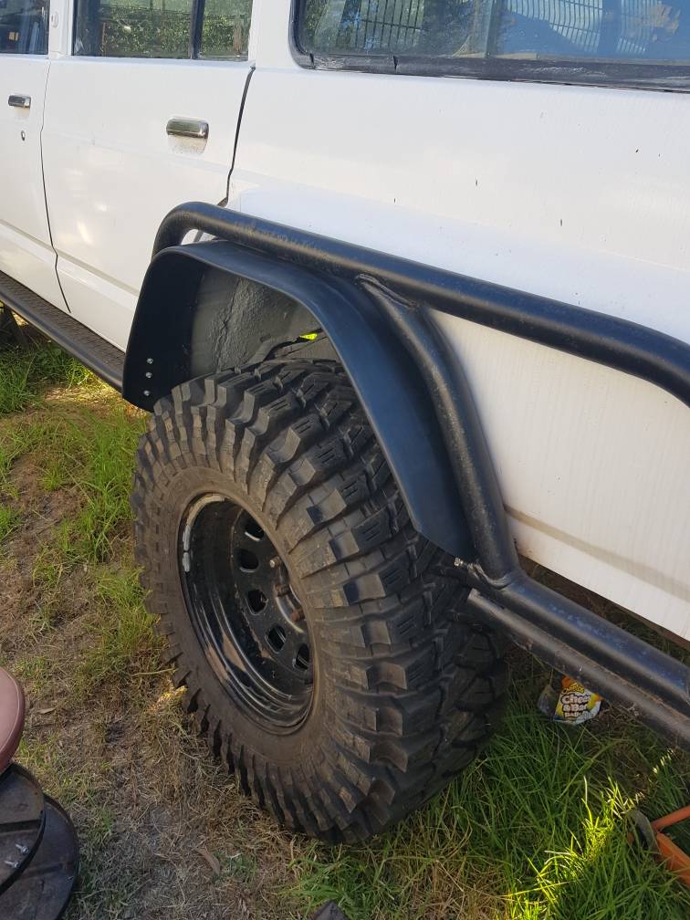

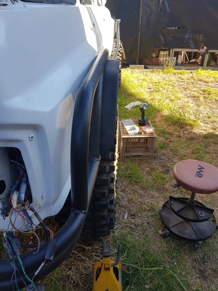

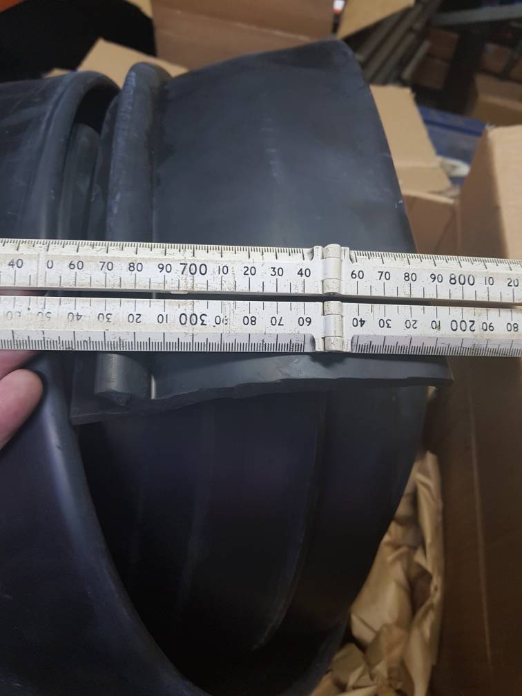

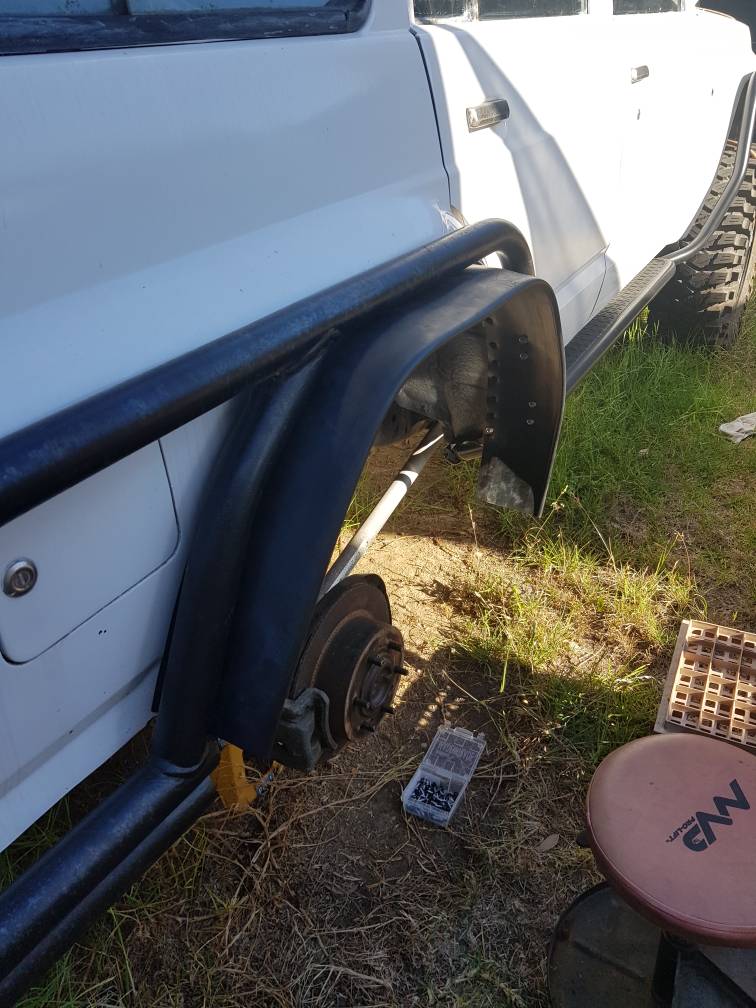

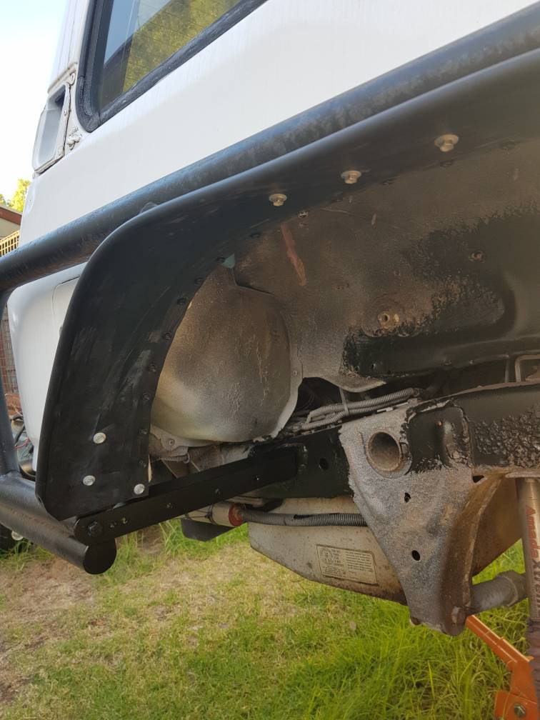

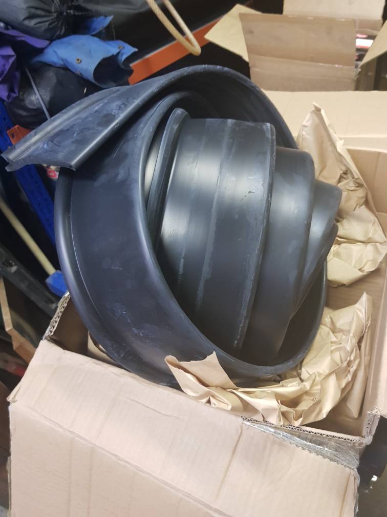

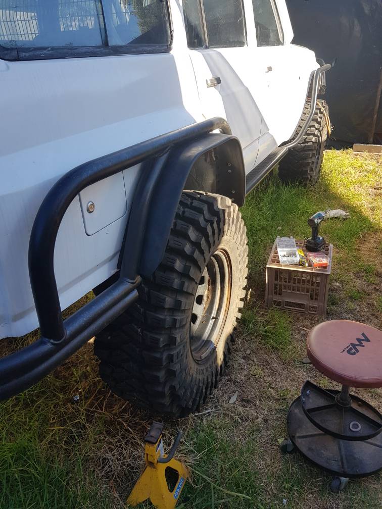

125mm flexiflares. Bring it.
http://www.nissanpatrol.com.au/forum...019/02/135.jpg
http://www.nissanpatrol.com.au/forum...019/02/136.jpg

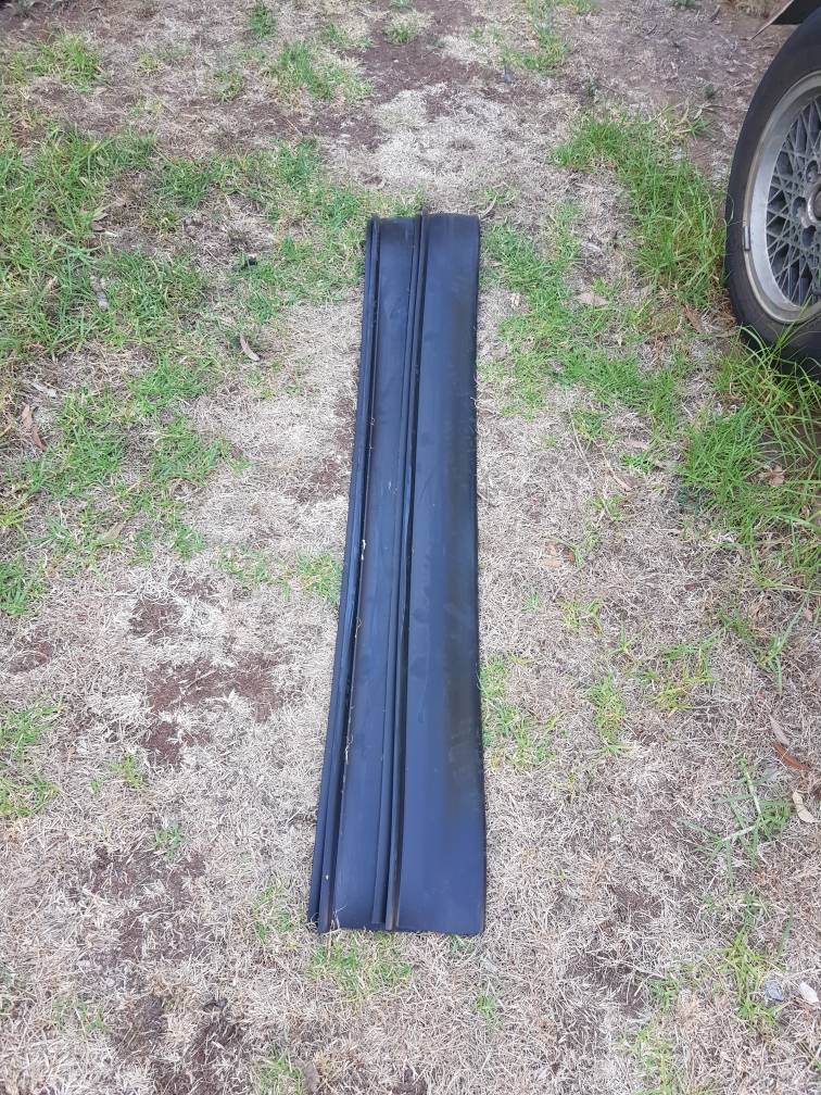

6m i cut into 4 x 1.5m lengths.
http://www.nissanpatrol.com.au/forum...019/02/137.jpg

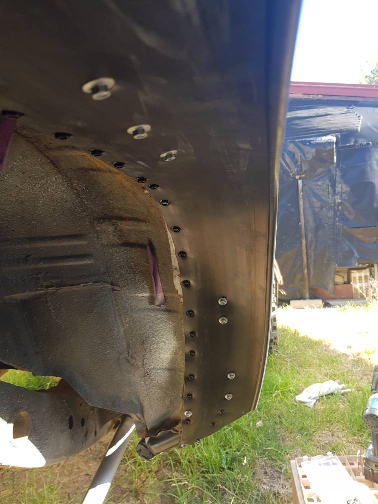

I bought some black 10g tek screws and some 12g teks too. I have down flares a few times ans used teks, nut and bolt, washers. Tek screws for the win. Made for this.
http://www.nissanpatrol.com.au/forum...019/02/138.jpg
10g for the bulk work and the 12g for the anchors. Also 12g into the scrubbys.

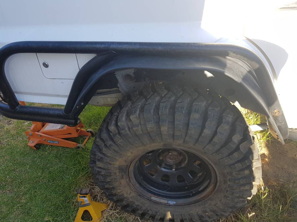

http://www.nissanpatrol.com.au/forum...019/02/139.jpg
http://www.nissanpatrol.com.au/forum...019/02/140.jpg
http://www.nissanpatrol.com.au/forum...019/02/141.jpg

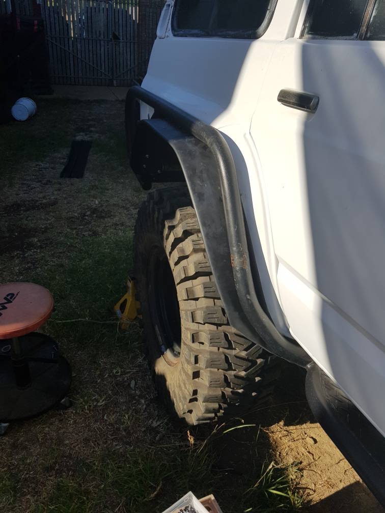

Perfect width!! STOKED!!
http://www.nissanpatrol.com.au/forum...019/02/142.jpg
http://www.nissanpatrol.com.au/forum...019/02/143.jpg
http://www.nissanpatrol.com.au/forum...019/02/144.jpg
http://www.nissanpatrol.com.au/forum...019/02/145.jpg
http://www.nissanpatrol.com.au/forum...019/02/146.jpg
http://www.nissanpatrol.com.au/forum...019/02/147.jpg
I need to finish fit the front bar before i can do the fronts but stoked with the finish.
They’ve turned out really well Darren!

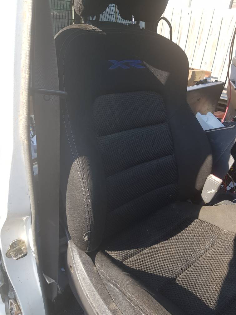

Fitted the XR seat to the drivers side using Hurricane adapters. Unfortunately i found the seat mounts had some stress fractures and also the previous guy had ground down the front pins so i had to drill them out of both seats ans replace with bolts. They were hardened and took some bloody drilling.
Drivers seat in. Passenher seat ready to bolt in but i have more work to the centre console first.

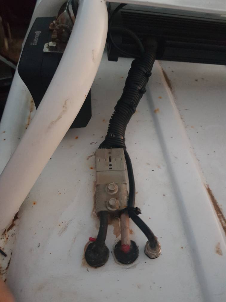

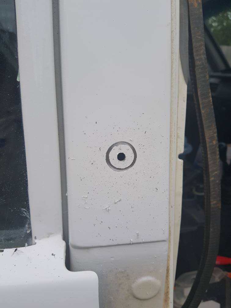

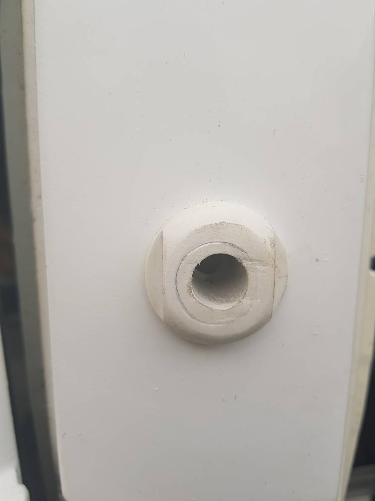

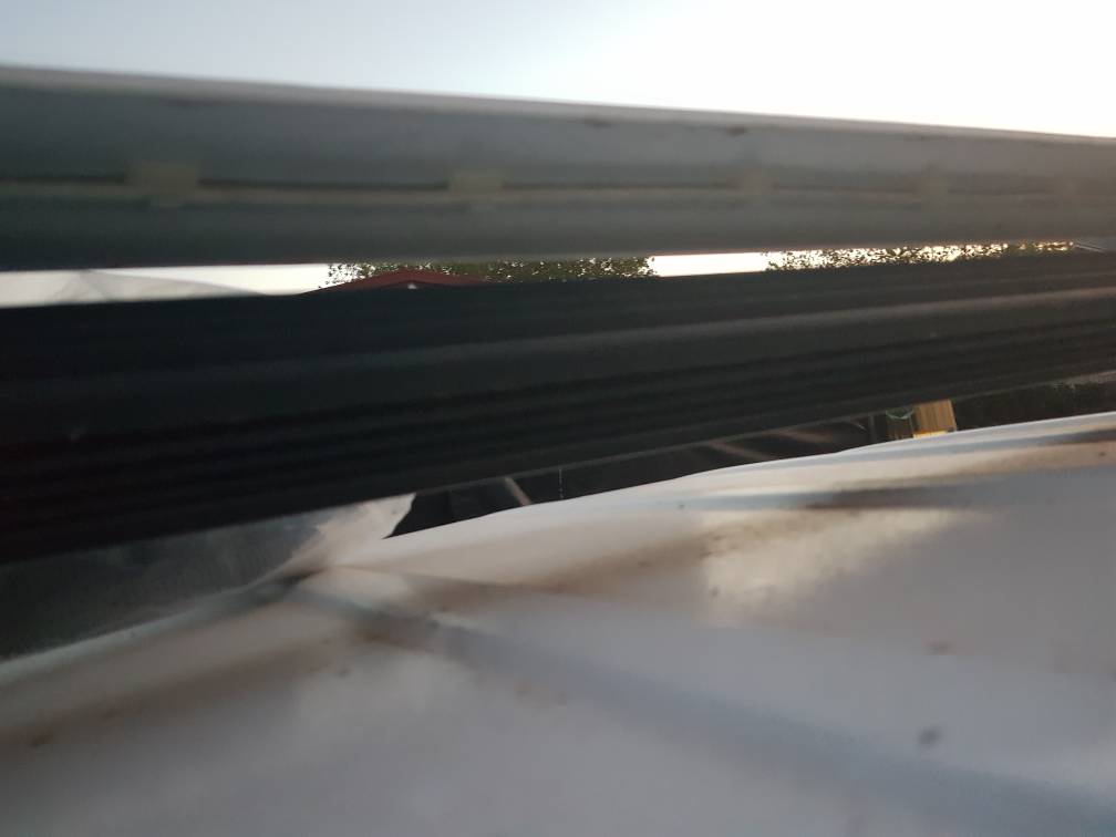

Drilled another penetration through the roof for the side lights and finished that loom. Pretty happy with it.
http://www.nissanpatrol.com.au/forum...019/03/116.jpg
http://www.nissanpatrol.com.au/forum...019/03/117.jpg
http://www.nissanpatrol.com.au/forum...019/03/118.jpg

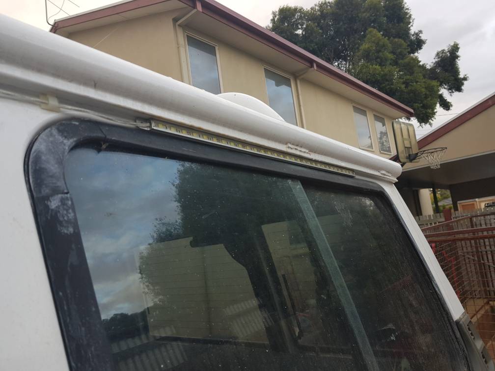

Fitted the rear LED side lights and ran all the wiring.
http://www.nissanpatrol.com.au/forum...019/03/119.jpg

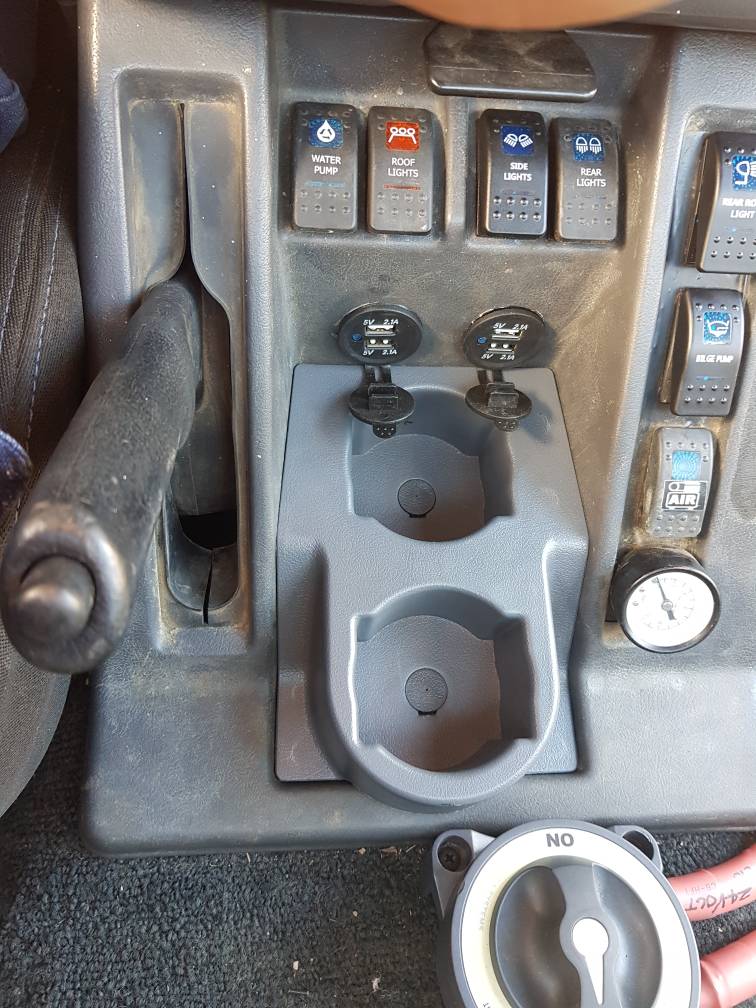

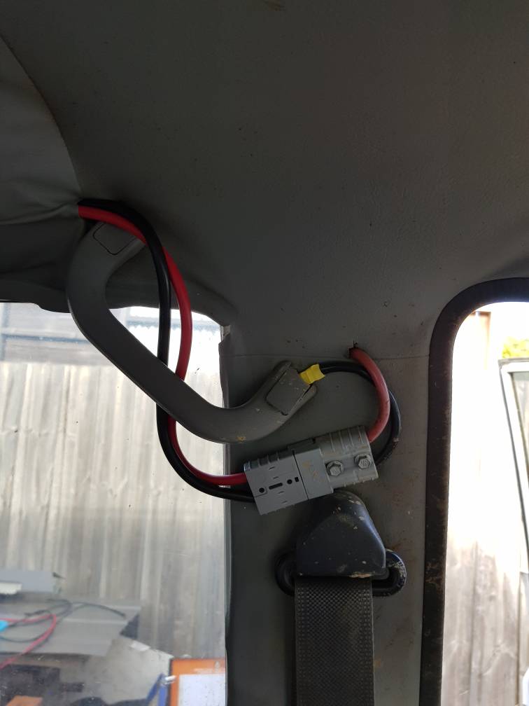

Wired up to a switch i the centre console. Fitted the Anderson Plug from the roof to the B Pillar.
http://www.nissanpatrol.com.au/forum...019/03/120.jpg
Installed the Centre Console.

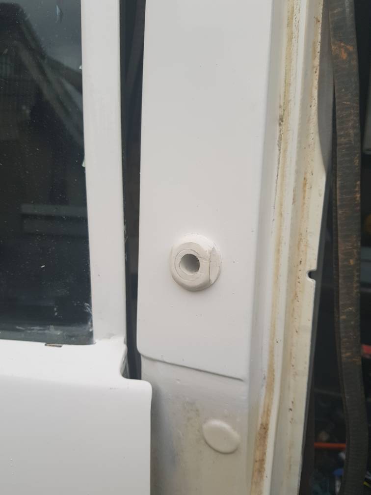

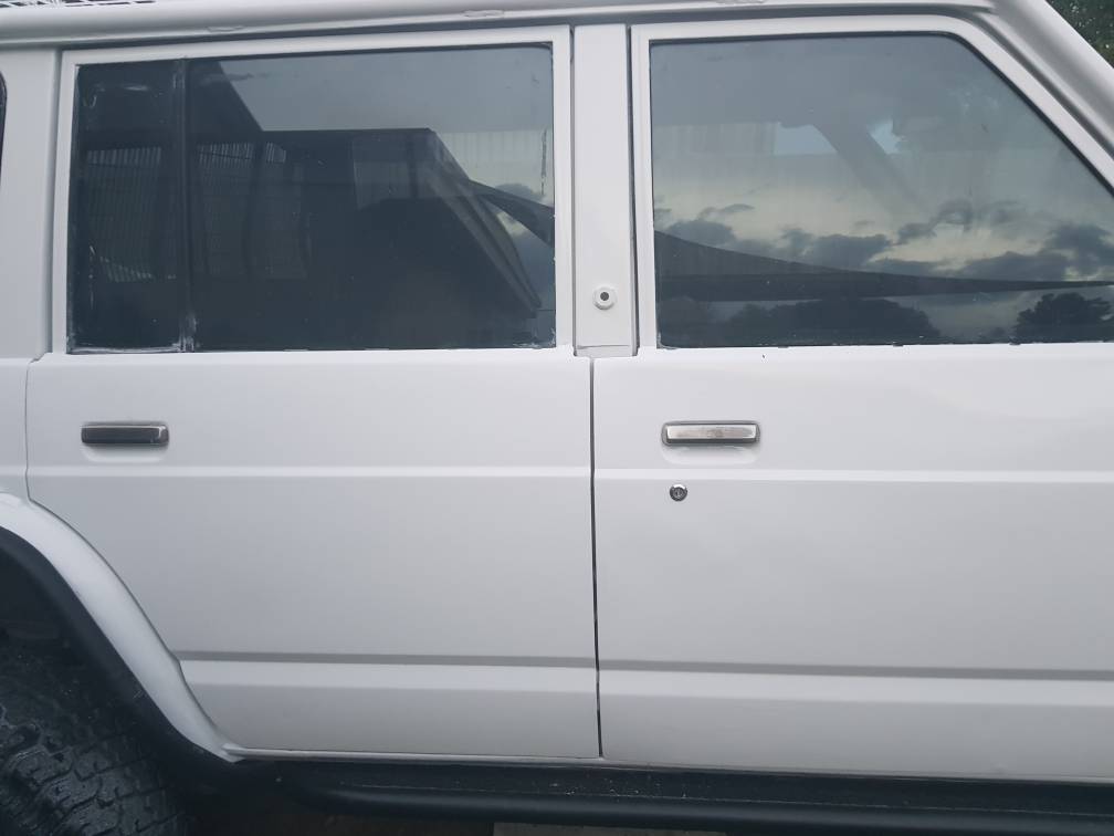

Refitted the door window trims and fitted 1 mirror. The drivers mirror mount has fallen into the door damn it so i have to strip the drivers door inside trim to get to it damn it.

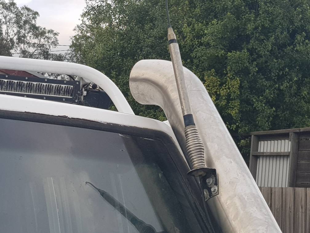

Mounted the UHF Aerial to the snork.
http://www.nissanpatrol.com.au/forum...019/03/122.jpg

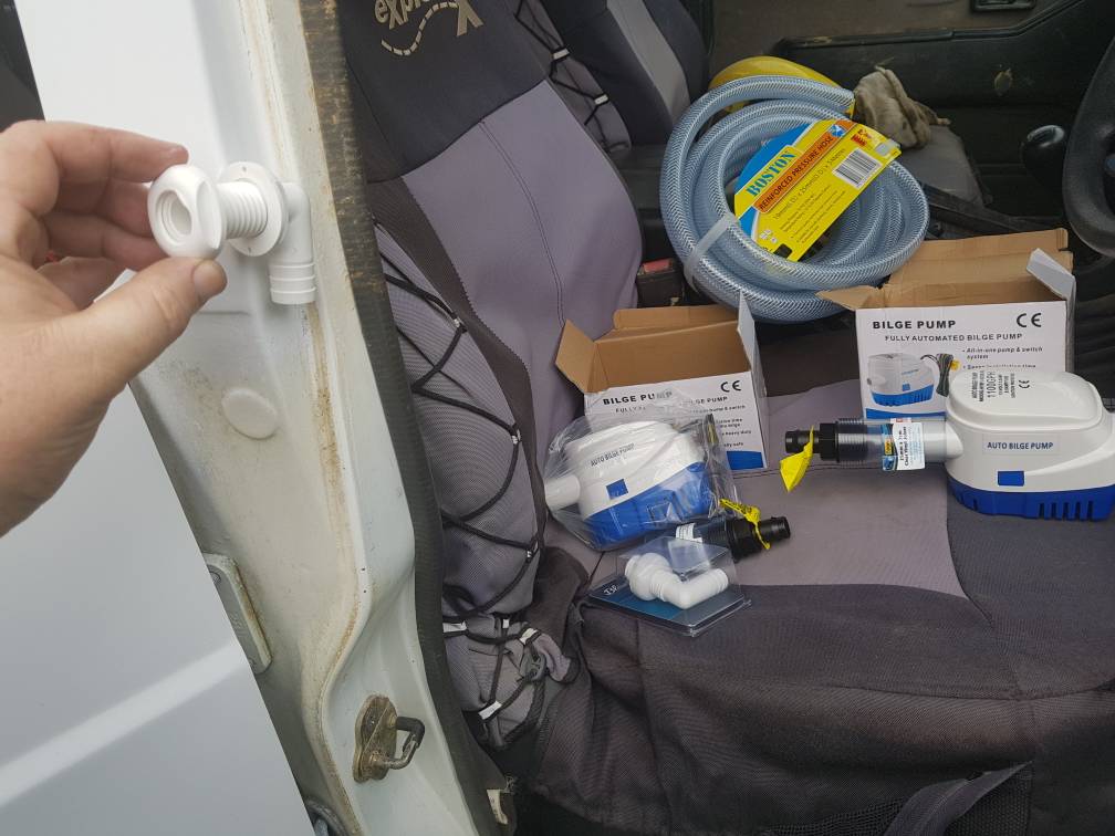

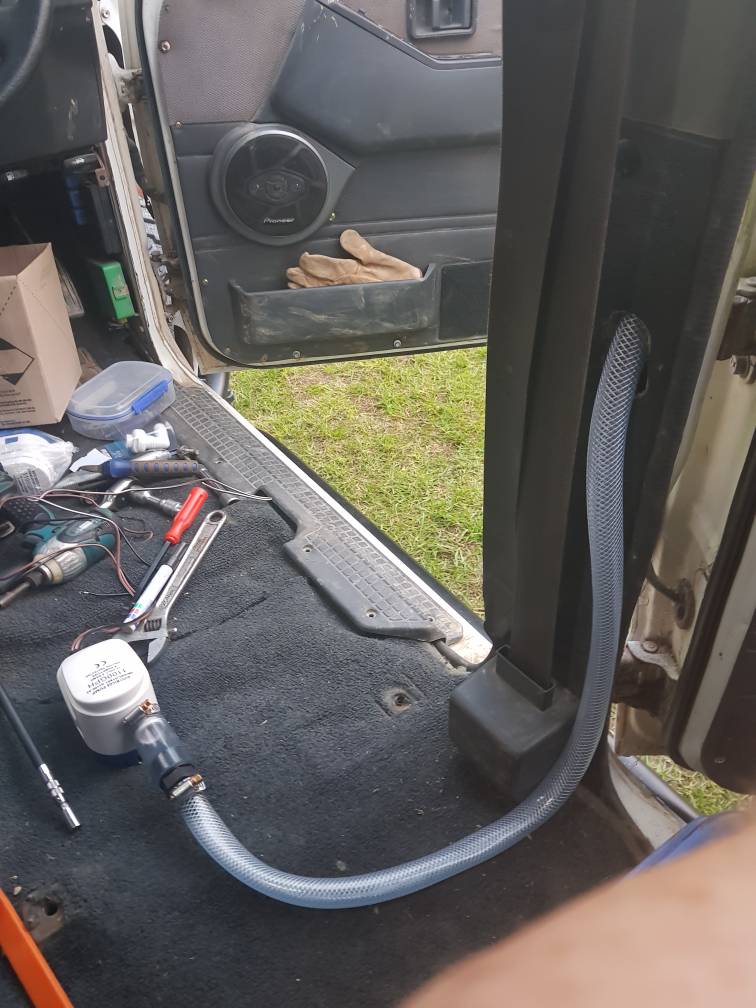

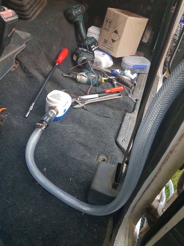

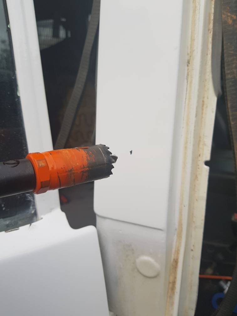

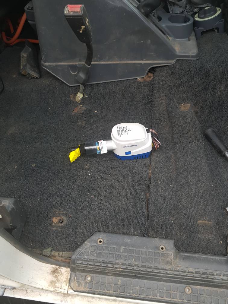

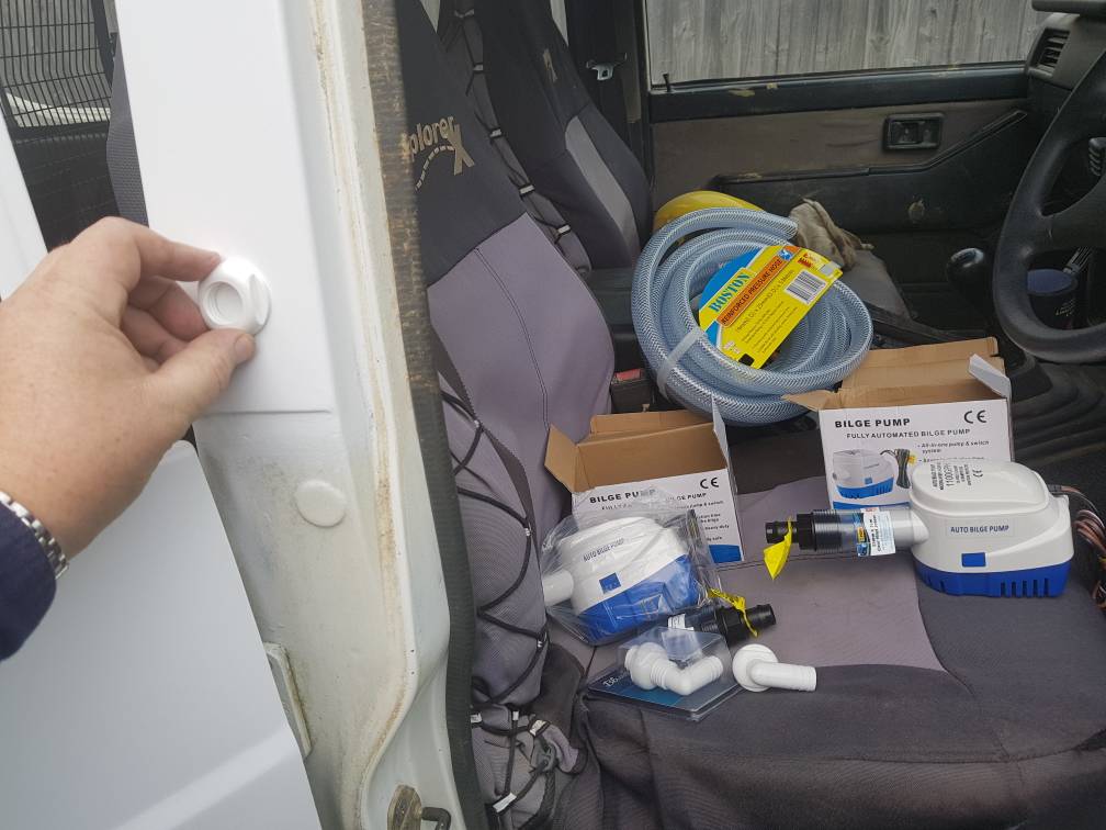

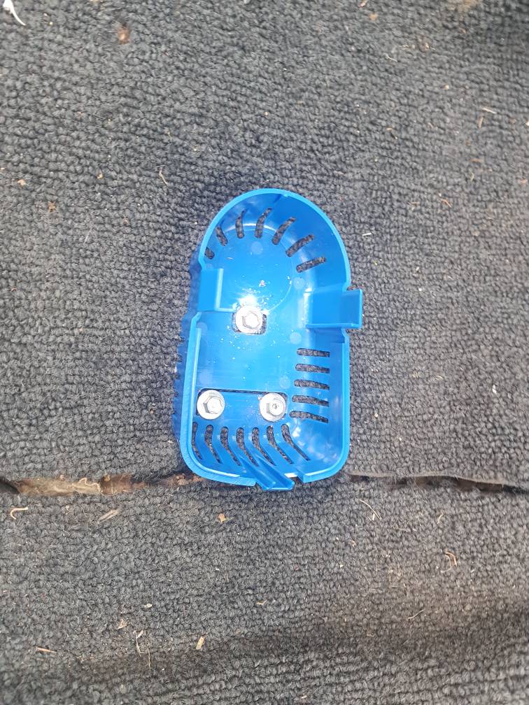

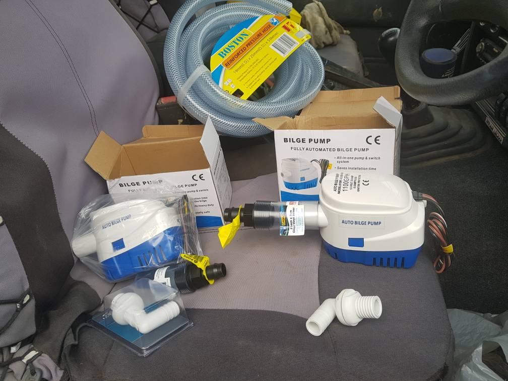

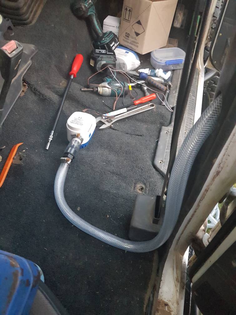

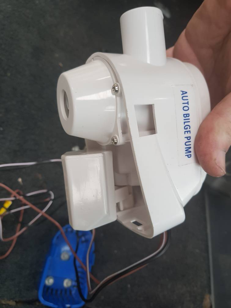

I think its been asked. But whats the bilge pump switch for? Just incase you decide to park in a river?
@mudski i have this on each side.
