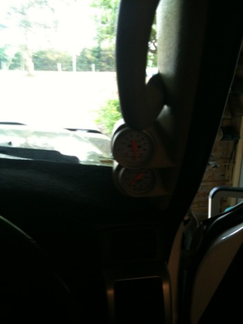

your a legend mate.
All your help has been awesome :)
cheers
http://www.nissanpatrol.com.au/forum...2011/11/12.jpg
