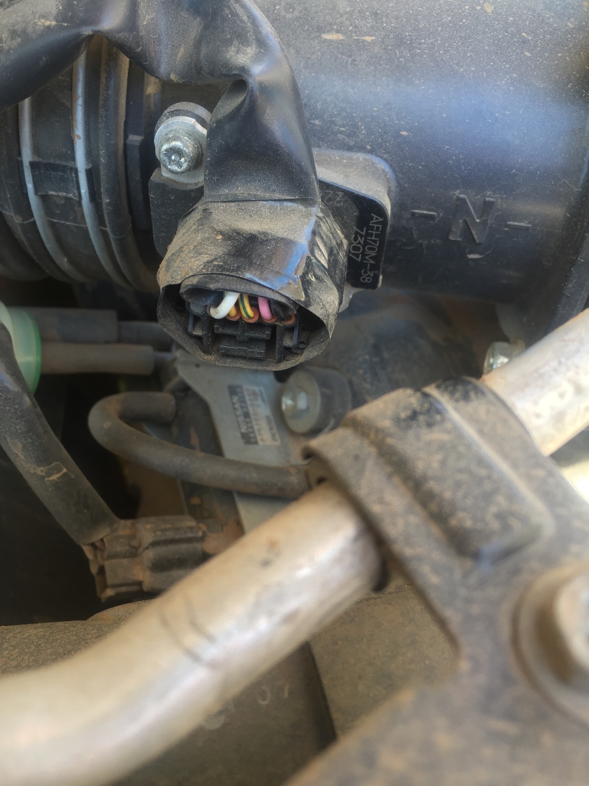

Pulled out to see location in engine bay

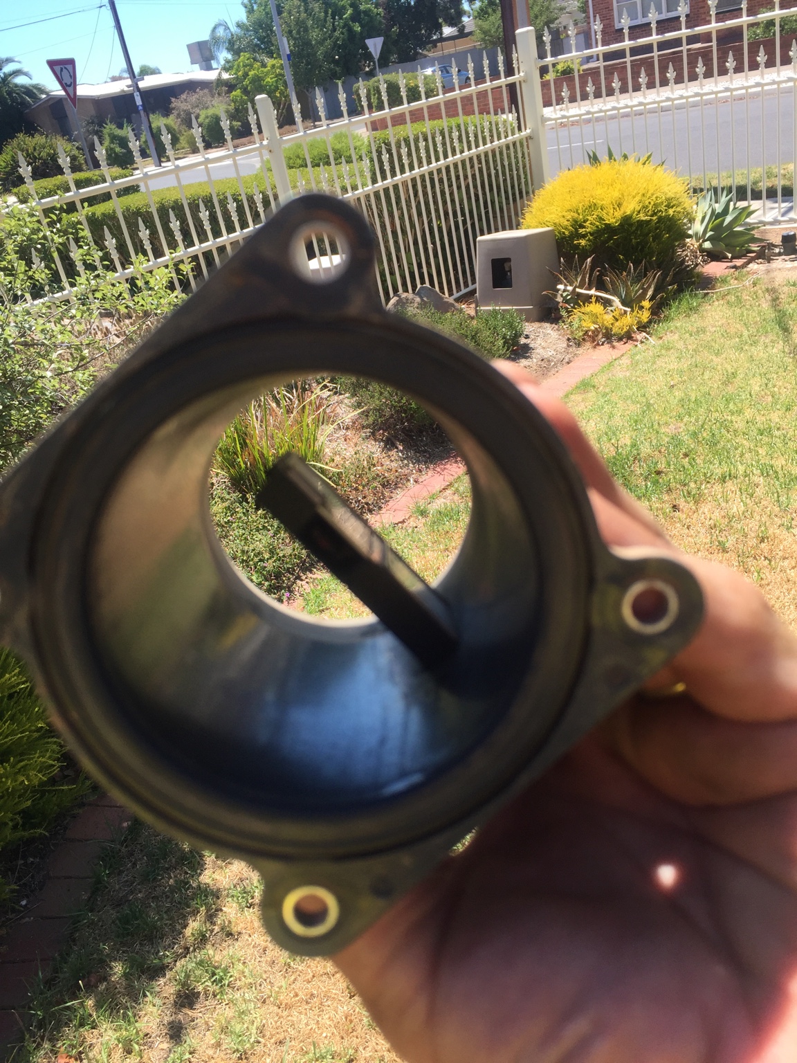

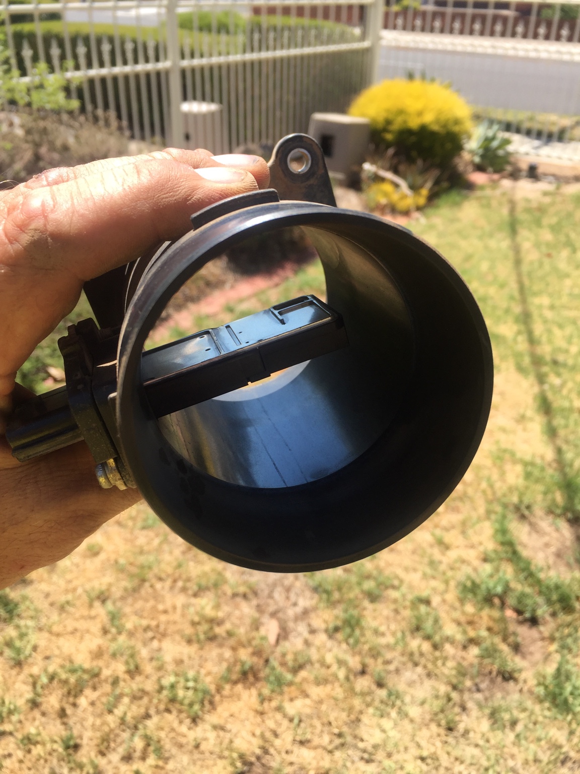

Well cleaned my MAF this arvo. I remembered that the screws on the MAF are weird they're a torx but have a lump in the middle making using a torx bit impossiblehttp://www.nissanpatrol.com.au/forum...015/12/218.jpg
So pulled everything around it apart and got it like this
http://www.nissanpatrol.com.au/forum...015/12/219.jpghttp://www.nissanpatrol.com.au/forum...015/12/220.jpg
Sprayed the hell outta it over a nice pink blouse, and was surprised how little shit came from it.

I've posted elsewhere if I need to reset the scangauge at all after having the battery unplugged for 2 hours. But this mornings drive to work the scangauge fuel consumption has dropped by easy 20%. If it's reading accurate how farkin good is that maf cleaner spray!!!
