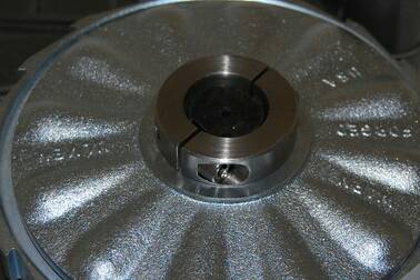

My mate has tried drilling my brake shaft but he can't drill into it... Think we will just weld a nut onto it.

Yeah the brake shaft is pretty hard to drill & tap. Think you need to aneal it to get a tap in. Reckon making a cap like Dazz an ABs is a good way too go. . .
Yep but my mate just showed me this... He's thinking of making a run of them and selling on eBay. No modification required!! http://www.nissanpatrol.com.au/forum...015/08/176.jpg
Yeah ghee I like his cap make e, that has got some potential. What did he turn it up out of? As long as it can't shear off the lip and pop off its a winner.
that is a pic we found online but I believe it's stainless. Very nice indeed hey! Mate reckons he could make them for about 15 and sell for around 50
It would also clamp tight onto the shaft so it wouldn't be going anywhere. Bloody great idea.
